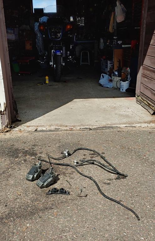

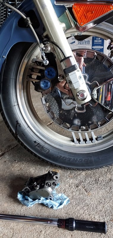

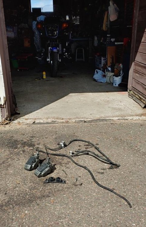

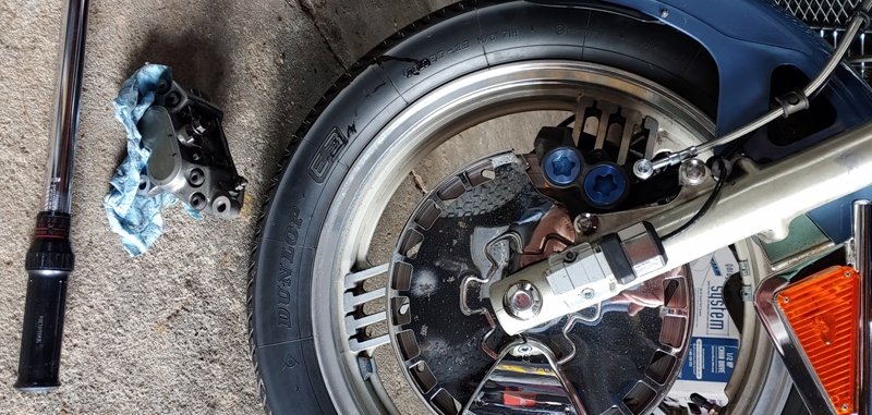

Karaboo Posted May 15, 2019 #1 Posted May 15, 2019 Thanks to Skydoc_17 I have the best brakes in the whole fargin' world! His de-linking kit and instructions are awesome. Out with the old. In with the new. The color match is pretty good. First ride was great. I could have been riding on Sunday, but the fronts took a little extra time to bleed. Even with a broken back, Earl delivers the goods. More good thoughts heading your way.
