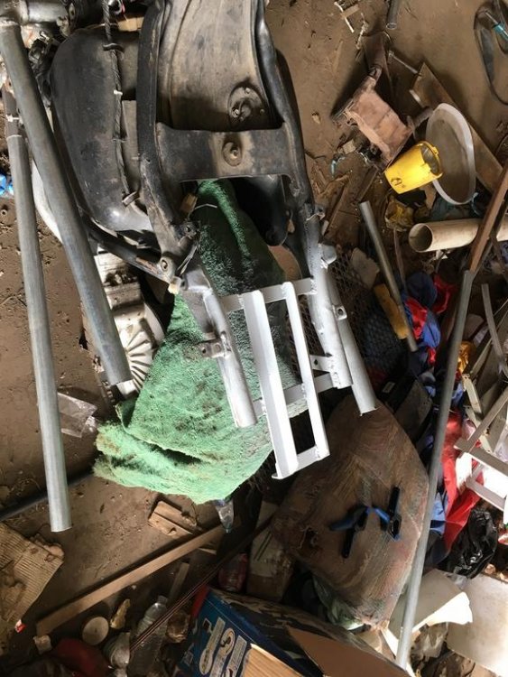

Harddrv1 Posted August 17, 2019 Author #36 Posted August 17, 2019 (edited) Just an update/teaser haven’t posted in a while but I have begun the next phase exhaust has been rerouted and welded I have purchased a new seat (not a fan I’ll probably end up replacing it) modified the rear end and added an new rear fender ( or working on it), I have also replaced my clutch reservoir. And dammit pics won’t upload lol to be continued... hmm tried from pc says my files are too big took photos with phone guess I’ll try again tomorrow maybe after I get the fender/rear lights mounted and exhaust finished. Canadian tire ran out of reducers and I need a chunk of 2”, guess we’ll see what tomorrow brings. Good night guys if anyone’s still following this lol. Edited August 18, 2019 by Harddrv1 Update
cowpuc Posted August 19, 2019 #37 Posted August 19, 2019 Harddrv1 said: Just an update/teaser haven’t posted in a while but I have begun the next phase exhaust has been rerouted and welded I have purchased a new seat (not a fan I’ll probably end up replacing it) modified the rear end and added an new rear fender ( or working on it), I have also replaced my clutch reservoir. And dammit pics won’t upload lol to be continued... hmm tried from pc says my files are too big took photos with phone guess I’ll try again tomorrow maybe after I get the fender/rear lights mounted and exhaust finished. Canadian tire ran out of reducers and I need a chunk of 2”, guess we’ll see what tomorrow brings. Good night guys if anyone’s still following this lol. Yip,, still following! I use "Paint" to resize my pics for club pics.. Just resize to 1000 pix's max and resave. Never an issue with them once thats done... Keep up the good work Hardy!! Fun project and enjoying your adVenture!! Puc
Harddrv1 Posted August 19, 2019 Author #38 Posted August 19, 2019 Nice Thanks alot Puc hope this does it

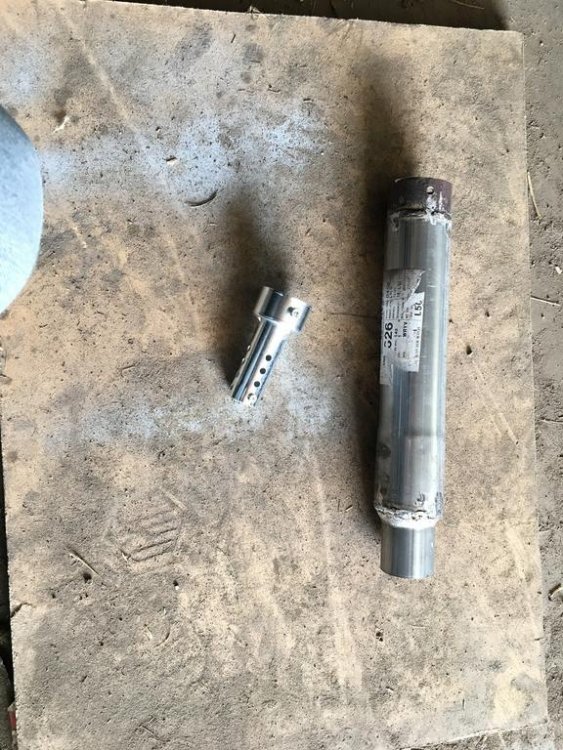

Harddrv1 Posted August 19, 2019 Author #39 Posted August 19, 2019 lol a bit out of order now but it worked Heres rear fender and lights mounted test fit of seat I think the rear fender is still a bit high not sure what im going to do to fix this yet frame for rear fender and lights welded up Primed my replacement clutch reservoir rear end painted Diy muffler with cheapy ebay baffle (not tested yet) exhaust welded and welds painted to try and prevent corrosion (I have some wrap I hope to wrap exhaust tomorrow if i have time after work) also you may notice my supreme red-necking lol I ended up using plumbing fittings to get the angles I wanted various other test fits etc PS as always don't mind my shop I'm a slob I know also I do plan on capping the frame where I cut it off just haven't got to it yet

Harddrv1 Posted August 27, 2019 Author #48 Posted August 27, 2019 Got a bit more done on bike today no time for sizing photos but not much to see anyway, finished welding exhaust, wrapped the exhaust (I ended up using boiler/tubing wrap from work as the exhaust wrap I ordered wasn’t near enough to do the bike). The draw back is it’s white I’m hoping painting it will work? So seems new exhaust and air box work fine had the bike running to dry the wrap, backfires a bit but it did with the old exhaust ass well. Still gotta redo some wiring for the tail lights and a few other minor wiring jobs, still have to remount the battery hopefully get that this week gotta remount ignition also because it was in the way of the new air box. Think of a way to tidy up the front end a bit. A lot to do but I think it’s coming together not to bad. I also still don’t much care for how the rear fender looks so may fix that up a bit
Harddrv1 Posted August 28, 2019 Author #49 Posted August 28, 2019 (edited) Like I said not too much to see but here is a pic of yesterdays progress Probably not gonna get anything done tonight but figured id post Its a bit of a mess but sounds ok also I ran out of wrap so 1 pipe is still pretty bad looking lol Edited August 28, 2019 by Harddrv1
