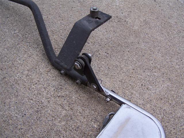

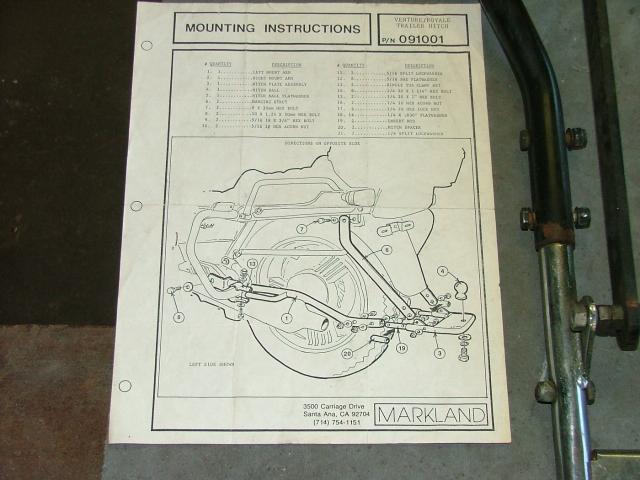

Jayceesfolly Posted April 20, 2019 Posted April 20, 2019 Here is a pic of the MK1 setup. The main difference between the MK1 and the MK2 is the clamp on the bag crash bar is not used on the MK2, there is a bolt that goes thru the bottom of the bag., as Jeff mentioned. I have set of mounting bars that I can ship you if you would like them. There is a slight bend in one bar due to a tipover a few years ago on my bike but it is not noticeable. It is easily straightened. I only have the two long mounting bars and none of the other pieces. PM me and I will send them to you, as they are looking for a new home. Will post pic on Monday as soon as I am home. I have part #1 but fits the MK2.
Flyinfool Posted April 21, 2019 Posted April 21, 2019 Here is a pic of the MK1 setup. The main difference between the MK1 and the MK2 is the clamp on the bag crash bar is not used on the MK2, there is a bolt that goes thru the bottom of the bag., as Jeff mentioned. I have set of mounting bars that I can ship you if you would like them. There is a slight bend in one bar due to a tipover a few years ago on my bike but it is not noticeable. It is easily straightened. I only have the two long mounting bars and none of the other pieces. PM me and I will send them to you, as they are looking for a new home. Will post pic on Monday as soon as I am home. I have part #1 but fits the MK2. And I have part #3 and maybe parts #19 . The rest of the parts are some very simple to fab brackets that can be made from a chunk of 1" wide x 1/8" thick steel bar from the hardware store.

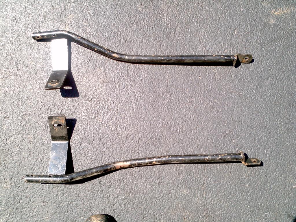

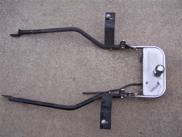

Jayceesfolly Posted April 23, 2019 Posted April 23, 2019 Here are the bars I mentioned in the above thread. I packaged them up today and will ship tomorrow. You will need to paint them as they have been kicking around in my garage for awhile. Jim

Flyinfool Posted April 30, 2019 Posted April 30, 2019 It should clean up nice. Those 2 tabs on the top of the hitch are where you need to fab a bracket and clamp that will go over the frame that is right above it. The bracket is only 2 or 3 inches long. I made the clamps and the brackets out of 1" x 1/8" galvanized from the hardware store. If you are not sure what else is needed for mounting just ask.
Argo Posted May 1, 2019 Author Posted May 1, 2019 It should clean up nice. Those 2 tabs on the top of the hitch are where you need to fab a bracket and clamp that will go over the frame that is right above it. The bracket is only 2 or 3 inches long. I made the clamps and the brackets out of 1" x 1/8" galvanized from the hardware store. If you are not sure what else is needed for mounting just ask. Jeff, If I understand correctly, on a 1st Gen MK2, the bracket from the hitch plate doesn't go all the way up to a mounting point on the rear sub-frame as shown in the diagram in post #3 above. Does the bracket attach (clamp) to the lower bars that connect the left and right crash bars that surround the saddle bags? Wouldn't happen to have a picture or diagram of this? Thanks, Argo
Flyinfool Posted May 1, 2019 Posted May 1, 2019 The diagram in post #3 is for a 1st gen MK I. The mounting is completely different for a MK II. If you look under the fender of your bike you will see 2 bars that run for / aft. these are the bars that the tabs of the hitch will connect to. I no longer have my bike so I can not take a pic of the setup.

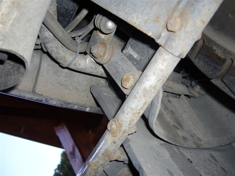

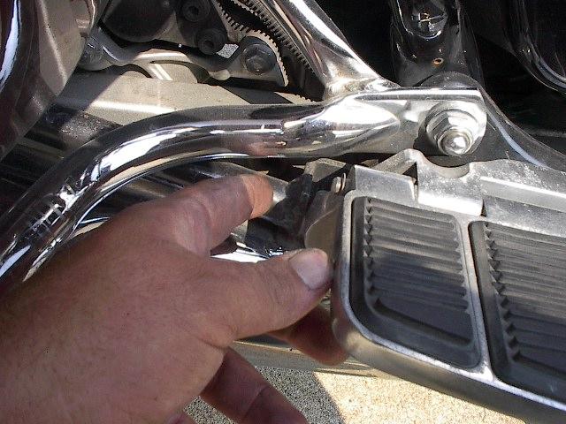

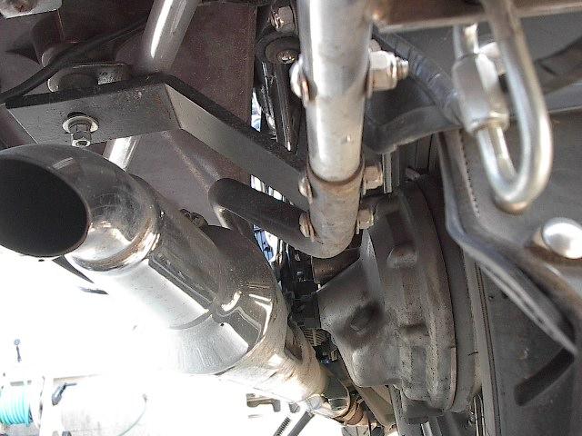

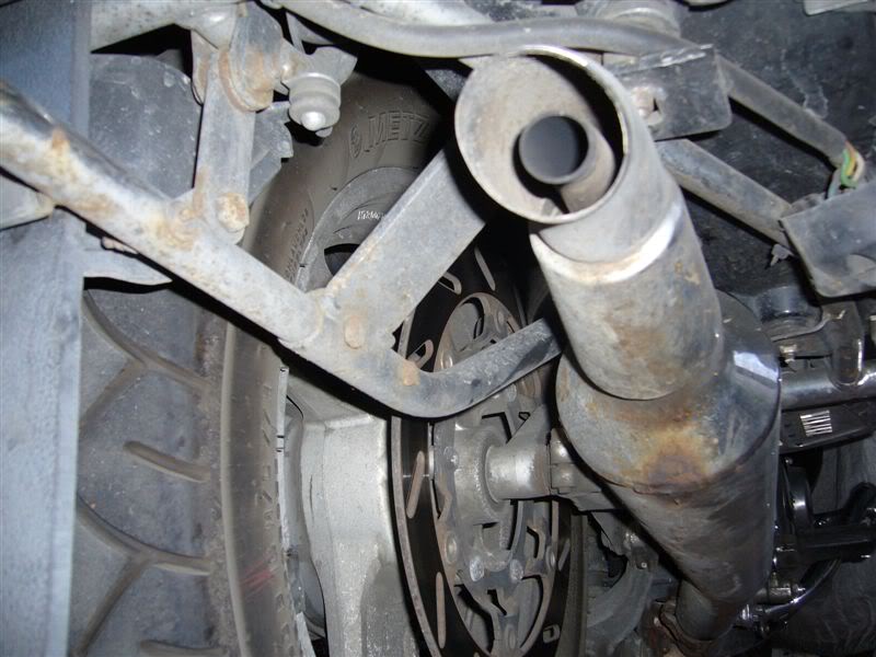

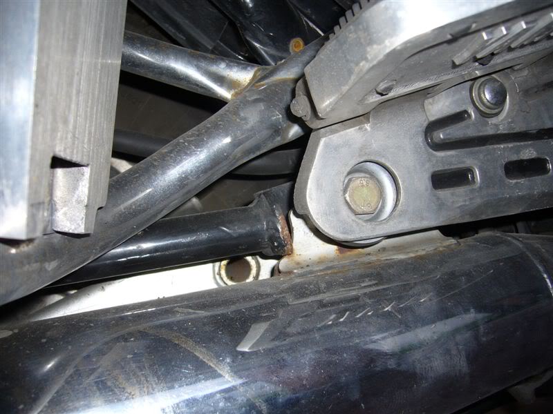

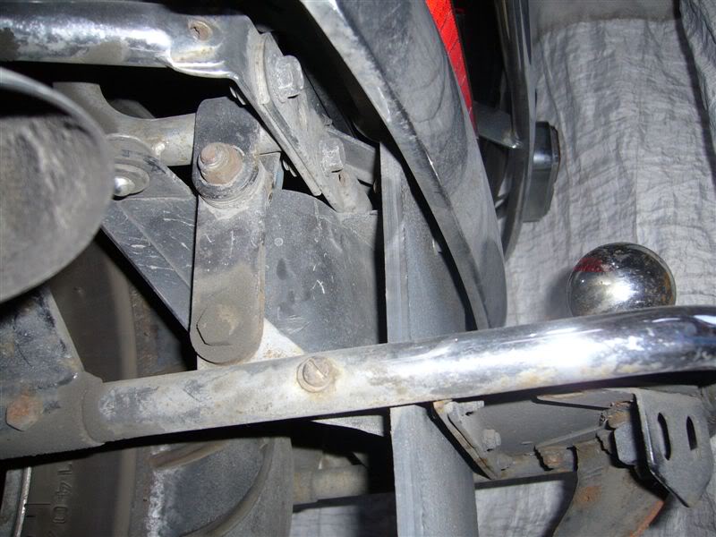

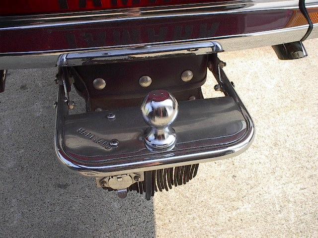

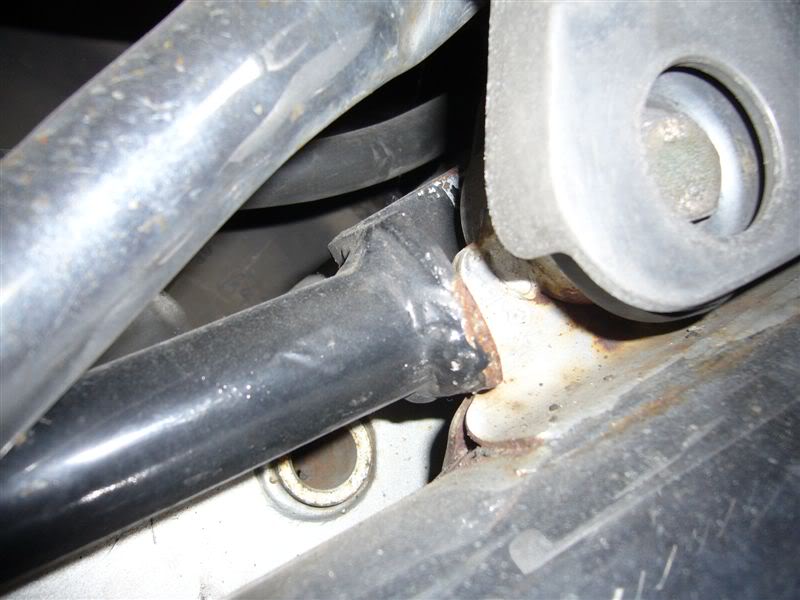

Prairiehammer Posted May 3, 2019 Posted May 3, 2019 Jeff, If I understand correctly, on a 1st Gen MK2, the bracket from the hitch plate doesn't go all the way up to a mounting point on the rear sub-frame as shown in the diagram in post #3 above. Does the bracket attach (clamp) to the lower bars that connect the left and right crash bars that surround the saddle bags? Wouldn't happen to have a picture or diagram of this? Thanks, Argo Markland hitch on a MKII:

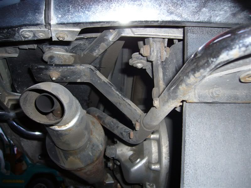

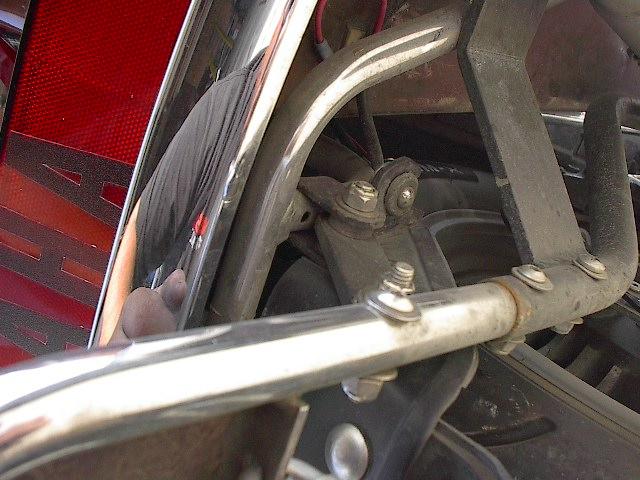

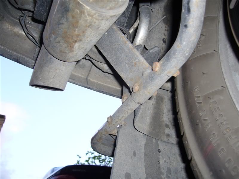

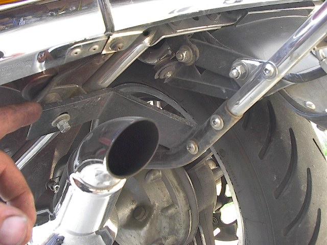

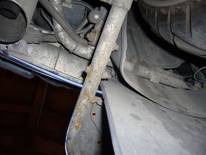

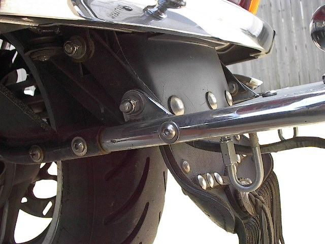

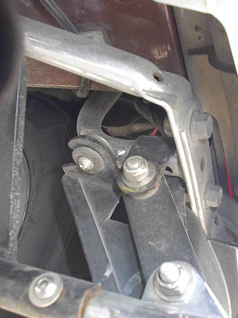

Prairiehammer Posted May 3, 2019 Posted May 3, 2019 Jeff, If I understand correctly, on a 1st Gen MK2, the bracket from the hitch plate doesn't go all the way up to a mounting point on the rear sub-frame as shown in the diagram in post #3 above. Does the bracket attach (clamp) to the lower bars that connect the left and right crash bars that surround the saddle bags? Wouldn't happen to have a picture or diagram of this? Thanks, Argo Markland Hitch on a MKII more:
Argo Posted May 3, 2019 Author Posted May 3, 2019 Prairiehammer, Thanks for those pictures they really help. It may be the camera angle or an optical illusion, but the short bracket from the hitch plate to the lower, rear cross bars on the bag guard seem to be vertical in some pictures and angled forward in others. I am pretty certain that these are from at least two different bikes. Would you know the reason for the different angle to the brackets? Thanks, Argo
Prairiehammer Posted May 3, 2019 Posted May 3, 2019 Prairiehammer, Thanks for those pictures they really help. It may be the camera angle or an optical illusion, but the short bracket from the hitch plate to the lower, rear cross bars on the bag guard seem to be vertical in some pictures and angled forward in others. I am pretty certain that these are from at least two different bikes. Would you know the reason for the different angle to the brackets? Thanks, Argo The pictures are from a collection of hitch mounting pictures I have. There are at least two different bikes shown. But on both of the bikes I've had a Markland hitch on (1990 and 1991), the vertical bar running from the ear on the ball hitch plate to the U-strap mounted on the saddle bag/crash bar frame has been angled. Maybe just manufacturing tolerance or minor changes Markland made over the years? I don't think it will matter.
