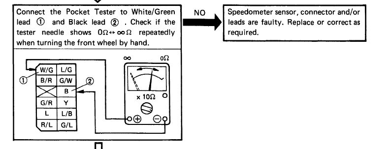

Bob K. Posted June 17, 2019 Author #6 Posted June 17, 2019 (edited) Great ideas, Patch. The vacuum hose and vacuum actuator work well and are in fine shape. I can pull a manual vacuum on them and it'll hold indefinitely. The actuator cables are adjusted well and the slightest vacuum will actuate the throttle linkage and begin turning the throttle grip. Excellent idea to spin the speedometer cable with a drill. I'm going to go try that right now. What speed sensor test are you referring to? I'm aware of this one but it's in the Venture cruise troubleshooting procedure, not on pages 7-166 & 167 in my book. I don't see speed sensor tests or speedometer cable tests anywhere else in the book. My speedometer needle was slightly wobbly before I performed maintenance. Last year I disassembled, cleaned, and greased the front wheel speedometer mechanism & the speedometer cable. The speedometer needle on the gauge now runs very smoothly and linearly. Has anyone else ever driven the speedometer cable with a drill? I was surprised...it makes a noticeable noise in the cluster. Not the common 'moan' or squeal from a lack of lubrication but rather just a rotational vibrating sound. Edited June 17, 2019 by Bob K.
Patch Posted June 17, 2019 #7 Posted June 17, 2019 The pages are correct as to my service manual, a paper back one. Yes as to your screen shot but there is one above in mine as well as more on the next page 7-167. The reason for the drill is to simulate the sensor at high speeds. Yes I have done this, and may have as well on an 86 I can't say for certain but I can tell you it takes 4 hands to accomplish. The trick really is to keep the cable from moving down and out of the speed; some a e-clip that holds the cable some down't. Now I do remember that I have parts of a 86 cluster and I did need to scavenge some parts off the second unit to rebuild the tach and speedo, pain in the... job. I did find that the speedo was load but at the end of the effort all said and done the clicking noise was no longer notable. Because you mentioned it works fine at 59 mph, suggests that the overall unit meets functional expectation but it fails at 60 plus,,, so in my mind that is where you should concentrate your efforts. When I am tracking down such problems I step back and consider the complete unit in operation, break it down into components, then check each one checking it off the list, very much like you did in the OP. This is what would be running thru my mind in your position, it is a resistance problem, what is causing it, magnetic field or mechanical?! Again the bike at 59 will experience the same bumps as it will at 60 mph. I'm around today if you need more feed back

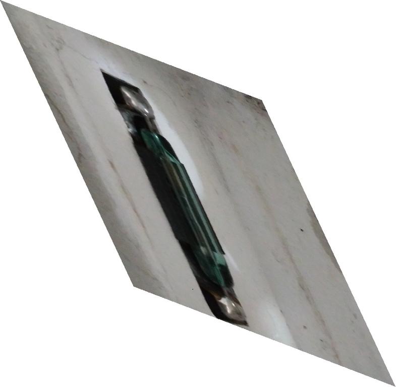

Patch Posted July 9, 2019 #13 Posted July 9, 2019 This is the reed switch cleaned, it was quite heavenly coated from oils flying of the cable connector and dust but not likely going to influence its performance. Glad to hear you're happy with it.
