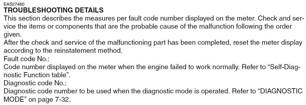

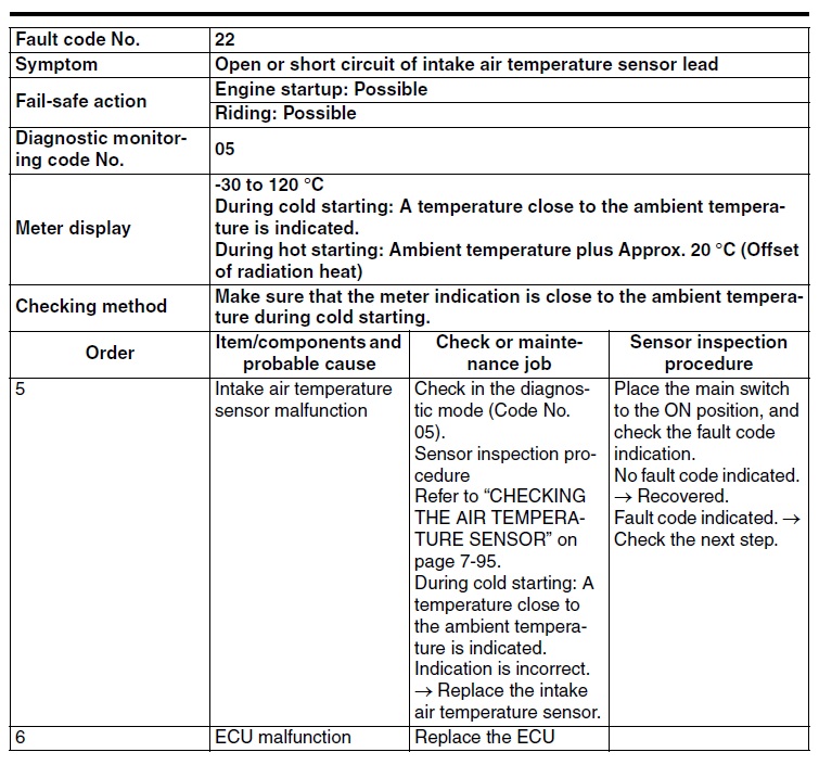

Du-Rron Posted March 17, 2019 #2 Posted March 17, 2019 (edited) My brother owns a 2012 xvs95ctb©. He has a code 22, he has replaced air intake sensor. He said he found some info online on resetting the ecu but no luck. Anyone have any input thanks, Buz Not "Air Intake Sensor" but "Air Intake Temp Sensor". He may have replaced the sensor, but need to check the wiring to ECU to make sure it is okay and ECU is getting signal from new sensor. Once wiring is inspected, you have to perform a sensor actuation test to get rid of the code. If you have already done it as shown below, then the ecu is not getting a signal from the AirTempSensor. This is either sensor (bet not), wiring (probably) or ecu (highly unlikely) fault. Edited March 17, 2019 by Du-Rron
