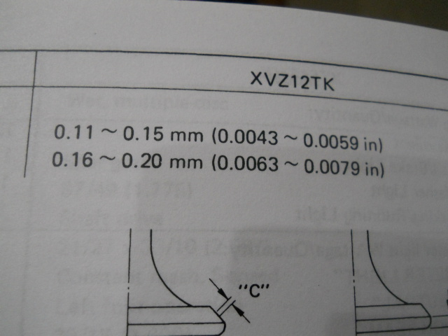

cowpuc Posted March 18, 2019 #57 Posted March 18, 2019 I really have never done one Cha so I have no idea what Yamaha spec is on em but, having done numerous other scoots, I would say anything less than 2 thousandths on the intakes and 3,, maybe 4 thou on the exhausts (that would be .002, .003, .004) and I would call them dangerously tight. IMHO, valves/seats usually wear tight - not loose and it's the runnin tight that leaves the valve open a tad and poof,, burned valve. That said,, probably not be a bad idea to check Yam spec to see how close of guess that is,,, you got a Shop Manual? I can look it up real quick if you need me to, just a short walk downstairs - open a file cabinet - open the book to check with Mom Yam You are welcome on the offer!! Well when i did my valve job on the 99 i remember they were all in spec except for one or two and they were both so close to being in spec i wondered if i should have even changed them. I've got the manual and they've got that nifty little table to tell you which valve to switch it too. Yeah I was wayyy off,, spec is 4 intake and 6 exhaust tightest gap tolerance between the shim and cam on the 1st Gen..
cowpuc Posted March 18, 2019 #58 Posted March 18, 2019 I guess what I'm asking is if, for example the minimum clearance is 5mm and i find one that's at 4mm. Should i bite the bullet and get a shim kit and do both sides? Or should i look for a more extreme difference? Remember that's just an example. I'm at work right now or I'd look at what the clearance is Got cha ya Cha,, on the same 2 track brother.. Seeing this spec as shown in the manual,, if I rolled the piston to TDC on the compression stroke on the jug I was working on and could manage to get a 3 thousandth feeler in between the cam and the shim on the intake and a 5 on the exhaust and I had over 50k on the scoot I would know that my bike is getting at least 1 thou of wear per 50k miles. If my goal was to end up at 200k with no burnt valves from valves going tight, see if you can follow my ill fated logic here = 3 thou x 50k = 150k, 150k + 50k (my test start point) = 200k = TAHHH DAHHH Now for another Puc Point (like all Puc Points = totally 100% still in theory state and up for debate), one of the things I have learned thru time in dealing with other bikes valve trains is that generally speaking, its the first tens of thousands of miles on a new engine that shows the highest percentage of lash wear (all wear actually,, in the old days us back yard mechanics called this period of time "break in") and as the engine increases in mileage after being "broke in", the tolerance stacking actually stabilizes significantly.. Put in another way without my totally destroying any form of Algebraic decency that may have survived what I just tried to explain, I would buy .003 intake and .005 exhaust as absolute minimums if my scoot had +50000 miles on it, had never had the valves adjusted priorly and my goal was 200000 miles and the factory manual specs read like this (from my Shop Manual):

RDawson Posted March 18, 2019 Author #60 Posted March 18, 2019 Intake.004-.006 Exhaust .006-.008 These are the tolerances in the book. Definitely want to set to the high side for long range. I bought the gaskets from Skydoc and got to use his shim kit. I recommend doing similar, by having a variety of shims you can change each one as you get to it instead of checking and recording all 16 and then going back thru to switch around. I needed two shims not in his kit so had to wait a few days to finish but it but it went much easier than I anticipated. I printed the instructions from the read only library, got Skydoc's kit, and another member sent me the shims I needed, so with the help of VR I got the job done. With 43-44k miles I had several on the low side of tolerance with none being critical. I took the time to push them all to nearly full gap so should be good for a long time. I'm with the others if you're almost to the valves invest a little more time if for no more than peace of mind.
