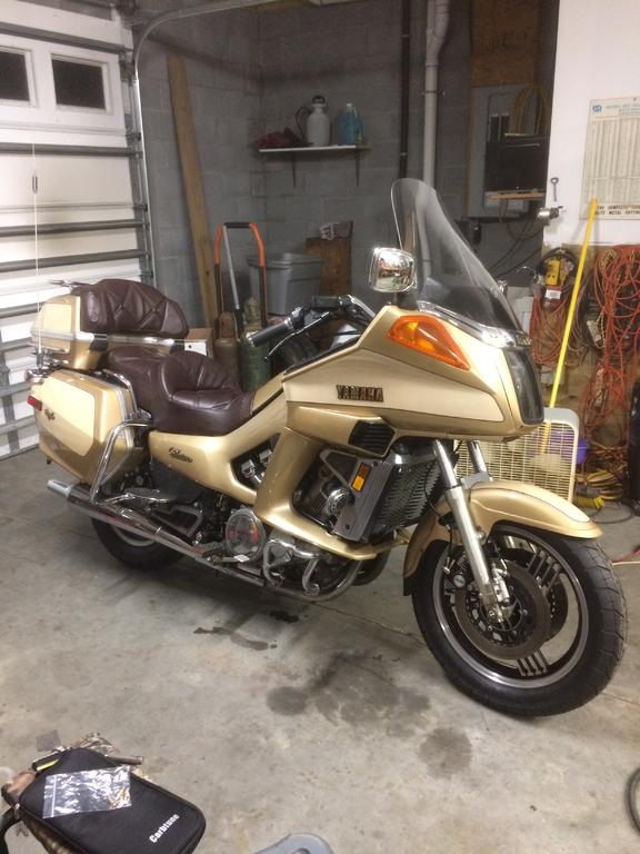

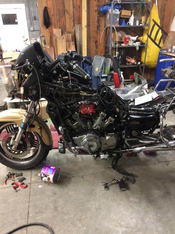

Vickersguy Posted March 8, 2019 #1 Posted March 8, 2019 Thanks to many contributors and in particular, Cowpuc, I've gotten from torn apart to back together. Another '83 is saved from scrap and ready for the road again. Now, the final part. The right front cylinder takes a bit longer to heat the exhaust flange beyond the touchable temp. The other three heat up quickly. With no tags and no helmet in this helmet state, I haven't gotten to really ride it yet, but zipping up and down the street it seems OK. I might have a slight exhaust leak at the collector but nothing I can see. It takes a full two minutes to run evenly without the choke. It will not rev until this two minutes are up. Then all seems normal with a little less power than I remember, however it's just barely up to operational temps. The carbs are cleaned and synced. Pilot screws are all at two turns out. ( I'm going to give the right front carb another 1/2 turn. ) So my question is... I have the colortune plug. The "Bunsen blue" range seems to be from 1 1/2 turns to 3 1/4 turns on the pilot air screws. This is way too wide for me. I compromised with 2 turns and may go 2 1/2. I have no access to EGA equipment so I'm thinking I'm reduced to checking the plug condition for the proper medium tan color. Any quick ideas on how to chase the pilot air screw to a good setting or am I already there for all intents and purposes...
cowpuc Posted March 9, 2019 #2 Posted March 9, 2019 WOWZY WOW WOW WOW :178::178::178:Vick,, she is GORGEOUS :178::178:!! Truly a job very well done there brother!!!! :thumbsup: Couple things on the tune,,, if you havent done so and are using old plug wires, I would unscrew the plug caps, clip a 1/4 inch off the end of each wire to be sure I had mitigated any chance of resistance,, then I would Ohm out (check resistance) the caps.. Also check for any form of carbon tracking. I would also make sure that I had a good, OEM air filter in the box and that the cover fit well. While there I would take a long screw driver and, without having to take the diaphram covers back off, carefully slide the slides to make sure nothing is hangin up there. Understanding that these puppies really do not take throttle well until warmed to operating temp, I would refrain from spit/finger testing at this point and use a Laser Temp Taker (cheap at HF,, think I paid 15 bucks for mine and it works awesome) to "shoot" each header as the bike warmed starting right at first start and all the way up to op temp, getting a really good handle on whether or not all are hitting. I would also pay special attention to typical warm up exhaust "steam/smoke" so I knew I was dealing with pipes that were not plugged with mice nests. If she is coming up on all four on choke and the temp verifies it and they are all staying pretty close all the way to op temp, then I would give her a really good rump of 15 or 20 miles and see if we smiled at each other after that:big-grin-emoticon:.. Give er a chance to settle in some after being rescued and now in the hands of the Master Builder,, which you obviously are brother!!! On the Color Tune, I would dial em all in to that purdy blue flame range and run it. Maybe revisit the Color Tune after ya get some miles on it and see if its changed. Word of note though, if you end up clipping the plug wires a tad and Ohming old caps,, you might wanna recheck the Color Tune cause even the slightest resistance on those caps can cause some serious funk in the combustion chamber.. Hope this helps,, GLAD YOU GOT HER ON HER FEET BROTHER! Just GORGEOUS!!:bowdown::bowdown: YOU DA MAN VICK!!!!!! Puc

made2care Posted March 10, 2019 #7 Posted March 10, 2019 Vickersguy said: Thanks to many contributors and in particular, Cowpuc, I've gotten from torn apart to back together. Another '83 is saved from scrap and ready for the road again.https://www.venturerider.org/forum/attachment.php?attachmentid=115689https://www.venturerider.org/forum/attachment.php?attachmentid=115690 Now, the final part. The right front cylinder takes a bit longer to heat the exhaust flange beyond the touchable temp. The other three heat up quickly. With no tags and no helmet in this helmet state, I haven't gotten to really ride it yet, but zipping up and down the street it seems OK. I might have a slight exhaust leak at the collector but nothing I can see. It takes a full two minutes to run evenly without the choke. It will not rev until this two minutes are up. Then all seems normal with a little less power than I remember, however it's just barely up to operational temps. The carbs are cleaned and synced. Pilot screws are all at two turns out. ( I'm going to give the right front carb another 1/2 turn. ) So my question is... I have the colortune plug. The "Bunsen blue" range seems to be from 1 1/2 turns to 3 1/4 turns on the pilot air screws. This is way too wide for me. I compromised with 2 turns and may go 2 1/2. I have no access to EGA equipment so I'm thinking I'm reduced to checking the plug condition for the proper medium tan color. Any quick ideas on how to chase the pilot air screw to a good setting or am I already there for all intents and purposes... Beautiful bike. Will pick up same bike in a couple of weeks and restoration here I come.
Vickersguy Posted March 10, 2019 Author #8 Posted March 10, 2019 Thanks, but this is a ten foot restoration. Don't get too close ! LOL.
