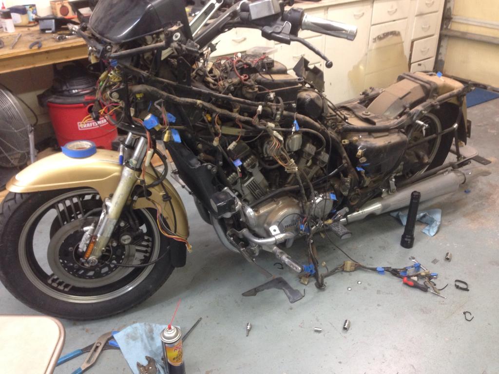

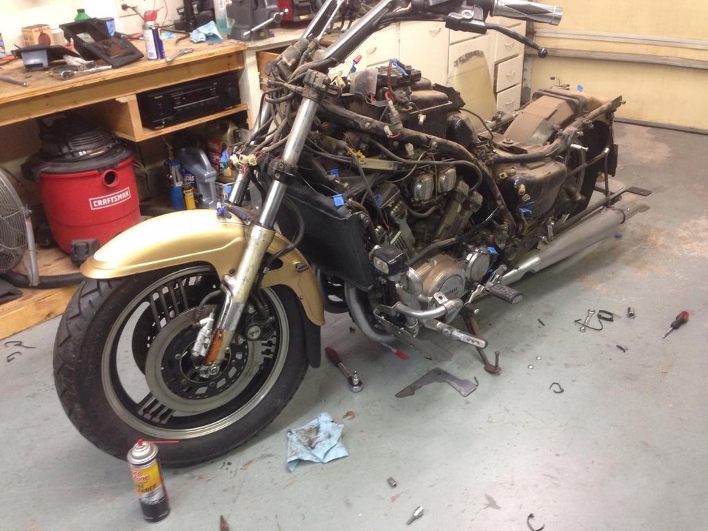

made2care Posted March 19, 2019 Author #209 Posted March 19, 2019 There's enough wiring to reach the moon and back ! Tagged and took lots of pics!
bongobobny Posted March 19, 2019 #210 Posted March 19, 2019 If you download the factory service manual from here (it's free) it has all the cable routing information in it...
made2care Posted March 20, 2019 Author #211 Posted March 20, 2019 bongobobny said: If you download the factory service manual from here (it's free) it has all the cable routing information in it... Good to know. Thanx

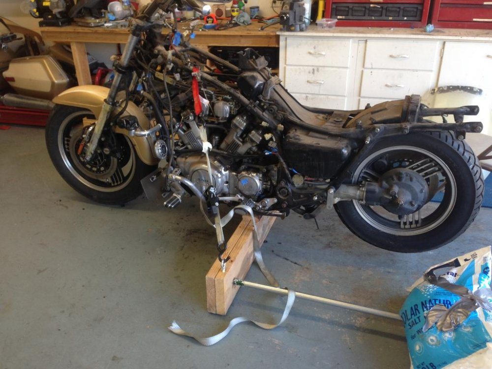

made2care Posted March 20, 2019 Author #221 Posted March 20, 2019 I've watched the video on how to remove the engine. I'm not quite there yet but thinking ahead. I don't want to purchase a hoist and the video shows just using the center stand to set the bike up, then sliding a floor jack underneath. This bike is missing a center stand and the makeshift jack I had made year ago will not work since it rests on the bike frame segment that must come off( right side) to slide engine out. I'm thinking to just get a center stand but maybe that's not the best route since the frame attached to the center stand housing is cracked. thoughts??
RDawson Posted March 21, 2019 #222 Posted March 21, 2019 If the frame is toast I'd block up the engine and cut the frame away from it.
made2care Posted March 21, 2019 Author #223 Posted March 21, 2019 RDawson said: If the frame is toast I'd block up the engine and cut the frame away from it. I thought about that !!
cowpuc Posted March 21, 2019 #224 Posted March 21, 2019 made2care said: I've watched the video on how to remove the engine. I'm not quite there yet but thinking ahead. I don't want to purchase a hoist and the video shows just using the center stand to set the bike up, then sliding a floor jack underneath. This bike is missing a center stand and the makeshift jack I had made year ago will not work since it rests on the bike frame segment that must come off( right side) to slide engine out. I'm thinking to just get a center stand but maybe that's not the best route since the frame attached to the center stand housing is cracked. thoughts?? I know I am a lop eared junk yardin hack of a varmint but if it was mine and knowing that I had to completely dismantle and start from scratch anyway, I would probably just support the under carriage of the motor so there was no way it could tip over as I was doing what I am about to explain,,, then I would get out my Saws All make the cuts in the destroyed frame so could just lift it off the motor.. Do it right, cut the neck and roll the front end over in the corner, pull the subframe and tank, cut the frame in front of the rear end and pull the drive shaft out of the middle gear and roll it to another corner, lift the back bone up and toss it in the scrap bin and have a gorgeous V-4 sitting on frame rails staring me the face just waiting to be remounted in its new home..
cowpuc Posted March 21, 2019 #225 Posted March 21, 2019 RDawson said: If the frame is toast I'd block up the engine and cut the frame away from it. ,, two lop eared junk yardin varmints in the same location at the same time Corporal... Only one of them types faster than the other!! Gotta say though,,, if my left hand was still functional I think I coulda gave you a run for your money!!
