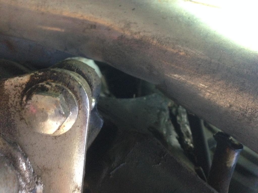

made2care Posted March 17, 2019 Author Posted March 17, 2019 The breaks/ cracks are quite profound. It's amazing she rolls. Here is a pic of right side break.
cowpuc Posted March 17, 2019 Posted March 17, 2019 Bad news !!! I found the breaks in the frame !! Exact same spots as yours were. I am freaking out right now!!! To me my best options will be to find a newer frame that Yamaha fixed ! I will just transfer everything to that frame. Wow!!! This is going to be challenging! What year frame do I look for? Please help , someone!! The breaks/ cracks are quite profound. It's amazing she rolls. Here is a pic of right side break. I am going to read Randy's thread. YEEEOUCHY OUCH OUCH OUCH = that right there is ugly!! Definitely repairable (anything is) and I am sure you are finding that out by reading Randy's amazing repair story Maddy BUT,, thru all the smoke,, PLEASE remember this,,,,, my offer about a a parts bike with good frame stands and is yours = free of charge!! I have donated freebie parts a couple times to help club members at times of need (and have had others help me MANY times over) and consider it a way of life around here - just an FYI to let you know the offer is for real. All of my parts bikes are 83's (my 1st Venture was a 1984 but that one is longggg gone) and I am positive that one of them would make an awesome frame donor for your build. I am not sure on the later = MK2 1st Gen frames for a donor = never owned one but I do believe that they have a longer drive train assembly in them when compared to an 83,,, I have no clue whether or not that is indicitive of a change in frame design/change in subframe design or just swing arm/driveshaft assemble differences.. It might not be a bad idea to ask here in the Water Hole section (kind of a club hang out) and also over on the clubs Face Book page as I think some of the guru's that use to hang out here now hang out on our Face Book page. Any of that make sense? Hook your trailer back up and head to Michigan!!
made2care Posted March 17, 2019 Author Posted March 17, 2019 YEEEOUCHY OUCH OUCH OUCH = that right there is ugly!! Definitely repairable (anything is) and I am sure you are finding that out by reading Randy's amazing repair story Maddy BUT,, thru all the smoke,, PLEASE remember this,,,,, my offer about a a parts bike with good frame stands and is yours = free of charge!! I have donated freebie parts a couple times to help club members at times of need (and have had others help me MANY times over) and consider it a way of life around here - just an FYI to let you know the offer is for real. All of my parts bikes are 83's (my 1st Venture was a 1984 but that one is longggg gone) and I am positive that one of them would make an awesome frame donor for your build. I am not sure on the later = MK2 1st Gen frames for a donor = never owned one but I do believe that they have a longer drive train assembly in them when compared to an 83,,, I have no clue whether or not that is indicitive of a change in frame design/change in subframe design or just swing arm/driveshaft assemble differences.. It might not be a bad idea to ask here in the Water Hole section (kind of a club hang out) and also over on the clubs Face Book page as I think some of the guru's that use to hang out here now hang out on our Face Book page. Any of that make sense? Hook your trailer back up and head to Michigan!! Although this is a very nice gesture , it's just not feasible for me , considering time off from work. I think I might try fix this frame. It won't know for sure until I get the bike flipped over. Again, very generous of you .
cowpuc Posted March 17, 2019 Posted March 17, 2019 Although this is a very nice gesture , it's just not feasible for me , considering time off from work. I think I might try fix this frame. It won't know for sure until I get the bike flipped over. Again, very generous of you . Offer stands Maddy, if you change your mind and decide to go for it just give me a quick heads up. The bikes are covered, have occasional parts robbed off em and are going no where that I know of. Our zip here is 49445, if you ever want to do a quick mileage/time to travel guess that should get you a fair estimate.. Your welcome and all the very best on the build no matter what you go!!

Venturous Randy Posted March 18, 2019 Posted March 18, 2019 made 2 care, Tim, I suggest you need to take a step back and put your priorities in some kind of order. Right now your #1 is fixing the frame either by replacing it or repairing it. I did respond to your PM and hope it helps. Randy
made2care Posted March 18, 2019 Author Posted March 18, 2019 made 2 care, Tim, I suggest you need to take a step back and put your priorities in some kind of order. Right now your #1 is fixing the frame either by replacing it or repairing it. I did respond to your PM and hope it helps. Randy Agree ! will begin tear down.
Vickersguy Posted March 18, 2019 Posted March 18, 2019 Oh, Man ! This sucks. The locks need to be sprayed with a good break free type oil. They may still work. It took me two days to get mine up and running, but they came through. Mostly. Soak them and let them sit for a day. Don't bust the key ! Now you need to step back for a second. ( Ahem ) Busted frame. High-ish mileage. Trailer hitch ( extra wear and tear on the entire drive train. This includes the busted second gear, the U-joint and final drive hub at the wheel and rear wheel bearings. ). Damaged inner fairing equipment. Evidence of extensive electrical modifications. ( Some of the mods are good. The electronic ignition has been relocated up to the air box. That's a good thing and shows someone was paying attention ). I'm going to add a few things to the stack. You will probably be needing an extensive carb rebuild and new air filter, a valve adjustment with gaskets, and a fairing full of electrical and vent equipment. If you're going for stock, the CLASS system and assorted parts. Possible entertainment system upgrades, new speakers, intercom repair/replacement or a bluetooth system. You're going to do brakes, calipers, pads and brake lines. Master and slave cylinder rebuilds. Front fork bushings and seals and possibly progressive springs, steering neck bearings and front wheel bearings. Don't forget a full exhaust system gasket set. Tires. Battery. Water pump rebuild is a probability if it hasn't been done. Fuel filter, I got a spare I'll donate. I can't tell about the windscreen but the turn signal lenses seem to be missing. If I were doing that big a tear down, I would be putting grease fittings on the rear shock linkage elements. Upside. You have good plastic. You have good paint with the good plastic. If you are doing a restoration, that is priceless. It can't be faked. It just about can't be bought except in the luckiest of circumstances and at a high cost. The final presentation of a restoration is the outward appearance. As dumb as that is, it's the final element. I mean, face it. It's probably the biggest reason you bought this bike when you KNEW it had issues. The plastic and paint cannot be downplayed in importance ! Never say " yes-but " about this. Mechanical stuff can be redone, but not the original plastic and paint. It's as hard as finding NOS exhaust pipes. Cowpuc is wise. ( and kind, did I mention kind ? ) He knows where your project is and I agree with him. He's also gentile. I am not. You've shown us a bike with a broken frame, a shaky electrical system, a heavily worn drive train and a heaping helping of deferred maintenance. It has great plastic which is HUGE. Mine was busted up like a jigsaw puzzle in comparison. This bike is a heartbeat away from being a donor bike rather than a restoration project.( i.e. park a better bike under the plastic you have. ) You need a frame. Getting yours welded up without twisting or otherwise distorting it is a 50/50 shot. I'm fairly good with my TIG, and I'd do it for myself but I'd also be aware that the results could get sketchy fast. Remember, this frame is now bent. How do you plan to align the broken parts when you don't know where they were originally ? If it's twisted and you weld it twisted, it will load one side of the suspension links over the other and horrid mischief will ensue. 1 1/2 degree angular misalignment in this area is a big discrepancy. Work with Cowpuc. There must be a way to ship it without you going to MI. Also: https://www.ebay.com/itm/1983-YAMAHA-XVZ12-T-VENTURE-MAIN-FRAME-CHASSIS-BODY-XVZ-1200-83/254013759559?hash=item3b24666047:g:-QIAAOSwYshUZ~dj But it's probably a salvage title which has it's own issues. Cowpuc's would be a clear title without the insurance restrictions. If you're going that deep into this '83... Take kind ol' Cowpuc's offer. You will NOT get a better option or a better "price". The other option, actually, is to get another Venture, with a good frame and combine the two. It's not a bad idea. For the cost of a motor and a set of carbs off e-bay, you can have a whole bike for spare parts. Perhaps one with a lower mileage drive train, ( no trailer hitch ) a good frame and less plastic. It would be cheaper if it looks bad. You don't care, you have the pretty stuff already. I know you are an experienced builder and this ain't you first rodeo. I know, that you already know what I'm saying. I am only offering you a second opinion and putting the stuff I see, on the plate, to poke around. I've seen your 'Wing and your sweet 160 so I know you have the skill set. You are a talented mechanic with an eye for detail. But even if you disregard my perspective, let me give you this : Cowpuc has been into "83 ventures for over 30 years and was a professional ( for a living ) bike mechanic. He knows his stuff and really really knows the Yamaha Venture. He has owned 5 or so and has ridden over 1 million miles on them. He rebuilds the Venture like you and I sharpen pencils. If he says, " you need a frame " then, by god, you NEED a frame. Perhaps even an '84 frame that doesn't have this issue. I'm just an old guy in North Carolina yappin' at ya, but I want to see you succeed and have an awesome Venture. As a matter of fact, all of us here do . Restoring an old bike is like a game of chess. You really have to think about your next move carefully sometimes. One of my friends once turned his Triumph into a mail box at the end of his driveway. It was his choice and "best" move, at the time. Whatever your move is, the only person it has to please is you. And thanks for the pics ! They're great !

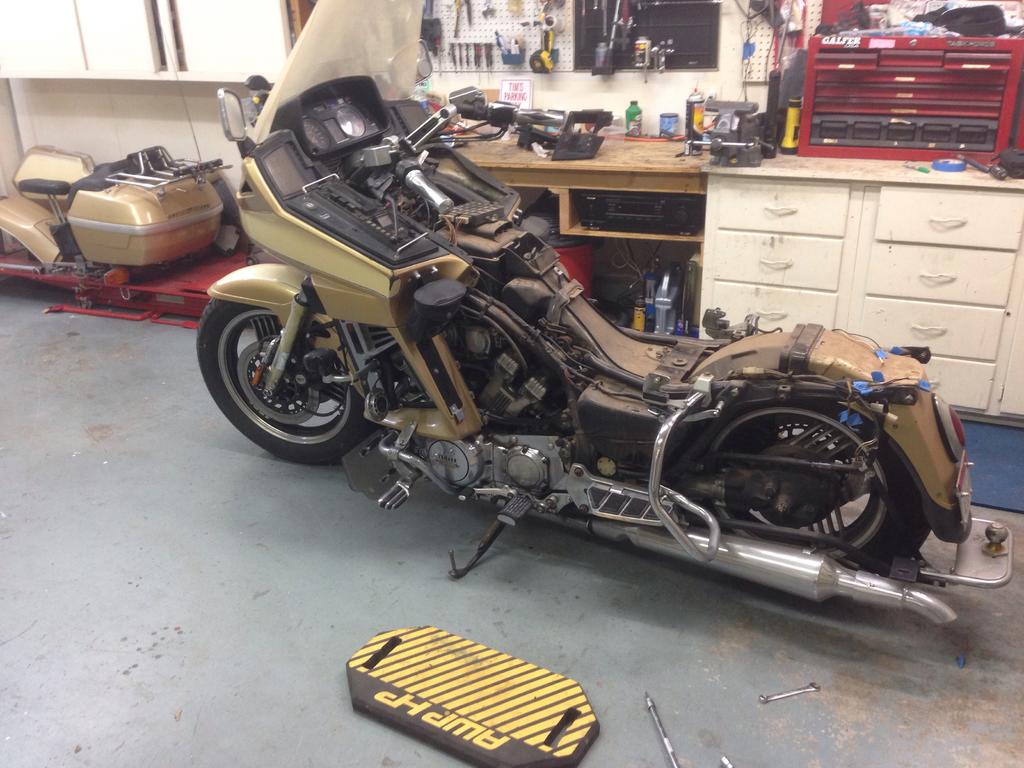

made2care Posted March 18, 2019 Author Posted March 18, 2019 Began teardown today. Also just bought a frame so hopefully it will work. Thanx again for everyone's help and suggestions. Also a big shoutout to puc on his offer but I just couldn't make the drive.

bongobobny Posted March 19, 2019 Posted March 19, 2019 I see somebody did the MK2 passenger floorboard mod on your bike! Stock for MK1 is just pegs... Also, those chrome covers at the end of the engine are aftermarket! PS what is that strange tail light on the fender?? Definitely not stock!
