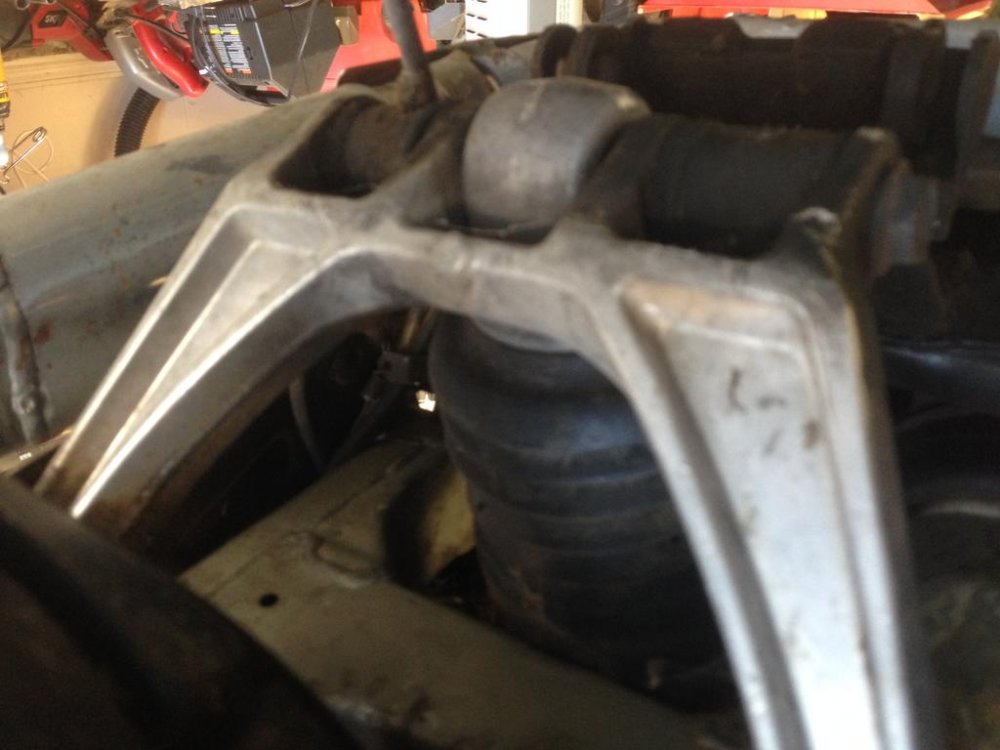

Venturous Randy Posted March 17, 2019 #151 Posted March 17, 2019 How about putting your camera or phone on the ground and taking several pictures of the area where the bottom of the shock attaches to the frame. Also, if your frame is broken as bad as mine was, the rear tire would be rubbing the inside bottom of the rear fender. Also, the bike will not sit on the side stand on level ground. Randy

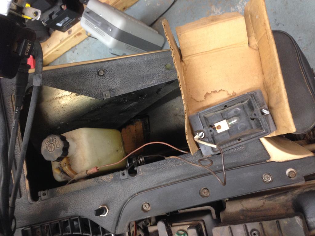

made2care Posted March 17, 2019 Author #161 Posted March 17, 2019 Still exploring. The po closed off the air vents and removed air ducts. On the right fairing compartment he placed a makeshift light which connects to that toggle switch. Looks like he just wanted more easily accessible storage space. He lined that side with foam and carpet. what is the extra set of fuses he wired to battery . He placed these in an old plastic cassette tape box. Other observations: tires are virtually brand new in terms of tread depth but we're made in 2009. I still will get some picks of the frame connected to rear shock.
Vickersguy Posted March 17, 2019 #162 Posted March 17, 2019 here's the air line to the rear shock. No need to spend $90. Save the box and resell the shock... https://www.ebay.com/itm/1986-86-Yamaha-Venture-Royale-XVZ1300-XVZ-1300-Rear-Shock-Suspension/152097457125?fits=Model%3AVenture+Royale%7CMake%3AYamaha&hash=item2369b703e5:g:UNIAAOSwq5pXPx-X These things come up. NO, don't buy it. I'm just happy to " play look " for ya. It's a lot of fun exploring a new bike.
cowpuc Posted March 17, 2019 #163 Posted March 17, 2019 Still exploring. The po closed off the air vents and removed air ducts. On the right fairing compartment he placed a makeshift light which connects to that toggle switch. Looks like he just wanted more easily accessible storage space. He lined that side with foam and carpet. what is the extra set of fuses he wired to battery . He placed these in an old plastic cassette tape box. Other observations: tires are virtually brand new in terms of tread depth but we're made in 2009. I still will get some picks of the frame connected to rear shock. I'd be guessin the "fuses in bag" routine was the PO's answer to the nagging question of what to do about the 1st Gen Failing Fuse Panel Syndrome. What happens is, over time, the ears on the ends of the original fuse holders in the panels loose their boing and their ability to maintain connection on those dorky glass fuses and whammo,, lectrical problems.. Matter of fact,, many of us had scoots with the syndrome so bad that those ears actually broke off = not good thing when half way across the country with an 8 year old on the back seat screamin = how we gonna get home Daddy!! I would get away from the fuse in the bag personally and, at a minimum pick up a few stand alone GM fuse terminals and wire em in independantly (easy fix for on the road repair of the fuse panel). Another very common fix is the GM fuse style panel = works AWESOME and very tidy IMHO..
cowpuc Posted March 17, 2019 #164 Posted March 17, 2019 here's the air line to the rear shock. No need to spend $90. Save the box and resell the shock... https://www.ebay.com/itm/1986-86-Yamaha-Venture-Royale-XVZ1300-XVZ-1300-Rear-Shock-Suspension/152097457125?fits=Model%3AVenture+Royale%7CMake%3AYamaha&hash=item2369b703e5:g:UNIAAOSwq5pXPx-X These things come up. NO, don't buy it. I'm just happy to " play look " for ya. It's a lot of fun exploring a new bike. :sign yeah that::sign yeah that:!!!! Unless ya just gotta have the Class system = :sign yeah that::sign yeah that: Personnally,, I have found the old school, easy peasy manual fill to be the most trust worthy, take a hit for me companion a lop eared long distance 1st Gen ridin varmint could ask for!! GOOD SUGGESTION Vick!!!!!!!!!!!!!!!

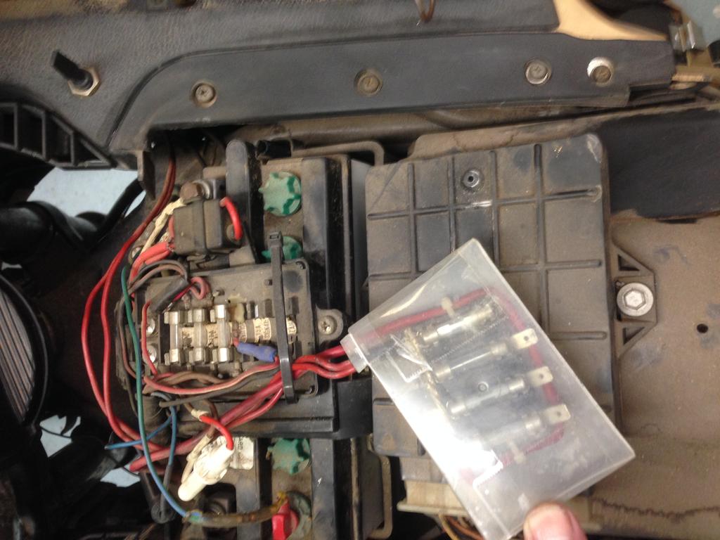

bongobobny Posted March 17, 2019 #168 Posted March 17, 2019 A member here, Skydoc_17 sells a nice upgrade kit for the fuse panel which changes the fuses from those obsolete glass fuses to the modern blade type fuses. Earl is a great guy and his stuff is very reasonable!
cowpuc Posted March 17, 2019 #169 Posted March 17, 2019 I actually just finished wiring in the same fuse box from the tech section in our read only library. I also followed the directions in there to upgrade my battery cables to 4 gauge and put a starter from a 2003 or a 2006 in the bike. There are directions for that in the tech library too. I put the battery in and I thought the bike was gonna fly away the starter spun so fast. Also I noticed with the new battery cables that everything works better from the fuel pump to the lights. I'd highly recommend these upgrades if you're concerned about slow starting when hot (my bike never failed to start when hot, It just turned slow. The only reason I replaced the starter is because I busted the post off the original one getting the cable off . The worst thing about the slow starting IMHO was that people looked at ya kinda funny :8:) and if but when you get rid of that nasty old fuse box. I think I got mine for 20 bucks with shipping I have had really good luck avoiding the hard starting routine thru the years by keeping the interior of the OEM 2 brush Starter clean from brush dust and grime. It all started (pun intended) with another dorky, science experiment of a theory of mine where my pea brain came up with the idea that build up of debris on the armature was causing loss of resistance between the armature segments which resulted in a sluggish starter = in my case, keeping the starter armature cleaned worked amazingly well = good as new!

made2care Posted March 17, 2019 Author #171 Posted March 17, 2019 A member here, Skydoc_17 sells a nice upgrade kit for the fuse panel which changes the fuses from those obsolete glass fuses to the modern blade type fuses. Earl is a great guy and his stuff is very reasonable! Great, I might check that out!

luvmy40 Posted March 17, 2019 #174 Posted March 17, 2019 made2care, I can vouch for the quality of Earl's(skydoc_17) products. I did not use his fuse block kit, but I have installed several of his upgrades, including my current brake and clutch line conversion project. The quality is high and the prices are good Then you also have to take into account the fact that Earl is generally one heck of a nice guy.
