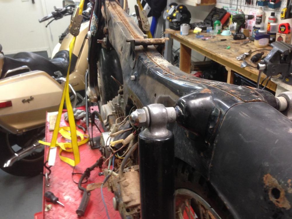

made2care Posted December 26, 2019 Author #739 Posted December 26, 2019 It's been 2weeks since my mom's passing and I have decided to start work on my 1965 Honda. This is keeping my mind busy and helping with the grieving process.
