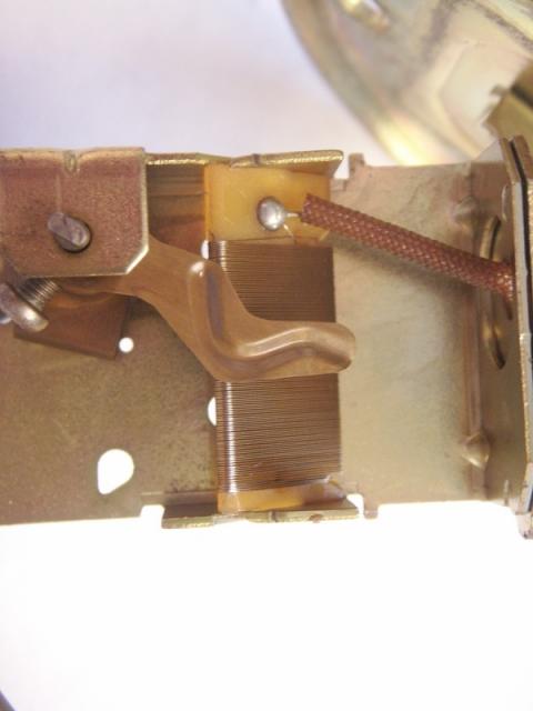

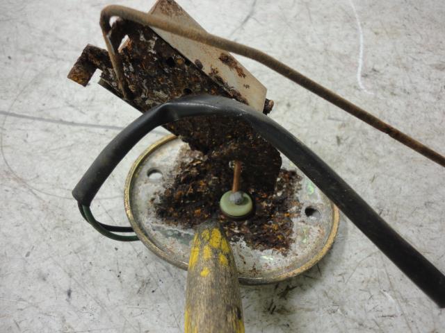

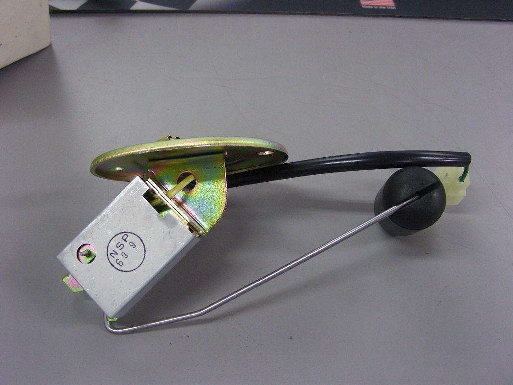

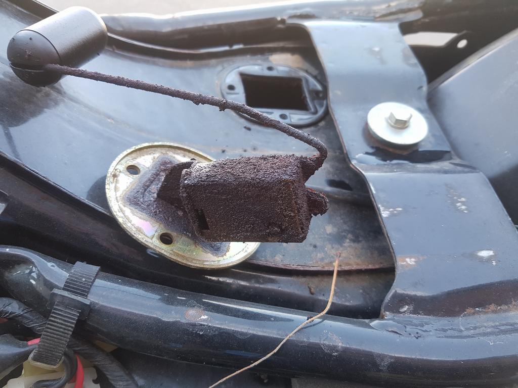

luvmy40 Posted November 19, 2019 Posted November 19, 2019 Okay, now that I have the bike running and not stalling on me, I have a couple more issues to address: 1st the gas tank gauge. I have seen the bars a few times but then they disappear. How do I fix that? the 2nd issue has already been answered and I just have to find the time to tweak, bike is running rich. Check and verify that the grounds are clean. If that doesn't fix it , pull the float assembly and make sure the wiper and coil resister make good contact through the full range of motion. I've had to solder an isolated ground wire on the float assembly on other bikes before.
made2care Posted November 20, 2019 Author Posted November 20, 2019 Check and verify that the grounds are clean. If that doesn't fix it , pull the float assembly and make sure the wiper and coil resister make good contact through the full range of motion. I've had to solder an isolated ground wire on the float assembly on other bikes before. Will do, thanx

Prairiehammer Posted November 20, 2019 Posted November 20, 2019 Okay, now that I have the bike running and not stalling on me, I have a couple more issues to address: 1st the gas tank gauge. I have seen the bars a few times but then they disappear. How do I fix that? the 2nd issue has already been answered and I just have to find the time to tweak, bike is running rich. In addition to what Luv said, follow the leads from the float rheostat to the CMS (Computer Monitoring System). Clean and check any connections, including the main connector on the CMS. Failing to find any inconsistencies in the connections and wiring harness, you must suspect the CMS circuit board.

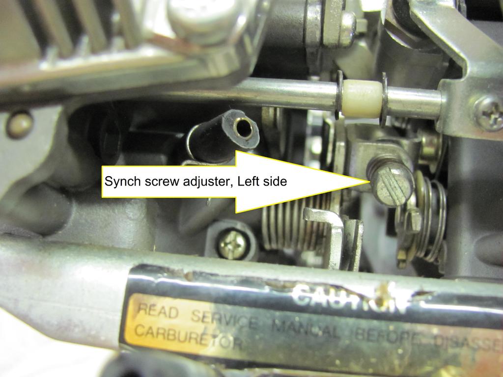

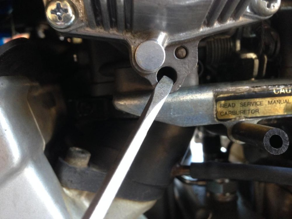

made2care Posted November 23, 2019 Author Posted November 23, 2019 Is this the air/fuel mixture screw? Where my little screwdriver points back in the hole is a little brass screw. I'm trying to sync and turning the screws does not change the dials on my sync tool.

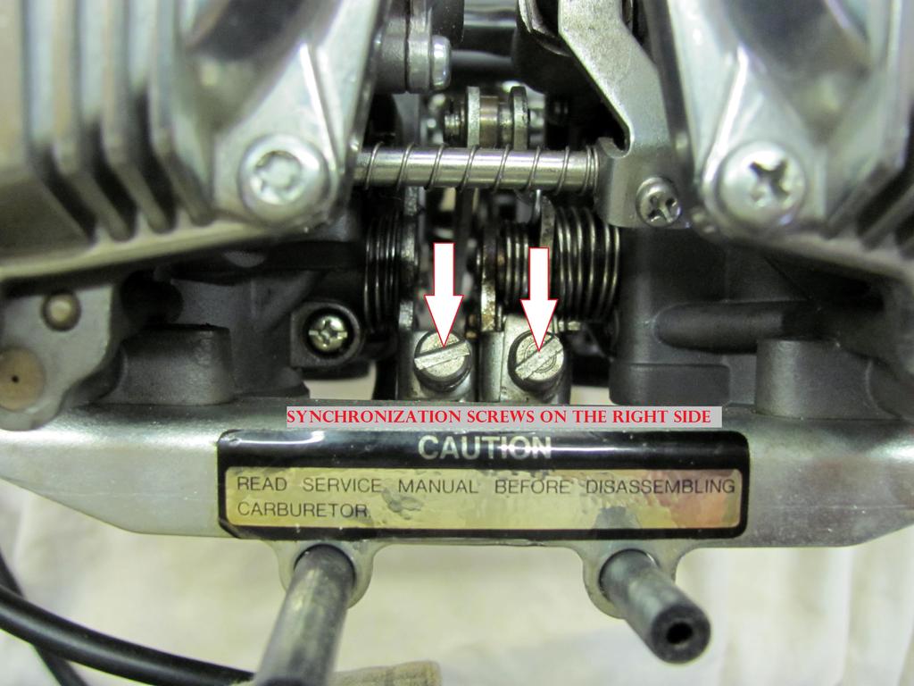

Prairiehammer Posted November 23, 2019 Posted November 23, 2019 Is this the air/fuel mixture screw? Where my little screwdriver points back in the hole is a little brass screw. I'm trying to sync and turning the screws does not change the dials on my sync tool. Yes, that is the pilot screw (air/fuel mixture) but, that is not the synchronization screw. The synch screws are here: Synchronization ProcedureCarb .pdf
made2care Posted November 23, 2019 Author Posted November 23, 2019 Yes, that is the pilot screw (air/fuel mixture) but, that is not the synchronization screw. The synch screws are here: https://www.venturerider.org/forum/attachment.php?attachmentid=118129https://www.venturerider.org/forum/attachment.php?attachmentid=118130https://www.venturerider.org/forum/attachment.php?attachmentid=118131 Okay, now, the pilot screws should be 2 turns out from lightly seated , correct? and if its running too rich, do i turn all the pilot screws in 1/4 turn to lean her out.
Prairiehammer Posted November 23, 2019 Posted November 23, 2019 Okay, now, the pilot screws should be 2 turns out from lightly seated , correct? and if its running too rich, do i turn all the pilot screws in 1/4 turn to lean her out. Generally, we consider 2¼ to 2¾ turns out as a baseline. Yes IN equals leaner, OUT equals richer. Read the pdf I attached to my previous post.
made2care Posted November 23, 2019 Author Posted November 23, 2019 Generally, we consider 2¼ to 2¾ turns out as a baseline. Yes IN equals leaner, OUT equals richer. Read the pdf I attached to my previous post. will do. wow! carbs were out of wac! they are synced now. will still read pdf

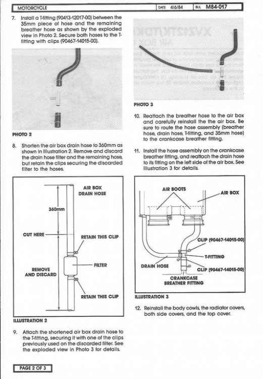

made2care Posted November 27, 2019 Author Posted November 27, 2019 Okay, Can anyone clarify the crankcase breather mod? I'm thinking the setup I have is not helping my gas mileage. Here is my setup which the po did. Both holes capped on airbox. A clear tube running from crankase with a small air filter on end of tube. This tube runs into the cowling on right side where it is not getting much air since the air vent (one facing forward) is blocked off with cardboard. I read somewhere that skydoc had a kit for this. Any thoughts on this and should the little filter at end be exposed to outside to get sufficient air to breath?
made2care Posted November 27, 2019 Author Posted November 27, 2019 I just found this: "For those of you with early Ventures that had the air box drain hose that went to the ground, Yamaha did a design change and issued a tech bulletin. Basically to tee the drain hose back into the breather hose so that oil could eventually drip back down the breather to the crankcase. Here is the fix... The bulletin its M84-017 issued 4/6/84. On the breather hose from crankcase to air box, cut the hose 35 mm from the crankcase end. Install a tee fitting Yamaha part # 90413-12017-00 between the 35 mm hose and the remaining breather hose, and use 2 clips Yamaha part #90467-14015-00. Shorten your air box drain hose to 360 mm, by cutting off the bottom end and discarding the inline filter., Reuse one of the clips from your inline filter on the drain hose to install it into the tee you installed on the breather hose."
BlueSky Posted November 27, 2019 Posted November 27, 2019 Old Coots like me remember the old cars that had a vent pipe that vented the engine base to the bottom of the car to atmosphere. I remember my old chevy V8s having a large tube that connected at the rear of the engine that was routed down. My old $100 59 Chevy developed a head gasket leak or something and water vapor would come out that pipe. When emissions concerns came about, they vented the base of the engine to manifold vacuum and used clean air downstream of the air filter to supply the engine base to complete the engine base purge.
Prairiehammer Posted November 27, 2019 Posted November 27, 2019 I'm thinking the setup I have is not helping my gas mileage. Any thoughts on this and should the little filter at end be exposed to outside to get sufficient air to breath? The method of crankcase ventilation will have no effect on gas mileage. The filter is fine where it is. Its primary job in your case is to simply filter crankcase blow by gases. Personally, I never saw the need for the Skydoc kit.
Prairiehammer Posted November 27, 2019 Posted November 27, 2019 (edited) I just found this: "For those of you with early Ventures that had the air box drain hose that went to the ground, Yamaha did a design change and issued a tech bulletin. Basically to tee the drain hose back into the breather hose so that oil could eventually drip back down the breather to the crankcase. Here is the fix... The bulletin its M84-017 issued 4/6/84. On the breather hose from crankcase to air box, cut the hose 35 mm from the crankcase end. Install a tee fitting Yamaha part # 90413-12017-00 between the 35 mm hose and the remaining breather hose, and use 2 clips Yamaha part #90467-14015-00. Shorten your air box drain hose to 360 mm, by cutting off the bottom end and discarding the inline filter., Reuse one of the clips from your inline filter on the drain hose to install it into the tee you installed on the breather hose." The purpose of this factory mod was to drain oil that accumulated in the airbox, back to the crankcase. On the 1983's the smaller tube from the airbox drained any accumulated oil to the ground under the left crankcase, through a small inline filter. The larger tube between the airbox and the "twinkie" was only for crankcase ventilation, (think PCV). If the crankcase was not overfilled with oil, there was usually no oil accumulating in the airbox. The trouble with oil in the airbox was that Yamaha specified an excessive amount of oil to be added to the crankcase after an oil and filter change. M84-017 Air Box Oil Leakage .pdf Edited November 27, 2019 by Prairiehammer
