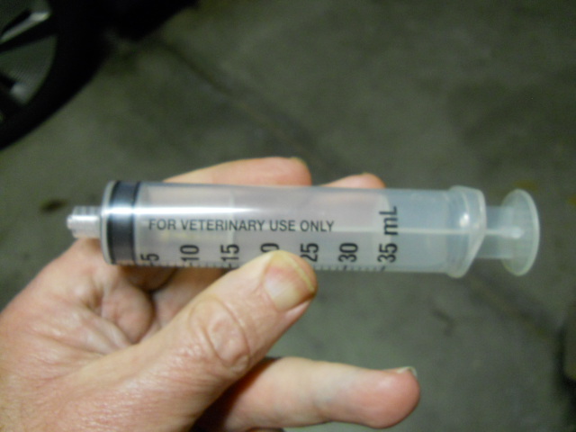

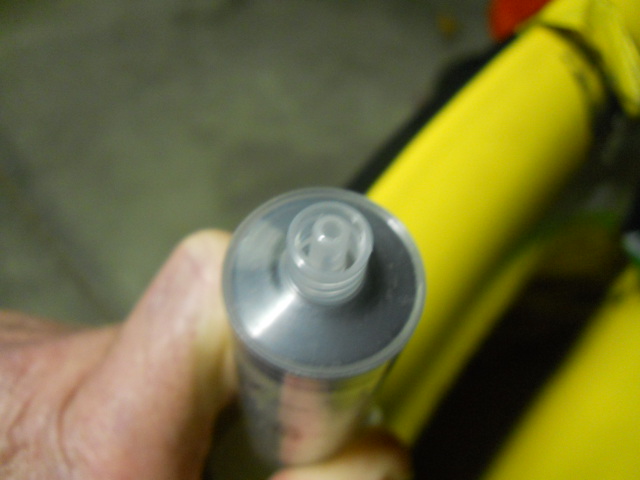

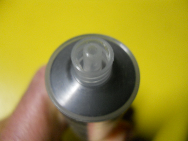

cowpuc Posted November 7, 2019 #660 Posted November 7, 2019 Maddy, I never tried a Turkey Baster but am pretty sure it would be very difficult to attach it to the drain tubes. I have always used Syringes, like what I show in the pics below. I get mine from a local Tractor Supply (use to be Farm and Fleet) and they fit the drain tubes nicely. What I do/have done is attach the syringe to a drain tube by forcing the nipple shown in the pic up into the tube (you may have to pre-spread the tube a little with a pair of needle nose pliers - just stick the closed nose of the pliers in the tube and open the pliers enough to stretch the rubber hose some so the syringe nipple will start into the tube) open the drain and suck the fuel out into the syringe. Leave the syringe attached and pull the plunger out and dump the fuel into a jar. Pull the carb slide/diaphram, fill the syringe with carb cleaner of your choice (I use spray cleaner from Menards), put the plunger back in and push the cleaner into the carb while watching the main jet emulsion tube in the carb body that the metering rod that attaches to the slide slides into. Push fuel in until the cleaner starts flowing from the metering rod hole - when it flows = close the drain and let it soak over night. When I remove the cleaner I like to pull it in and out of the bowl with the syringe to adgitate the cleaner a little. Not sure how well this will work for cleaning the float valve though as the float is going to be raising as you inject cleaner thru the drain... Perhaps,, maybe,, what da heck,, worth a try.. If it were mine I would probably do what I am talking about only after cleaning pulling the cleaner out for the last time I would leave the syringe attached, close the drain, cycle the fuel pump with the kill switch till I heard the pump signal the bowl was full by not cycling anymore, pull the fuel from the carb with the syringe a couple times to wash the float valve thouroughly. Maddy, did you check your fuel tank for rust? If not, it may not be a bad idea to pull the seat, pull the sending unit out of the top of tank and take a look inside of it. Pay special attention to the top of the tank, also dump the fuel you are removing from the carb and put it in a jar and let it set overnight to see if tiny rust particles are gathering in the bottom of the jar. I know this probably sounds nuts but I have had on more than one occasion had rust particles from rusty tank interiors that were so small that even the best of the best fuel filters would not collect em.. The little buggers of rust would still contaminate and mess up a healthy float valve though.. Anyway,, hope this helps.. Here is a video of the carb drain hoses that I did for another clubber, it shows the drain hoses I am speaking of and also some pics of the syringes I use, hope this all helps in some small way brother..

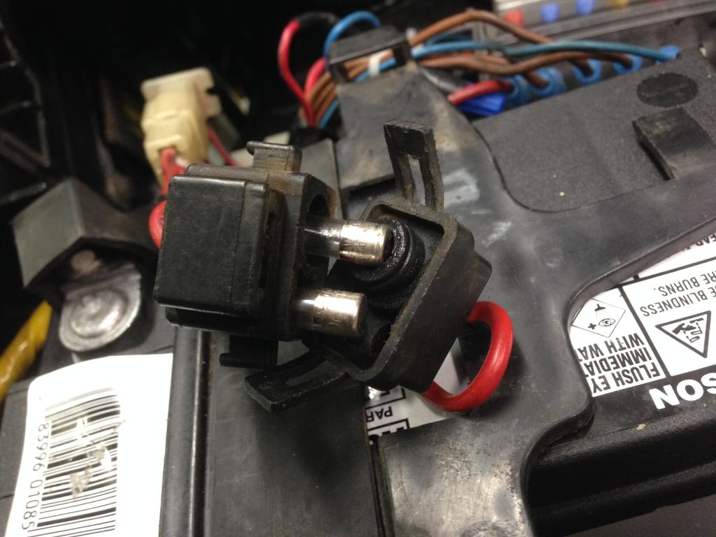

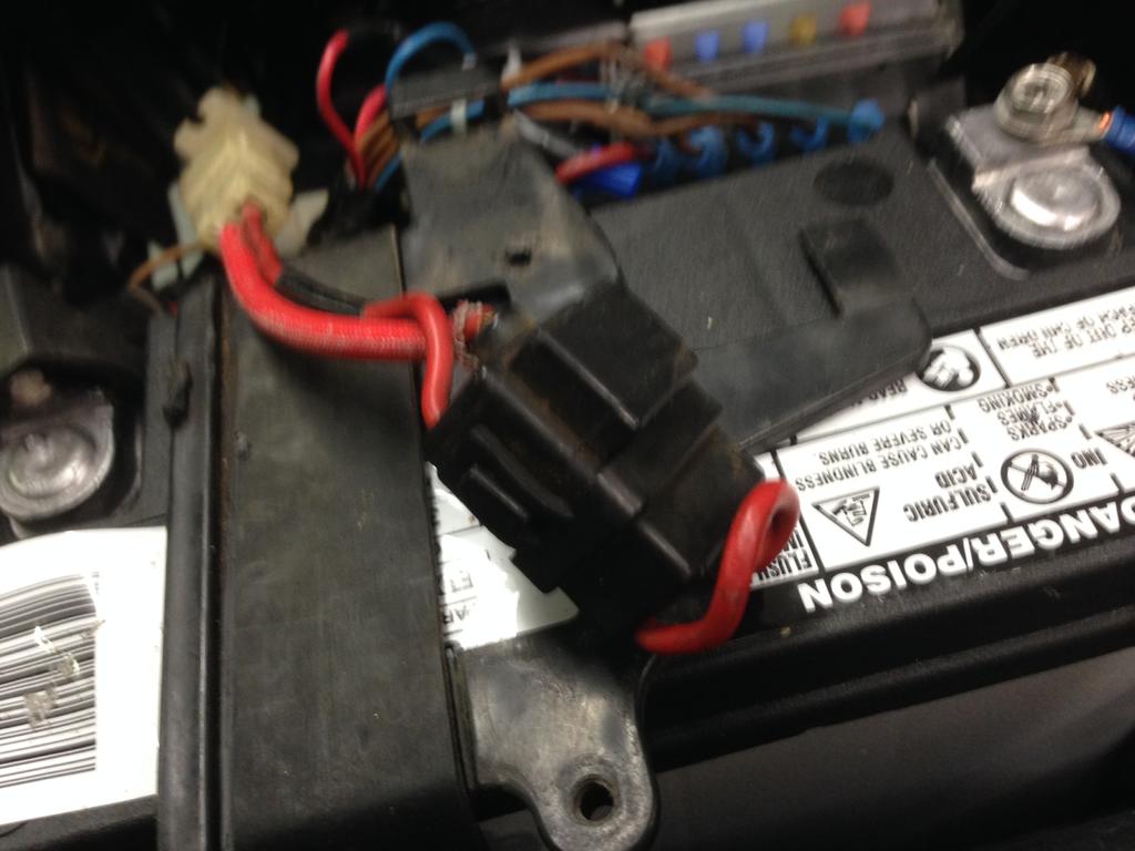

made2care Posted November 7, 2019 Author #662 Posted November 7, 2019 Good news but.............................. Okay, carb is unstuck. I opened the drain screw and fuel is coming out nicely now. Bike seems to be running well again but it will miss from time to time. I will check the plugs again. If its running too rich is there a way i can lean her out a bit? Also, There is a little rubber square (will take a pic) that sits to the right of the fuse panel ( i did upgrade the fuse panel using skydocs kit ). I do remember this having a slight issue but just now thought of it. Inside are 2 glass fuses, one is a spare. I do remember having to hold it tightly for the bike to stay running or start properly and then forgot about it. Could this be causing the missing? just a thought. Anyway, no fuel leaking from overflow and cylinder is hot. Will keep you updated. I still think something is up with that glass fuse.

made2care Posted November 8, 2019 Author #664 Posted November 8, 2019 Here is the plug/ connection in question. What is it? Bike runs fine if I hold it tight.
snyper316 Posted November 8, 2019 #665 Posted November 8, 2019 I want to apoligize for my fumble on the turkey baster, I have meat injectors and syringes from my kids medicine i would use. That almost looks like a fuse of some sort but My bikes don't have that.
BlueSky Posted November 8, 2019 #666 Posted November 8, 2019 (edited) My 89 has those fuses but I don't know what they power. Evidently, one of those fuses is a spare. Okay, I went out and looked again with a wiring diagram and the fuse is labeled (CLASS) on the diagram. Edited November 8, 2019 by BlueSky
made2care Posted November 8, 2019 Author #667 Posted November 8, 2019 BlueSky said: My 89 has those fuses but I don't know what they power. Evidently, one of those fuses is a spare. Okay, I went out and looked again with a wiring diagram and the fuse is labeled (CLASS) on the diagram. okay, thanks for the info
made2care Posted November 8, 2019 Author #668 Posted November 8, 2019 snyper316 said: I want to apoligize for my fumble on the turkey baster, I have meat injectors and syringes from my kids medicine i would use. That almost looks like a fuse of some sort but My bikes don't have that. No problem bro. she's running again but just too rich.
