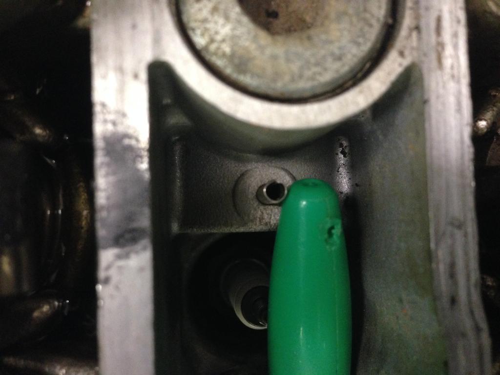

made2care Posted September 7, 2019 Author #562 Posted September 7, 2019 I noticed this little metal tube right next to spark plug. Anyone know what it is and if anything connects to it?i set the green pen pointing at it.

made2care Posted September 7, 2019 Author #564 Posted September 7, 2019 made2care said: I noticed this little metal tube right next to spark plug. Anyone know what it is and if anything connects to it?i set the green pen pointing at it. Second look. It's a pin of sorts.

cowpuc Posted September 8, 2019 #566 Posted September 8, 2019 That roll pin you are pointing at is the locater pin and keeper for a plastic bypass tunnel to transfer anti-freeze. If you look horizontally behind the spark plug you can see the face of the plastic tunnel. The tunnel tube is removable (they can be a pugnacious little buggers to get out because there are o-rings that seal it) by removing the spark plug, pulling the roll pin and grabbing the exposed fin on the face and turning it/pulling it. If you start having misfiring and discover you are getting water/anti-freeze collecting around the plug - this is the first place I would check.. Just an FYI. If @StevenG was still around he would be well pleased to hear what I am about to mention. If it were mine and was concerned about the rust formation on the valves I would do a compression test on it to make sure the rust had not formed on the face of the valves = possibly creating a leak which would not be good. I would also take my cheapy bore scope (bought it off ebay for 10 bucks, works pretty dog gone good!! I grabbed the one with the 10 foot lead so I could check drains and stuff if I wanted. No idea how much they are now but it was well worth 10 bucks, came with software too), roll the piston up on the intake stroke so the valve was open and look at the face of the valves just for kicks. Slight rust dusting is not that uncommon on valve faces/stems on the intakes after setting for long periods as the intakes run pretty dry, especially with no-lead 10 percent alcohol fuel running over em. As long as I didnt see stalagtites hanging from em I would not be too concerned. To my knowledge these V-4's do not have valve over lap ground into the cam profiles so scavenging is not a factor but you also do not have the benefit of burned gases keeping the valve and stem coated IMHO. Personally,, if the rust was just a dusty look to it, I would probably mix two stroke oil and gas at mix common for a dirt bike/chain saw,, maybe 30 to 1,, in a spray bottle and spray the mix into the intakes as I was rolling the bike over before starting it - dont hydro lock it,, just enough to dampen em up. I would also make sure that the fresh gas I was putting into the tank was "Top Tier" fuel so I knew it had a good detergent assisting in rust dust removal.. Give it every chance to survive any rust that may have built up on the valve faces and stems..
