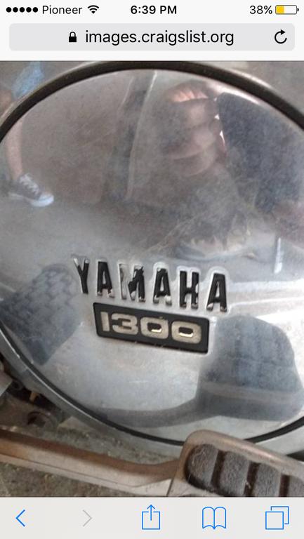

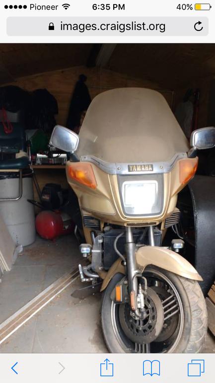

made2care Posted March 7, 2019 Author Posted March 7, 2019 Stranger. I have not seen the bike. Will check it out in a few weeks. He claims the po before him had it for a long time and he has not had it for very long. In his ad the bike is what you guys call here a blonde, so it's the cream colored two tone but has 1300 on chrome cover. He says it's an 83. I don't believe it runs and he is going to check the mileage on it when he gets back to his storage. He lives 40 min from where he has it stored. Here is a pic.
made2care Posted March 7, 2019 Author Posted March 7, 2019 Here's another pic reveal of 1300 that he claims is an 83.
cowpuc Posted March 7, 2019 Posted March 7, 2019 IMHO, judging from its forks I would say its a MK1 (83/85) as the later MK2 1300cc models had the electrical anti-dives and the one in the pic has hydraulics. Once again, another way of checking (besides though mentioned) would be to look at the intake connections for the sync gauges. If the #2 intake connection nipple is rubber plugged like the other jugs it is probably an actual 83. If it has a vacuum line leading up to the TCI rack (should have a small check valve in it too). Either way though, I highly doubt someone dropped a 1300cc/86 or later motor in it as it would not be missing 2nd if they did. More likely a swapped clutch basket cover of just an emblem replacement..

bongobobny Posted March 7, 2019 Posted March 7, 2019 (edited) Yup, the headlight, and the hydraulic (not electric) anti-dives prove it is an '83 or '84. I need to see the dash to determine what year as the '83 had a different dash from the rest of them... IMHO as it stands it's not worth $1500... Look at the rotors (also '83 - '85) and look at the oil on them. Betcha the forks leaked out all the oil. At best the rotors themselves need to be resurfaced. And speaking of brakes, the MK1 brakes left a lot to be desired! There is a reason they were upgraded in '86! I'm also betting that the right mirror is busted for adjustment but maybe not. With the amount of dust on that bike, I'm thinking it has sat there for several years... Edited March 7, 2019 by bongobobny
