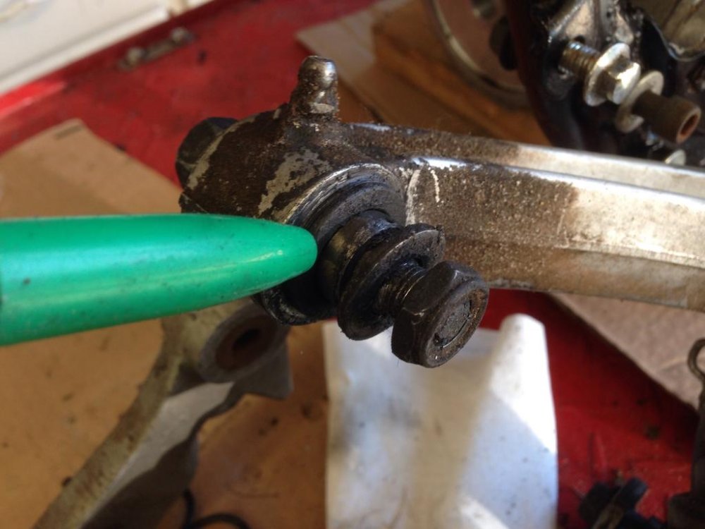

made2care Posted June 24, 2019 Author Share #457 Posted June 24, 2019 This bushing is worn and I cannot find a replacement. It appears to be a solid nylon bushing but not sure. Any suggestion? This fits into one end of the shackle/ yoke that connects to the rear mono shock. Link to comment Share on other sites More sharing options...
Prairiehammer Posted June 24, 2019 Share #458 Posted June 24, 2019 That bushing (90381-18049-00, "Bush, solid") is no longer available from Yamaha. There IS at least two available on eBay, but... https://www.ebay.com/itm/YAMAHA-83-87-XVZ1200-XVZ-1200-VENTURE-ROYAL-REAR-UPPER-SUSPENSION-ARM-BUSHING/112864209229?epid=19016431588&hash=item1a473b294d:g:fBEAAOSwC6haposJ Link to comment Share on other sites More sharing options...
BlueSky Posted June 24, 2019 Share #459 Posted June 24, 2019 Is this it? https://www.ebay.com/itm/YAMAHA-83-87-XVZ1200-XVZ-1200-VENTURE-ROYAL-REAR-UPPER-SUSPENSION-ARM-BUSHING/123657085751?epid=8029476876&hash=item1cca896337:g:fBEAAOSwC6haposJ Link to comment Share on other sites More sharing options...
made2care Posted June 24, 2019 Author Share #460 Posted June 24, 2019 Is this it? https://www.ebay.com/itm/YAMAHA-83-87-XVZ1200-XVZ-1200-VENTURE-ROYAL-REAR-UPPER-SUSPENSION-ARM-BUSHING/123657085751?epid=8029476876&hash=item1cca896337:g:fBEAAOSwC6haposJ too expensive!! but hey, thanks for finding it. Link to comment Share on other sites More sharing options...
made2care Posted June 24, 2019 Author Share #461 Posted June 24, 2019 Neat trick ! Took some teflon tape and wrapped around collar that fits inside the bushing. Might work! Link to comment Share on other sites More sharing options...
BlueSky Posted June 24, 2019 Share #462 Posted June 24, 2019 too expensive!! but hey, thanks for finding it. You may or may not ever find any more new bushings. Link to comment Share on other sites More sharing options...
BlueSky Posted June 24, 2019 Share #463 Posted June 24, 2019 The ones Prairiehammer found are cheaper. Link to comment Share on other sites More sharing options...

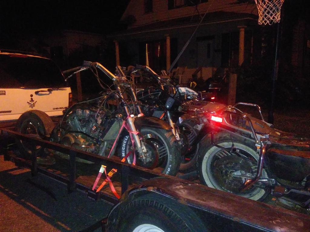

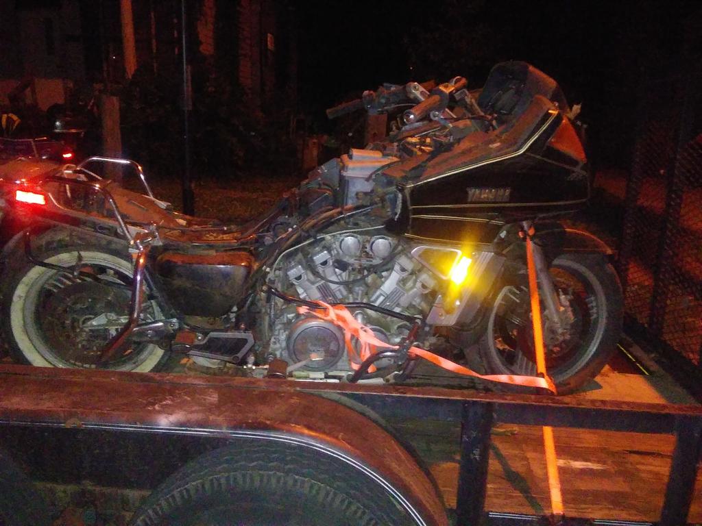

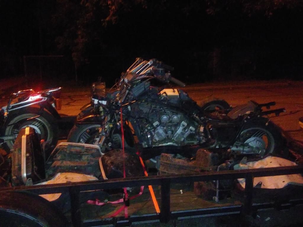

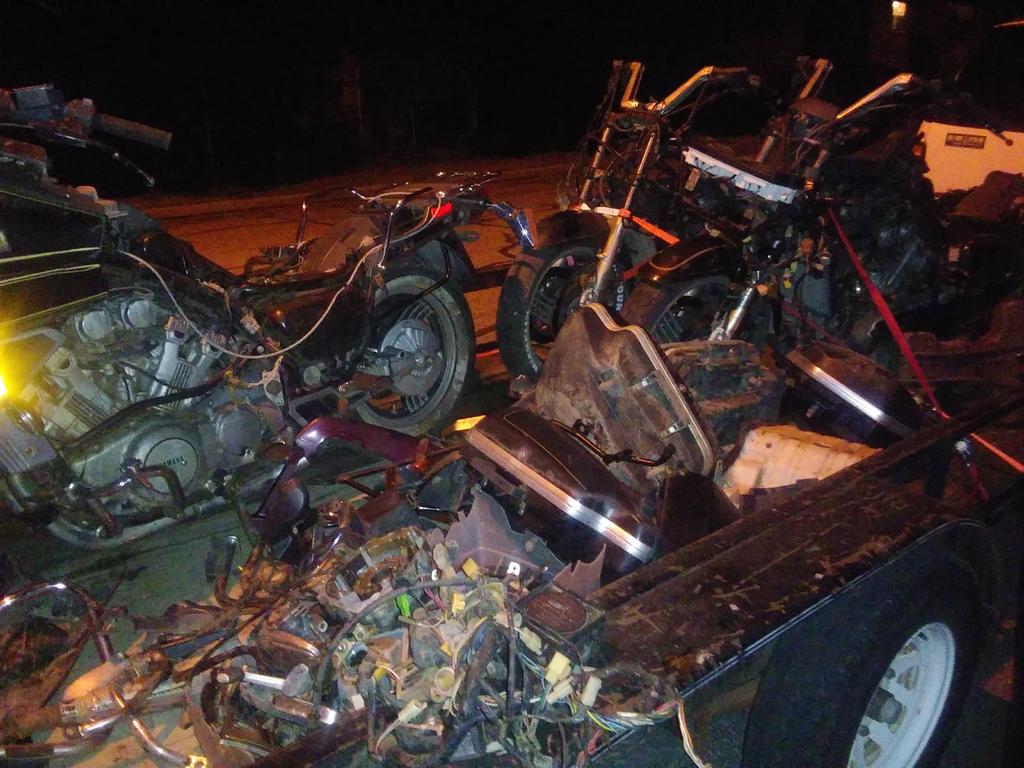

snyper316 Posted June 25, 2019 Share #465 Posted June 25, 2019 Yes sir, Grind the dog ears off the side where the clamp comes together! neat little trick these lop eared varmits have suggested somewhere. That bushing I may have 6 good one not sure.... um I Just finished unloading all the parts and bikes. I Have pictures of them all on the trailer. Link to comment Share on other sites More sharing options...
snyper316 Posted June 25, 2019 Share #466 Posted June 25, 2019 Yes sir, Grind the dog ears off the side where the clamp comes together! neat little trick these lop eared varmits have suggested somewhere. That bushing I may have 6 good one not sure.... um I Just finished unloading all the parts and bikes. I Have pictures of them all on the trailer. Link to comment Share on other sites More sharing options...
made2care Posted June 25, 2019 Author Share #467 Posted June 25, 2019 Wow!! Lots of parts! Good for you! Link to comment Share on other sites More sharing options...
snyper316 Posted June 26, 2019 Share #468 Posted June 26, 2019 Yeah but now looking for motor...... the boxes were on the two that somehow had water in them which getting ready to start a thread about it. Link to comment Share on other sites More sharing options...
