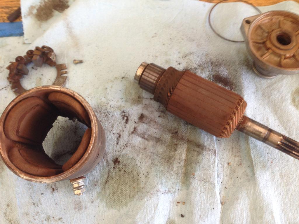

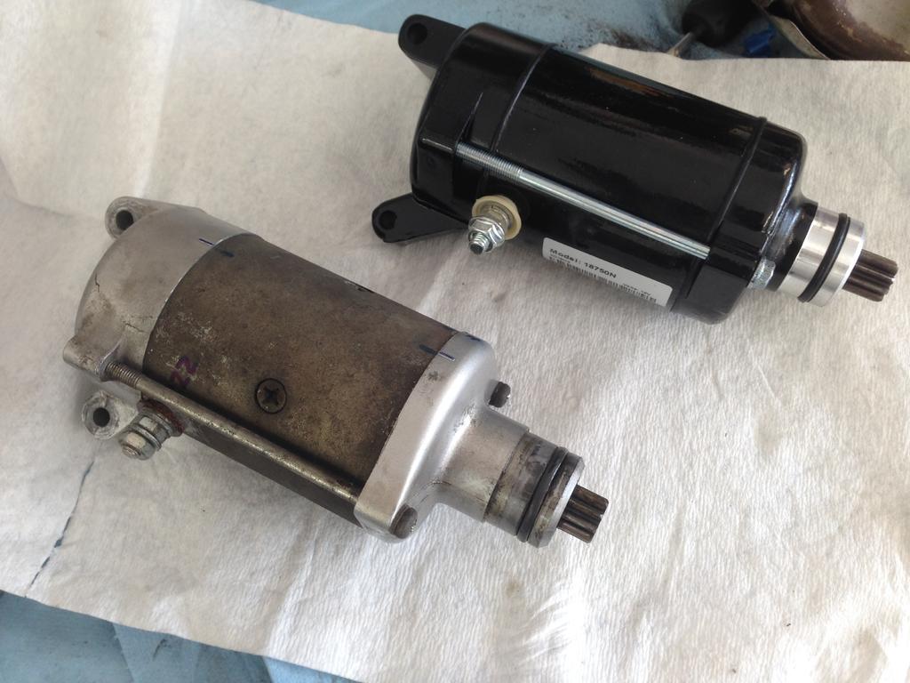

Prairiehammer Posted May 31, 2019 Posted May 31, 2019 Good thing I took starter apart!! Filthy !! RUSTY! Usually the dirt inside is carbon from the brushes. The amount of rust showing would make me nervous about reusing it. The field magnets have been exposed to a lot of high moisture conditions. When the magnets begin to rust, they often start to spall. The consequence is either shorted armature or a severely dragging starter due to the rust and fragments wedged between the field magnets and the armature.
made2care Posted May 31, 2019 Author Posted May 31, 2019 (edited) I managed to remove quite a bit of the rust. Hopefully it will work!! Or maybe I should just get e new one. Anyone purchased a new replacement? Can't seem to find one. Edited May 31, 2019 by made2care
made2care Posted May 31, 2019 Author Posted May 31, 2019 RUSTY! Usually the dirt inside is carbon from the brushes. The amount of rust showing would make me nervous about reusing it. The field magnets have been exposed to a lot of high moisture conditions. When the magnets begin to rust, they often start to spall. The consequence is either shorted armature or a severely dragging starter due to the rust and fragments wedged between the field magnets and the armature. I think you are correct here. Even though i cleaned it, I had no idea that the rust would cause issues. i found a replacement using a RSV and it should bolt right on.
made2care Posted June 1, 2019 Author Posted June 1, 2019 Went with brand new vmax. Crucial parts on this bike should be new if possible. Even though I tried to rebuild this one, the more I thought about it, better to get new and 4 brush. Didn't test this one but just too much rust!! i am not selling this bike when I'm done !! And I hope it will run!!

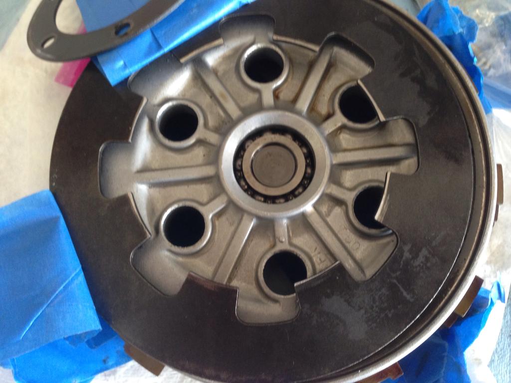

made2care Posted June 2, 2019 Author Posted June 2, 2019 (edited) Not being familiar with clutch parts I did notice this plate and no clutch springs. So this plate has replaced the springs. Will the torque be the same for the clutch screws, manual says 8 nm. Edited June 4, 2019 by made2care

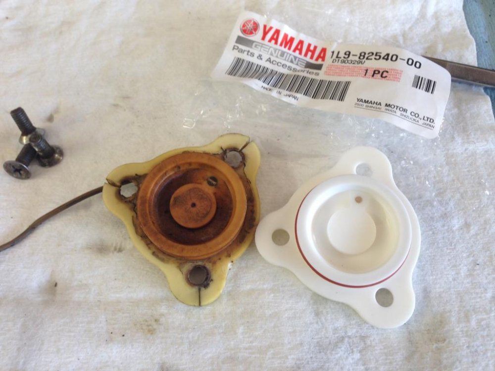

made2care Posted June 4, 2019 Author Posted June 4, 2019 Neutral switch came in. Easy Peazy "switch ". This little guy cost $22 but hey, whose keeping track. I enjoy this and know one day, this bike will be putting on the miles!
made2care Posted June 5, 2019 Author Posted June 5, 2019 There is a retaining wire that holds the first metal clutch plate in place. This wire is broken. Do i need to get another or can i go without it. thanks
RDawson Posted June 5, 2019 Posted June 5, 2019 There's a 1/2 clutch plate in there too. With the upgrade Skydoc sells you do away with the wire and put a full plate in place of the 1/2 and with PCW diaphragm spring the clutch will hook up at all speeds.
BlueSky Posted June 5, 2019 Posted June 5, 2019 There's a 1/2 clutch plate in there too. With the upgrade Skydoc sells you do away with the wire and put a full plate in place of the 1/2 and with PCW diaphragm spring the clutch will hook up at all speeds. From what I've read though, eliminating the 1/2 clutch plate also decreases the distance the clutch lever can be moved to engage or disengage. So, it will be harder to slip the clutch.
RDawson Posted June 5, 2019 Posted June 5, 2019 It does change the friction zone somewhat. I have it in both my bikes and wouldn't change back, especially pulling the trailer. The biggest problem I've had was 1-1/2 hrs of stop n go thru Gatlinburg and Pigeon Forge, I think my left forearm was twice the size of my right from pulling the clutch.
made2care Posted June 7, 2019 Author Posted June 7, 2019 New starter arrived! Easy plug and play. Had to order clutch plate retaining wire. Left side is buttoned up.

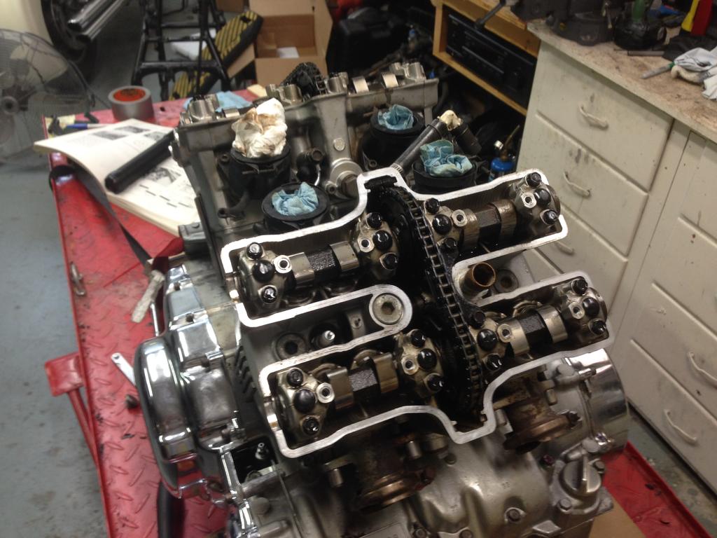

made2care Posted June 12, 2019 Author Posted June 12, 2019 Finally turned engine right side up. Checked valve clearances and just 2 were in spec , so time to fix that! Taking a break though. Vacation time for me , will get back at it upon my return.

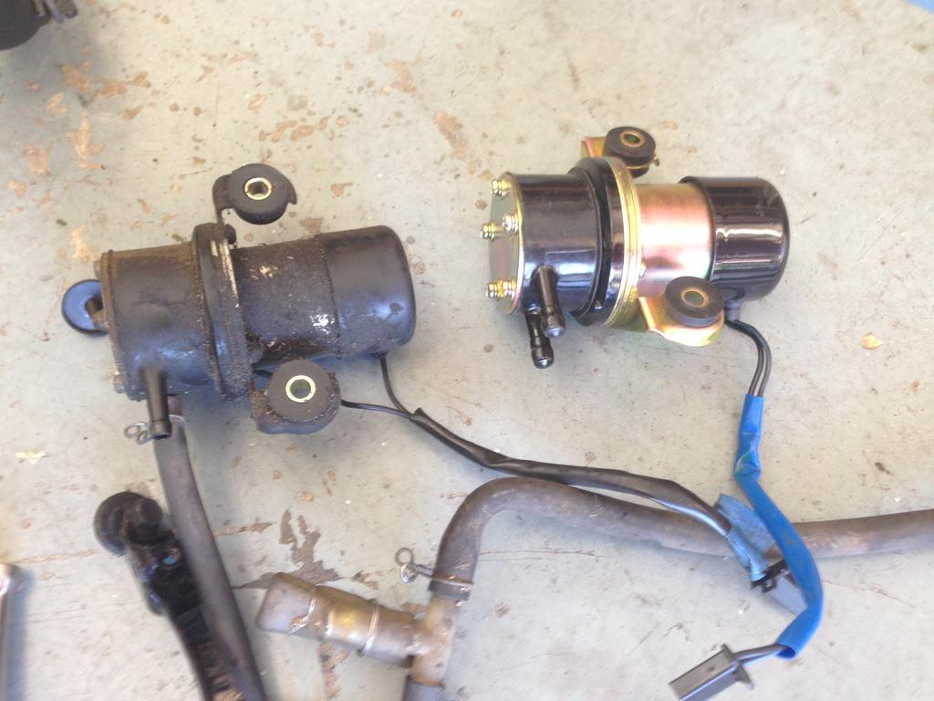

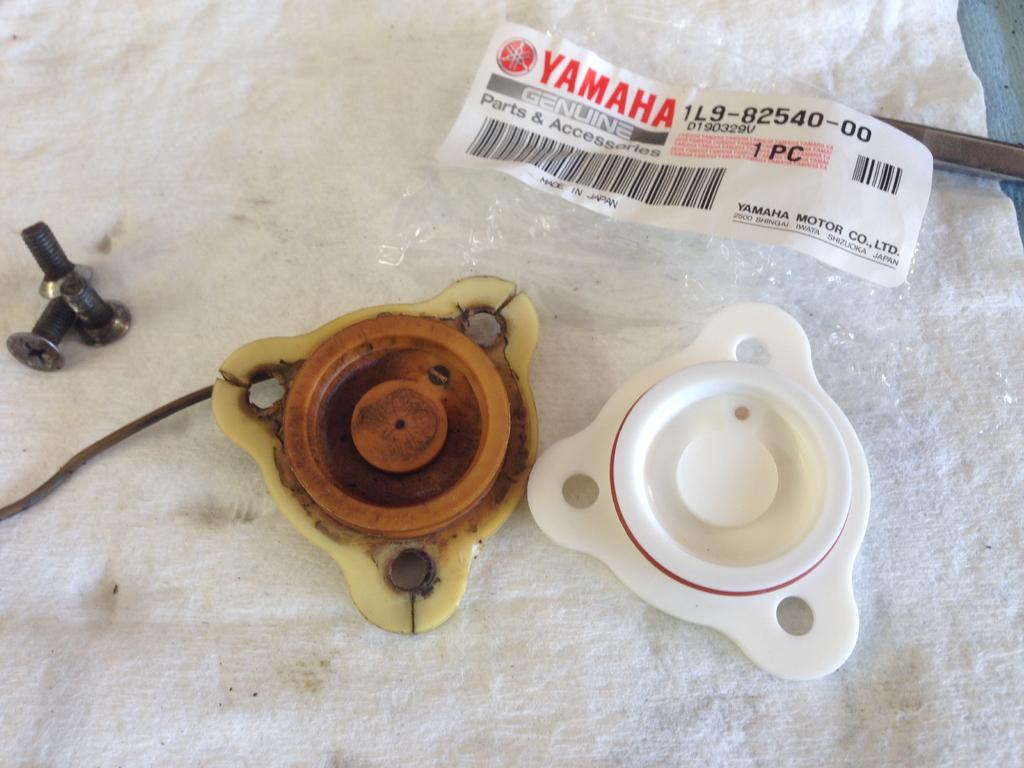

made2care Posted June 12, 2019 Author Posted June 12, 2019 Well, the wife is packing for our trip. You know how that goes!! Since I packed my bag in 5 minutes ( 50 pairs of underwear and a few t shirts) I wandered into the garage and I heard a voice say, " hey, install that pretty new fuel pump real quick !" So..... I did!

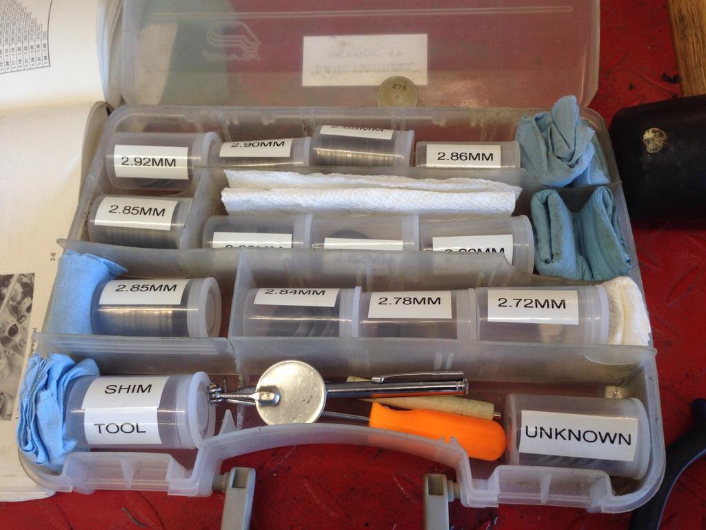

made2care Posted June 17, 2019 Author Posted June 17, 2019 Here is skydoc's( earl) kit I used to fix valve clearance. Shims were easy to remove and replace with correct ones. I did end up having to order an odd size on one- 265 and a few 270's as the kit did not include those. Those should be here in a few days. I'm getting excited as I am near the big day of transplanting the engine to its better/ new frame.

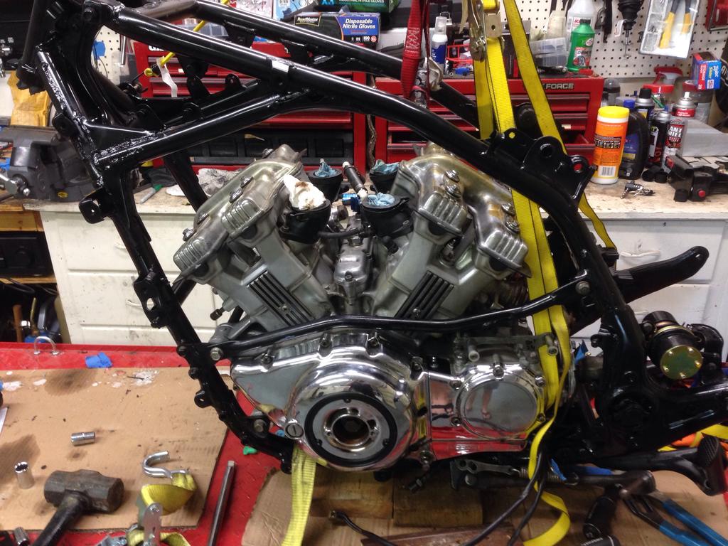

made2care Posted June 21, 2019 Author Posted June 21, 2019 Well, after a few hrs and taking about 3 breaks to vent my frustration, I managed to get the engine married to its new frame. I just lifted the frame over the engine. Lots of tweaking and I must admit, this was a pain in the ars but I somehow managed to get it. Whew!! What a relief!
