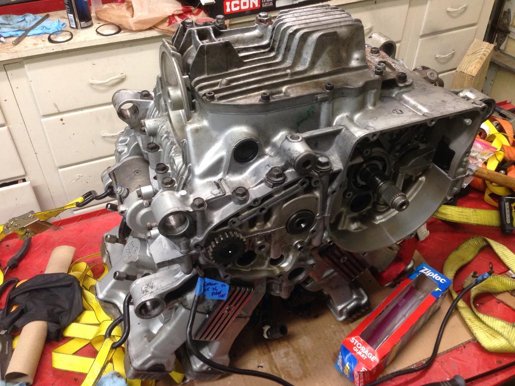

Prairiehammer Posted May 12, 2019 Share #401 Posted May 12, 2019 Okay, I went back and shifted again through each gear and no issues. I have cleaned off some the old gaskets and still have quite a bit left to remove. some more questions: do I oil/grease the outer surface of all bearings. Also, shop manual shows I must oil interior/ inside of bearings. What oil or grease do I use? Or do I just oil them?heres a pics of upper crankcase with old gasket removed. There is no need to lubricate the outer race of the bearings. The outer races are not supposed to move. Oil the inner races and balls with motor oil; that's what will be lubing them later. Link to comment Share on other sites More sharing options...
made2care Posted May 13, 2019 Author Share #402 Posted May 13, 2019 There is no need to lubricate the outer race of the bearings. The outer races are not supposed to move. Oil the inner races and balls with motor oil; that's what will be lubing them later. Okay, I'm getting close to mating to crankcases but waiting on some more parts. I'm going with yamapartsnation but the only downfall is they take too long to ship, anyway, I have a couple more questions; Do i apply yamabond sealant to upper crankcase only or do i apply to both crankcases. I'm thinking just upper and how big of a bead, i realize surface area changes but don't want to put too much on. Also, the manual states that i stay clear of the bearings about 2mm , so do i still attempt to place sealant around bolt holes near the bearings? Maybe my thinking is overkill but i really want to make sure i don't screw anything up. Thanx again. Link to comment Share on other sites More sharing options...
made2care Posted May 13, 2019 Author Share #403 Posted May 13, 2019 I just watched part 8/12 video series and it shows technician applying yamahabond with finger, just a thin layer. Link to comment Share on other sites More sharing options...
bongobobny Posted May 14, 2019 Share #404 Posted May 14, 2019 Yup! Think of it like caulk or a gasket. You want to keep it away from bolt holes because when the two halves compress the yamabond gets squished and it can get into the threads which will cause the bolt to bind up giving you a false torque reading and make it difficult to remove the bolt in the future. just a millimeter or less is sufficient to do this. What I am trying to tell you is if you get a little in the actual bolt hole just remove the excess with a toothpick or something. You do want the sealer around the bolt holes but not in the bolt holes. Keep up the good work!! You will be very pleased with the performance of the bike when it is finished! Back in the day the Venture would run circles around the Gold Wing!!! Link to comment Share on other sites More sharing options...
made2care Posted May 14, 2019 Author Share #405 Posted May 14, 2019 Yup! Think of it like caulk or a gasket. You want to keep it away from bolt holes because when the two halves compress the yamabond gets squished and it can get into the threads which will cause the bolt to bind up giving you a false torque reading and make it difficult to remove the bolt in the future. just a millimeter or less is sufficient to do this. What I am trying to tell you is if you get a little in the actual bolt hole just remove the excess with a toothpick or something. You do want the sealer around the bolt holes but not in the bolt holes. Keep up the good work!! You will be very pleased with the performance of the bike when it is finished! Back in the day the Venture would run circles around the Gold Wing!!! So do i just apply a thin layer to the upper crankcase only, or do I apply to upper and lower. To me, applying to both would be too much. Link to comment Share on other sites More sharing options...
bongobobny Posted May 14, 2019 Share #406 Posted May 14, 2019 Yes, one surface is sufficient as the other surface will come in contact with the sealant when assembled. Some people may be anal and insist that both sides be coated to insure a complete seal but then each surface has to have a super thin application to make sure that not too much is used and it gets everywhere! It is good that you are thinking about all of the possibilities that can happen. Just use common sense and think of what is trying to be accomplished with the task. In this case you are just making sure that the two surfaces, which are never completely flat at a microscopic level, mate up and nothing can leak past the seam... Link to comment Share on other sites More sharing options...
made2care Posted May 14, 2019 Author Share #407 Posted May 14, 2019 Yes, one surface is sufficient as the other surface will come in contact with the sealant when assembled. Some people may be anal and insist that both sides be coated to insure a complete seal but then each surface has to have a super thin application to make sure that not too much is used and it gets everywhere! It is good that you are thinking about all of the possibilities that can happen. Just use common sense and think of what is trying to be accomplished with the task. In this case you are just making sure that the two surfaces, which are never completely flat at a microscopic level, mate up and nothing can leak past the seam... Okay, got it, thanks Link to comment Share on other sites More sharing options...
RDawson Posted May 14, 2019 Share #408 Posted May 14, 2019 I'm sure you know but I'll mention it anyway, when you set the cases together they should meet up flush without forcing them. Had a friend to try to pull case halves together with the bolts when it didn't seat correctly, it's a sick feeling to hear when that aluminum cracks. He didn't have something aligned correctly and broke the case bad enough to have to buy a new one. Link to comment Share on other sites More sharing options...
made2care Posted May 14, 2019 Author Share #409 Posted May 14, 2019 I'm sure you know but I'll mention it anyway, when you set the cases together they should meet up flush without forcing them. Had a friend to try to pull case halves together with the bolts when it didn't seat correctly, it's a sick feeling to hear when that aluminum cracks. He didn't have something aligned correctly and broke the case bad enough to have to buy a new one. I will be careful. What's interesting is that there is only one dowel. I checked the schematic and it only shows the one dowel which aides in lining up everything. Link to comment Share on other sites More sharing options...
RDawson Posted May 15, 2019 Share #410 Posted May 15, 2019 I will be careful. What's interesting is that there is only one dowel. I checked the schematic and it only shows the one dowel which aides in lining up everything. A trick I use in spots like that is to thread a long stud or a bolt with the head cut off into one side to help line things up. Then just back it out once I get a few bolts started. Lined up many car transmissions that way in my younger days. Link to comment Share on other sites More sharing options...

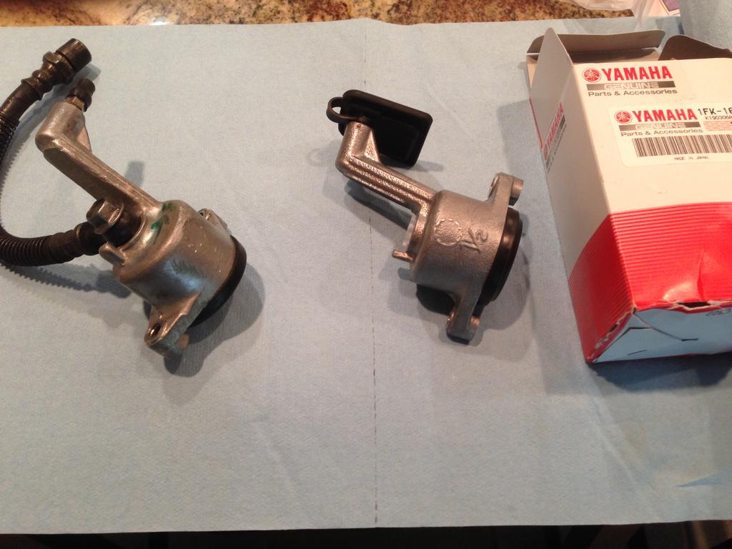

made2care Posted May 16, 2019 Author Share #411 Posted May 16, 2019 New parts still coming in. Decided to just go new with the slave clutch cylinder since it still had original. Little pricey but much needed! Old on left, new on right. Link to comment Share on other sites More sharing options...
Chaharly Posted May 16, 2019 Share #412 Posted May 16, 2019 That one on the left looks pretty good really Link to comment Share on other sites More sharing options...
RDawson Posted May 16, 2019 Share #413 Posted May 16, 2019 If that's the original from '83 I bet the innards don't look as good as the outside. Link to comment Share on other sites More sharing options...
made2care Posted May 16, 2019 Author Share #414 Posted May 16, 2019 That one on the left looks pretty good really Its not good on inside. Link to comment Share on other sites More sharing options...
made2care Posted May 22, 2019 Author Share #415 Posted May 22, 2019 Quick update. I did a dry fit placing lower crankcase back, shifted through the gears and all is good. Will double check gear lash but think it will be okay. Last part is arriving today , so will probably button everything up this weekend. Friday is my last day at work and will finally be on my summer break. Yes, I'm a high school teacher, 20 plus years. Love my summers since i get to do what I want to do: travel, work on bikes, etc, etc. Anyway, will keep you posted. I'm excited to get the engine back in frame. I haven't forgotten to check the valves. Link to comment Share on other sites More sharing options...

made2care Posted May 27, 2019 Author Share #420 Posted May 27, 2019 Well, the neutral switch basically fell apart upon install. I overlooked this part , so will get it this week, pricey too !! I can still go ahead and put case halves together. Still waiting on yamabond 4 sealant though. I'm not going to use anything else. chow 4 now, pics coming soon. Oh, I was in OKC this weekend, just missed the tornado that hit El Reno, Oklahoma, made the national news ! I purchased a 20-100 ft/lb torque wrench at harbor freight for a mere $80. I have a smaller one and needed a larger one for parts of the crankcases. Link to comment Share on other sites More sharing options...

made2care Posted May 29, 2019 Author Share #425 Posted May 29, 2019 Okay, cases are back together. Note to others, I used a small crafts type brush made of horse hair to apply yama bond. I only applied a thin layer to the upper case being careful to stay 2 mm from bearing edges. The small brush made application pretty neat and easy. Bearing retainers are in, along with oil pump and oil pan. Used new o rings , seals and of course Oem gasket which I dry fitted. Before I buttoned everything up, I made sure the transmission shifted through all gears. Gear lash appears fine with very slight movement. So far a great learning experience. I've decided to not paint any parts since most of these are covered anyway. More work planned for tomorrow! Link to comment Share on other sites More sharing options...
