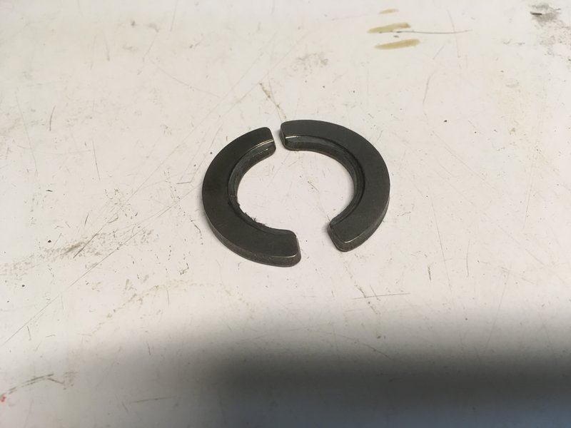

bongobobny Posted April 26, 2019 Share #363 Posted April 26, 2019 I agree 100% with Blue Sky!! The videos will get you to the transmission, and I'm pretty sure someone has taken pictures or done a write-up on how to change that pesky thrust washer... Link to comment Share on other sites More sharing options...

Johnnycyclone Posted April 27, 2019 Share #370 Posted April 27, 2019 mmmmmmmmmm...................I'm reading the 2nd gear repair thread. The gear kit alone is over $300 !!!! Crazy! My understanding is the original recommendation from Yamaha was to replace the thrust washer and the thrust plate. You can always take it as far as you want including installing a complete Vmax engine with trans. That tends to get a little pricey. If you want to do it on a budget then go with the plate and washer. Of course you will need some other small items like gaskets. I would also recommend you inspect all of the gears for wear and also the groove in the shaft where the thrust plate fits into. Any wear here and you would need more than just the plate and washer. Link to comment Share on other sites More sharing options...
