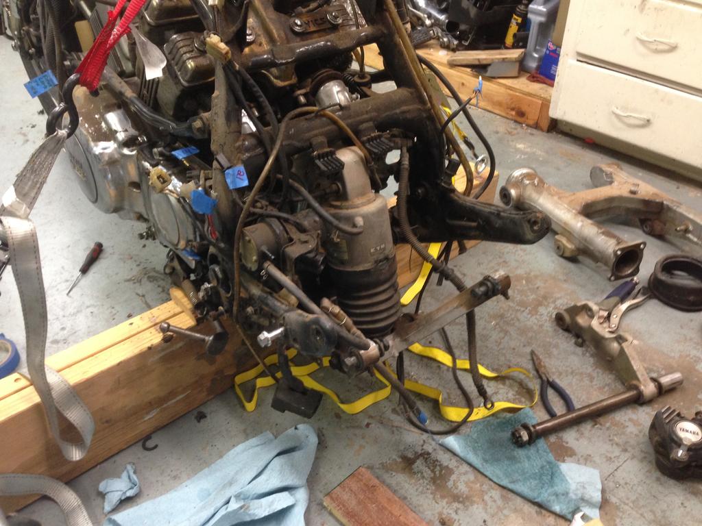

made2care Posted March 30, 2019 Author #290 Posted March 30, 2019 My home computer can't download manuals. Work computer does it instantly ! Believe it or not I have never removed a swing arm. I am going to flip the bike this weekend. I'm assuming there are 4 flange bolts under rubber boot and then of course the swing arm bolts and the whole thing slips off. No need to remove rear wheel and final drive?
cowpuc Posted March 30, 2019 #291 Posted March 30, 2019 (edited) made2care said: My home computer can't download manuals. Work computer does it instantly ! Believe it or not I have never removed a swing arm. I am going to flip the bike this weekend. I'm assuming there are 4 flange bolts under rubber boot and then of course the swing arm bolts and the whole thing slips off. No need to remove rear wheel and final drive? Hi Maddy,, on the outside of the frame at the swing arm pivot you will probably find a big black plastic cap on each side, you pull the cap and will be exposed to the bolt(s) that hold the swing arm in. Those bolts have a shoulder on them that match the bearings the swing arm rides on. If memory serves, the bolt on the right side is the one with a follower nut on it that sets the depth that you screw the bolt in for proper depth,, just make sure that when you back the right side bolt out that you note the position of that nut so you get the bolt back in to proper depth.. Hold on,, I might have a youtube vid on it,, I will see if I can find it.. Yep,, here ya go: Edited March 30, 2019 by cowpuc installed video for swing arm removal
made2care Posted March 30, 2019 Author #292 Posted March 30, 2019 cowpuc said: Hi Maddy,, on the outside of the frame at the swing arm pivot you will probably find a big black plastic cap on each side, you pull the cap and will be exposed to the bolt(s) that hold the swing arm in. Those bolts have a shoulder on them that match the bearings the swing arm rides on. If memory serves, the bolt on the right side is the one with a follower nut on it that sets the depth that you screw the bolt in for proper depth,, just make sure that when you back the right side bolt out that you note the position of that nut so you get the bolt back in to proper depth.. Hold on,, I might have a youtube vid on it,, I will see if I can find it.. Yep,, here ya go: That helps, thanks !!
made2care Posted March 30, 2019 Author #293 Posted March 30, 2019 Okay, I removed the swing arm bolts and rear shock . Will this slide out now or do I need to do anything else?
cowpuc Posted March 30, 2019 #294 Posted March 30, 2019 made2care said: Okay, I removed the swing arm bolts and rear shock . Will this slide out now or do I need to do anything else? You got the rear wheel off, pumkin pulled and driveshaft out of her?
made2care Posted March 30, 2019 Author #295 Posted March 30, 2019 cowpuc said: You got the rear wheel off, pumkin pulled and driveshaft out of her? Easy breezy !
cowpuc Posted March 30, 2019 #296 Posted March 30, 2019 made2care said: Easy breezy ! :sign Rock On::sign Rock On:
bongobobny Posted March 31, 2019 #297 Posted March 31, 2019 Yup, there ya go! Now, when reassembling the swivel shackle for the shock inspect the bushings and shafts very carefully. A lot of times they get worn and can cause slop in the suspension. Many of us have drilled and tapped to install zerk fittings so those bushings can be periodically greased. If you like I can take a picture of how I did mine...
Venturous Randy Posted March 31, 2019 #298 Posted March 31, 2019 Before you try to flip the bike over, drain the oil out of the engine. Randy
