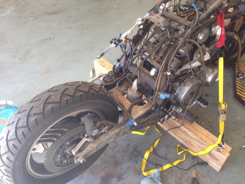

made2care Posted March 21, 2019 Author #226 Posted March 21, 2019 cowpuc said: I know I am a lop eared junk yardin hack of a varmint but if it was mine and knowing that I had to completely dismantle and start from scratch anyway, I would probably just support the under carriage of the motor so there was no way it could tip over as I was doing what I am about to explain,,, then I would get out my Saws All make the cuts in the destroyed frame so could just lift it off the motor.. Do it right, cut the neck and roll the front end over in the corner, pull the subframe and tank, cut the frame in front of the rear end and pull the drive shaft out of the middle gear and roll it to another corner, lift the back bone up and toss it in the scrap bin and have a gorgeous V-4 sitting on frame rails staring me the face just waiting to be remounted in its new home.. Sounds like a plan !
cowpuc Posted March 21, 2019 #227 Posted March 21, 2019 RDawson said: If the frame is toast I'd block up the engine and cut the frame away from it. made2care said: I thought about that !! :scared:MAKE THAT THREE LOP EARED JUNK YARDIN VARMINTS IN THE SAME PLACE AT THE SAME TIME!!! ,, I'm gonna jump in the car and run down a grab a Lottery Ticket!! Suggest you 2 do the same thing and if one of us wins, we split 3 ways

bongobobny Posted March 21, 2019 #233 Posted March 21, 2019 Per the above, my take would be learn how to get it out without hacking things up, that way you will be more prepared to install it which will be the exact opposite or removing it...

Venturous Randy Posted March 21, 2019 #236 Posted March 21, 2019 (edited) Hey, made2care, I am going to throw you one more BIG curve to think about. With the engine out of the bike, it would be the perfect time to permanently fix all your transmission problems. There are actually two problems with these transmissions, one being a soft thrust washer causing the 2nd gear problem and pins that come loose on the shifting tumbler that will only allow the gears to be shifted so far until you can get them replaced. What Yamaha did to fix the pin/tumbler problem was to make a solid unit that replaced the pin setup. This was part of the change when Yamaha went to the 2nd gen transmission and it works great in a 1st gen engine, especially if you add a V-Max final drive that is about 10% lower geared. Comparing this setup to the stock 1st gen, you will have about a 10% lower 1st gear, a 5% lower 2nd, with 3rd and 4th being the same and 5th being about 5% higher geared. It is the ratios I feel Yamaha should have put into the bikes to start with. If you are interested, I have a complete 2nd gen transmission with everything that you will need to do the changeover. This includes all gears and shafts, forks and upgraded shift tumbler. To make this work right, you will need a V-Max final drive and here is one on ebay right now for $83 and it includes the driveshaft, which is also a problem on early 1st gens if it was not lubricated routinely and most were not and the splines get stripped. Been there done that. The reason I am suggesting all this to you is not only to fix your problems, but when you get this thing together and running right you will be addicted to the acceleration and you will be so mad at yourself for having to skip 2nd gear when you could be lifting the front wheel off the ground instead. I have been thru these transmissions from one end to the other and I can absolutely assure you that you will love this setup. Let me know if you are interested. One more thing I may be able to help you with is some solid motor mounts that will help stiffen up the bike and make it handle better. Link to V-Max final drive; https://www.ebay.com/itm/91-YAMAHA-VMAX-V-MAX-VMX-1200-Final-Drive-Differential-1FK-46101-01-00/202487048050?hash=item2f252b2772:g:XKAAAOSwIUVb2OEQ:sc:FedExHomeDelivery!37604!US!-1 Randy Edited March 21, 2019 by Venturous Randy

Prairiehammer Posted March 21, 2019 #250 Posted March 21, 2019 (edited) I am very late arriving at this party, so pardon me if I missed something in the five pages of this thread. 1. Check the engine number. Both the clutch cover and the stator cover indicate that this is a 1300. I can identify the year of the engine if you give me the engine number. 2. If it IS a 1300, the second gear "missing" may not be because of the transmission damaged. It may be because of the linkage train; either the shift drum or the shift linkage on the left side. (The foot pegs are not stock MKI pegs, nor are the peg mounts. The left peg mount looks like it may have been part of an aftermarket floorboard retrofit. The linkage may have been cobbled. 3. Final drive is not stock MKI. Either MKII or maybe V-Max. EDIT: Upon closer examination, the final drive appears to be from a Second Generation Venture. I can just see the speedometer pickup port. 4. Trailer hitch is not made for a MKI Venture. Either for a MKII or perhaps a GW. 5. (minor point): The mufflers are from a MKII. Muffler mount is not proper for a MKI and the turn downs are as for a MKII. 6. (another minor point): The fairing bags are added. The 1983 Royale did not come with fairing bags; the brackets that hold the bags are also not stock Venture. Edited March 22, 2019 by Prairiehammer Addendum to final drive comment
