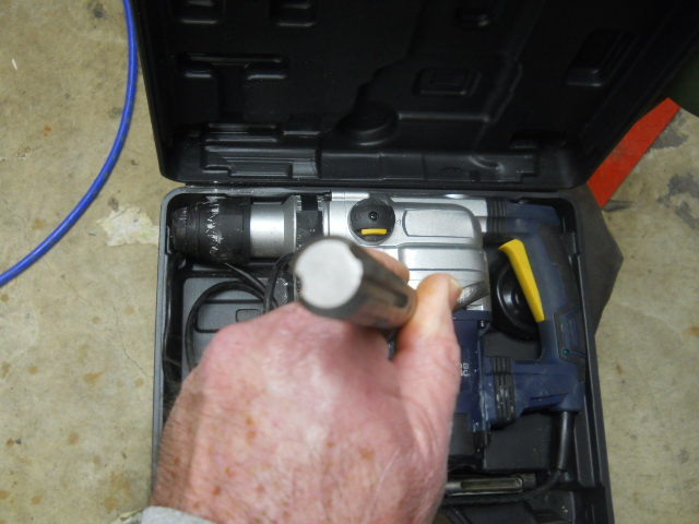

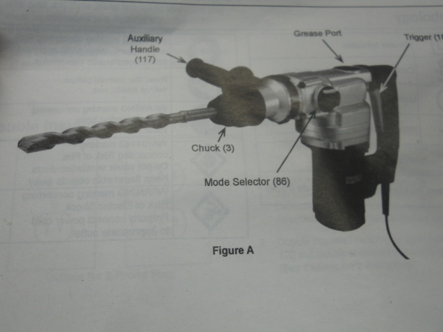

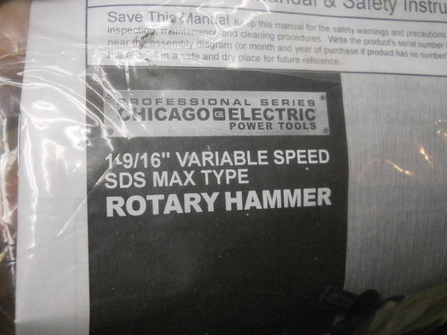

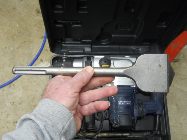

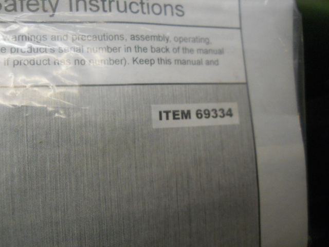

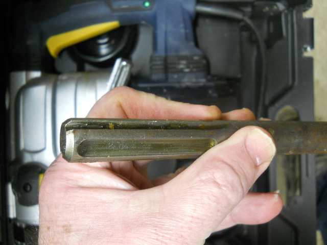

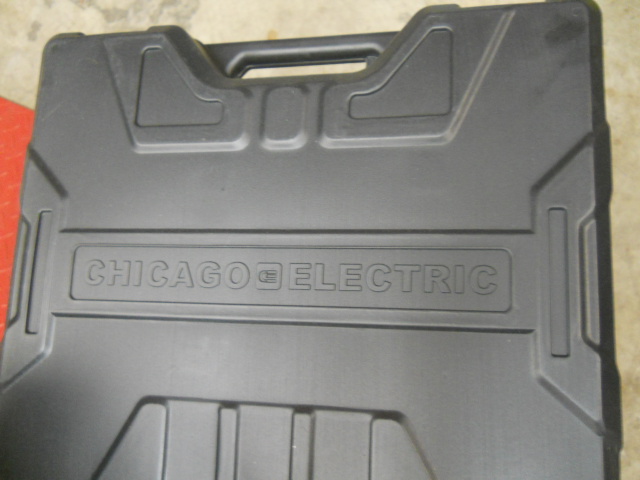

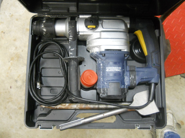

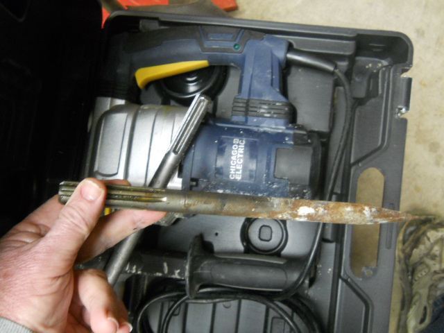

cowpuc Posted February 11, 2019 Posted February 11, 2019 @Flyinfool asked about what I used to bust concrete during my past Sump Pump installation days. Here is a short summary of how that went and what I ended up with. After pricing out actual Jack Hammer rental fee's for the project, being as frugal as I am and as in love with having my own tools, I went out looking for prices on one of those teeth shaking, toe breakin, body rattling monsters. After being SHOCKED at what one of those air powered things I have seen street workers riding around on cost - I made my way to Harbor Freight just to see what they offered. I ended up purchasing the Hand Held Hammer/Hammer drill and a set of Masonry Bits for the machine. What you see in the attached pictures is what I came home with. Been a few years but as I recall, the price of this little jewel was VERY reasonable IMHO. Matter of fact, the unit price was almost exactly what the charge would have been for a rental with the 3 piece masonry bit set price kicking me just over Jack rental costs I had been quoted. Jeff, our home is fairly new so the concrete work (it has poured walls and basement floor) is to money concious spec. I have done a little bit of building thru the years and am pretty sure that whoever the contractor was that poured the floor in the basement used the old "2x4" on its side to screet off the sand before pouring in an effort to not over use concrete. In some older homes that I have remodeled and ended up busting up concrete therein - I didnt always find that to be case and have ran into some pretty thick stuff = LOTS MORE WORK. That said, this unit worked GREAT on my basements 3 1/2 inch crete. I found that using the Point to get started in making a hole worked best and then moving on to the smaller chisel you see in the pics. This thing cut like butter once I learned to let it do the work.. I dont think it would be quite as effective on thicker footing work or real thick floors though.. Just a thought. Here are the pics. Hopefully this helps in your decision making and/or anyone else facing such needs. Puc
Flyinfool Posted February 11, 2019 Posted February 11, 2019 Not quite sure which of these it is comparable to. https://www.harborfreight.com/105-amp-1-916-in-sds-max-type-pro-variable-speed-rotary-hammer-kit-63441.html https://www.harborfreight.com/125-Amp-SDS-Max-Type-Pro-Demolition-Hammer-Kit-63437.html Can you get a pic of the data plate on the tool. That should have all the real info.
cowpuc Posted February 11, 2019 Author Posted February 11, 2019 Mine is the first one Jeff, the 10 and 1/2 amp.

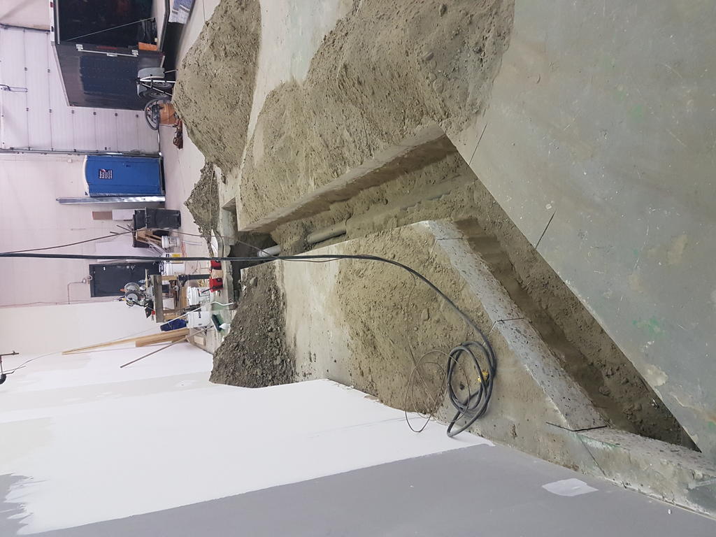

Patch Posted February 12, 2019 Posted February 12, 2019 Unless we are enlarging a hole we choose to cut; it's fast and we reduce fracturing. I know our jobs are bigger but a basement would be the same choice.
Patch Posted February 12, 2019 Posted February 12, 2019 Now that's just plain pretty.... OK I'll bite, and?

cowpuc Posted February 12, 2019 Author Posted February 12, 2019 Now that's just plain pretty.... OK I'll bite, and? Well,, I can't speak for @Condor but I kinda sorta think he was just and admiring the purdiness of that concrete work.. I only say that cause me and Jack got some similar taste in beauty (having been around him and motorcycles and such proved that) and I gotta say,, I TOTALLY AGREE WITH HIM!! NICE PIECE OF CONCRETE WORK RIGHT THERE = definitey PURDY!!
Patch Posted February 12, 2019 Posted February 12, 2019 Thanks Puc. See I'm thinking he's got a humdinger of a joke/tail to tell us. Nothing other intended. There is another advantage to cutting and it rests in the placement, with this type of cut we can bond the placement of the fill to once again make the pour homogeneous and leak resistant via this bonding. We use just inexpensive white carpenters glue unless specked otherwise by engineering. The ratios are on the back of the glue gallons.
