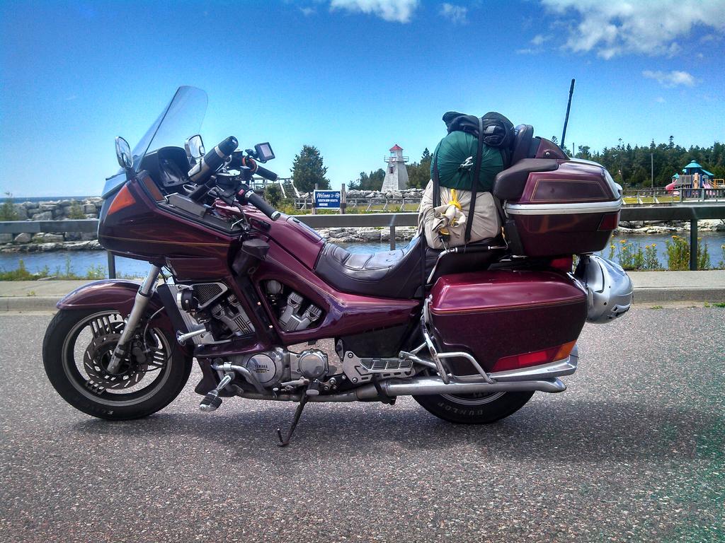

saddlebum Posted February 3, 2019 Posted February 3, 2019 (edited) I used Plastex also known as PlastiFix to repair any of my cracks. I even used it to join a bottom and top half of two different side fairings to make one good one. I embed a couple of layers of Fiberglass drywall tape as I build it up to improve strength (I add fiberglass drywall tape to JB weld sometimes for the same reason). Any way the repair was strong enough that when the bike dropped of the work table this summer, 10 years later there was absolutely no indication of failure and to this day no buddy has been able to tell were the joint is (I'm not even sure I can tell exactly anymore and I did the job). Edited February 3, 2019 by saddlebum

saddlebum Posted February 5, 2019 Posted February 5, 2019 (edited) As I stated before I used a mix of plastifix and fiberglass drywall tape to make one good fairing out of two good halfs. the repair remained flexible enough that ten years later when my bike fell off my fully elevated bike table it sustained absolutely no damage. If that is not flexible enough for you then I don't know. As far as cost goes I spent a total of about $200.00 for 2 large plastifix kits and considering the results, was money well spent. Secondly follow these steps I posted for slow roll and you should see minimal paint damage almost to the point of nothing more than a slight almost invisible fill mark to the original crack: {{ Put a layer of putty or clear packing tape over the crack on the outside I use clear packing tape and rub it in real good to eliminate air pockets. Then gouge/bevel the crack out on the inside about 3/4s of the way through the plastic and so it opens about 1/4 inch wide at the surface, take care not to penetrate completely to the outside surface (I use a 1/4 inch round ball burr on a Dremel tool for this). Fill the crack with plastex/plastifix using the stitch method which is explained in the instructions that come with the kit. Once it is built up flush with the inside surface cover with a piece of fiberglass dry wall tape. Wet the area down with the liquid solution then sprinkle powder on it and then wet the powder. keep alternating until the tape is covered. At this point you can either let it cure or add additional layers of tape and plastex to build it up until you feel satisfied. Once the curing is complete peel of the tape from the outside. If the tape was sealed down well their should be no trespassing on the paint job. At best you might notice an extra fine black web line }} Regarding the cost I feel it well worth it and if you use it correctly it actually does go a long why. Consider my scoot was a total wright off and I totally restored the bike to like new condition. The plastex even sands baby butt smooth and you can touch up and sand as often as needed to pull off a perfect surface for painting (no spot putty required what so ever). Here are some before and after pics. The hard part was spending a season rebuilding and painting the bike instead of riding it. Edited February 5, 2019 by saddlebum
