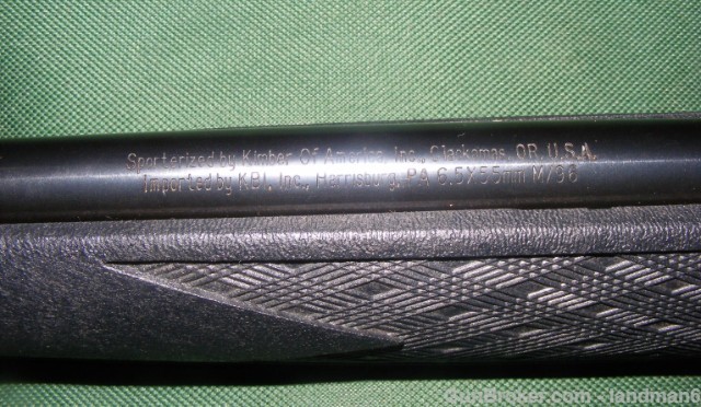

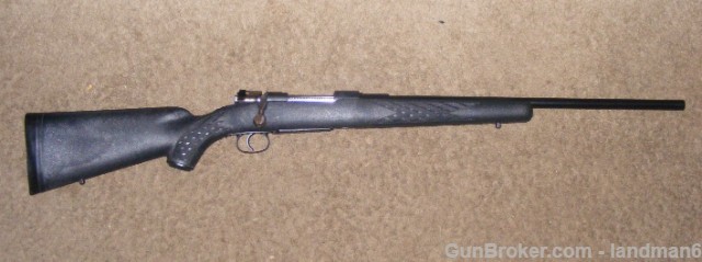

I picked up this Custom Kimber in 6.5x55 Swede made with a '96 Gustoff Mauser Action. It was built when Kimber was in Clackamass, OR. Not anywhere as nice looking as yours Jeff, but still pretty neat. Most if not all of my Mausers are drilled and tapped. Never realized it was that much of a problem?? Here's a couple of pics.

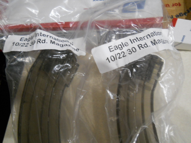

My son in law called this morning and says,, DAD - GUESS WHAT - THE CALIFORNIA HI CAP MAG LAW HAS BEEN FOUND UNCONSTITUTIONAL!!:usa::usa::usa::usa:
Apparently there is absolute truth to what he was telling me as some of the big vendors have already dropped California from their "Can Not Ship To These Socialist States" restrictions.
My response to my son in law went something like this: THAT is OUTSTANDING in a genuine, gotta LOVE being a Constitutionalist kinda way!! So,,, what do you got laying around that's quick release Magazined that your gonna be grabbing mags for before the RUSH starts. His response: Ruger 10/22 but the rush is already started Dad, Brownells is backlogged from here (Sac) to your house..
Note to all interested in Hi Cap Mags (over 10 rounds, 10 Rounds has been the max in California),, might not be a bad idea to grab what cha need BEFORE this really goes nuts out there in the market place!! :missingtooth::stirthepot::stirthepot::witch_brew::witch_brew::happy34:
YEEEEEEEEEEEEEEEEEEEEEEEEEEEEE HAWWWWWWWWWWWWWWWWWWW!!!! :dancefool::dancefool::dancefool::dancefool::clap2::clap2::clap2::dancefool::dancefool::dancefool::dancefool:

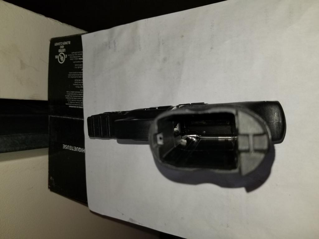

My newest edition to my collection is a S&W M&P 40 I have not taken it to the range yet but I will this weekend and compare it to my Glock 22 I can tell you already the ergonomics is far better than the Glock and if it shoots as well I will sell the Glock.M&P40.jpg

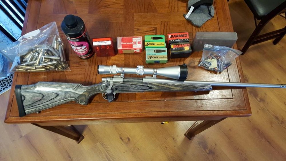

My Rem 700 ADL, Stainless Steel, 7MAG deer gun is showing its age. It has devoured thousands of rounds over the years and the throat is pretty well shot. I have been debating with myself whether I should replace it with a new one, or rebuild and accurize this one. If I rebuild it it will cost about the same money as a new one and it will effectively be a new gun. If I go new I can probably sell this one for $600-$700 to recoup some of the costs. It looks like new on the outside, But the group size had opened from 3/4 MOA to about 1.5 MOA. For most deer hunters this could still be the most accurate gun they ever owned. I have sold my "worn out" deer guns before and the buyer was always super happy with it.
Rebuild would include;
Recut bolt face to square it up.
Recut lugs to square them up.
Remove barrel and get a blank barrel to make for the gun, which would include cut taper, threads, crown, and chamber.
A new glass stock, that would have to get aluminum bedding.
Bigger recoil lug.
Reface receiver face and locking lugs.
New scope.
Either way will be around $2K, and be a wonderful gun.:mo money:
What to do? What to do? What to do? What to do?
I know, I know, If in doubt do both........... but........:mo money::mo money:

NICE!!!! I've had the hots for one of those for quite a while now. The only problem is it's not on the CA Roster so the only way to find one is buy it from another CA resident. And of course because it can't be imported from out of state they get pricy.... They pull $750+ for a clean used one... Hopefully the SCOTUS will declare the damn roster unconstitutional....
In my opinion it is a no brainer. Upgrade and save your labor and frustration. :backinmyday:
:farmer:
The "labor and frustration" are half of the fun. I am not a machinist by trade so to me doing all that machine work is a blast and just as much fun as the shooting part. (or does the blast come later???)
That and when I am done I will truly have a one of a kind custom rifle that I can say "I made this". True the deer do not care much either way. :whistling: They taste pretty much the same whether I use a store bought or custom rifle.
I read into your post that you were leaning toward a new firearm. I was just giving you encouragement. My bad. Drill and mill away my friend. I am not so inclined since I don't have the skill set.:backinmyday:
:farmer:
I do not have a lean yet, As I mentioned maybe the proper path is to buy a new one for the instant gratification part and then can take my time building the other one.
Last night some one made me such an offer on a very low miles Ruger, in 7 MAG with a good scope and even a muzzle break.
