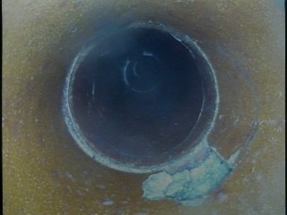

Flyinfool Posted January 14, 2019 Author #26 Posted January 14, 2019 Well the pipe is nice and clean now. The hydro blaster cleared out what 5 hours of snaking could not touch. Follow up with the camera did reveal 2 holes in the pipe. Note the location of the water, the camera just happened to be nearly upside down at this point in the pipeline. This first pic is right smack in the middle of the basement floor. This second pic is right exactly as the pipe is going under the outside foundation. Or if you like sewers, here is the vid of the camera on the way out, The whole vid was to long. Now the good news is that the pipe damage is not severe. Te bad news it is still there and needs to be dealt with. I have sent the camera vid to several places that do repair to start getting quotes, the plumber that did the hydro blasting and the work so far has quoted a trenchless reline at $3500 complete. I asked him what if I brake the concrete and dig the hole and then place the new concrete. He dropped his price to $1800. BUT AT LEAST I CAN FLUSH FREELY AGAIN!!!!!

Flyinfool Posted January 22, 2019 Author #33 Posted January 22, 2019 Well all of the quotes are now in. All of the "trenchless" methods run from $9800 to $13,500. They all still require a hole to be dug in the basement floor. The one low bid that I had was from the original plumber that cleared the line and did the camera work. His plan was the same as mine, to push 4" PVC down thru the 6" clay line. He did not think that the 2 small bends would be a problem. His quote was the one for 3500 complete or 1800 if I do the hard part. The angle of the bends is about 10° and there is 12 feet between the bends. According to my math, a 4.215 dia pipe going into a 6" dia pipe will need to bend at about a 40 foot radius to get around that bend. I went and bought a 10 footer of the D2729 sewer pipe to play with and that comes out to the 10 foot length being able to be deflected 4 inches at the center. I was able to deflect it that far repeatedly with no damage. I also found that a hair drier blowing down the pipe heating it to about 120°F also made that small deflection much easier. I am back to leaning toward me just doing everything for an all in price of around $1000, This would include me getting some new toys like a small rotary demolition hammer, and a real drain camera and a new 5 foot farm jack. OK so most of that price will be new tools..... I get to keep the new toys (I mean tools) after the job is done. I do have another job in progress that the Rotory hammer will be VERY handy for. I would be digging a 12 foot x 2 foot by 2 foot hole in the basement floor and using the 10 foot sections of pipe instead of cutting it into 5 foot sections. If the pushing gets hard I will also get a 5 foot long farm jack to supply more push power. The weight of the pipe will only be about 50 lbs and the last section will not even need to go into the old clay. I have already started to make some special tools for this job. First is a disk that will fit into the end of the pipe to give me a solid surface to push evenly on and spread the force evenly over the end of the pipe. It will also have a hole in it to feed the camera thru so that I can see the end of the pipe as it goes. This will allow me to stop at exactly the correct spot where my lateral joins the city sewer. I do want to line all the way to the very end of the lateral but I do not want to stick out into the city sewer at all and possibly cause a blockage there. Second will be a U shaped piece to hold hold against the flared part of the pipe to prevent it from pushing into the clay pipe while I am gluing and pushing on the next piece of pipe. If the joint slide in before I am ready I will not be able to tell if I have the joint fully engaged. I have not decide yet on my course of action, But like I said I am leaning to me doing it all. IF I hire it out it will be the $3500 deal with the pro doing everything. The hard part is the digging part. If I feel that my health will hold out for that long then I can dive right in, But my health issues are the one unpredictable part right now. I hate to get half way and be unable to finish. Geeze, everyone has always called me a heartless old bas...... How can that nonexistent li'l thing be causing me so much problems right now? It is still an option that a pile of PIZZA, Ice Cream, and some cold drinks, and maybe even a batch of RUM BALLS (for desert after the work), will make short work of digging the hole.
