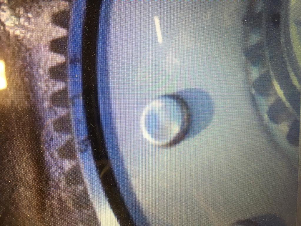

Treb Posted December 15, 2018 Author #6 Posted December 15, 2018 This part number matches but is there any way to tell for sure it's the right one? I can't make out an I anywhere on it. https://www.ebay.com/itm/NEW-OEM-1999-2013-ROYAL-STAR-VENTURE-V-MAX-YAMAHA-PRIMARY-GEAR-DRIVE-PART-4XY/254025113572?hash=item3b25139fe4:g:hScAAOSwV0VcAqW4:rk:1:pf:1&frcectupt=true

Treb Posted December 15, 2018 Author #11 Posted December 15, 2018 BlueSky said: Bike Bandit has it https://www.bikebandit.com/oem-parts/detail/yamaha/4xy-16150-09-00/b1200808 So does partzilla or they can order it for you https://www.partzilla.com/product/yamaha/4XY-16150-09-00 Yep I saw those last night....so if I can't find one cheaper there is always that. Still a little unclear on where exactly the "I" is supposed to be. I read one post that said it was hand stamped or engraved? If I'm gonna shell out 300 bones for the letter I then I wanna see it on the part somewhere!!!
BlueSky Posted December 15, 2018 #12 Posted December 15, 2018 Yeah, we've had this discussion before on the forum. I think Freebird was the last person to say that he wouldn't shell out the bucks for the new basket not knowing for sure it was an "i" basket. Freebird solved his clutch whine problem by selling his RSV and buying the new 2018 Super Duper Venture. I researched the forums about the clutch whine a while back and I found one thread where the RSV owner said he found out exactly how to get rid of the clutch basket whine. 1. Switch brands and viscosity of oil. 2. Purchase i basket and replace the original. 3. Trade the RSV on a Goldwing!!!!

Mike G in SC Posted December 16, 2018 #15 Posted December 16, 2018 I had a talk with Mike Eykamp (Diamond Cut Guy) the other day about the baskets and the whine. He educated me on the I & G baskets. Just ordering by part number will not necessarily get you a I or G basket, which seem to be less likely to whine at normal speeds. The baskets came down different production lines, thus the alpha designations. The parts are etched with a few characters designating the line it was manufactured on. The I or G baskets were not engineered different, just cut on different production line. Some smart cookie years ago determined some production batches whined less than others. So, the I and the G baskets seemed quieter. If a request was specifically made by a dealer for an I basket, the warehouse would look at the etching on the baskets to find and ship the requested basket batch. See attached picture of a G basket. But I do remember years back when bikes were new and warranted, the dealers and Yamaha would say "no guarantee" that swapping a basket would remove the whine. But they would try. My old RSTD had the whine and the basket was swapped and it went away. (I also got another RSTD with a bad whine, and swapped baskets between my two bikes, and the whine moved.) So, to me, the basket swap worked. I will comment that the whine was more prevalent on bikes before 2009, less prevalent since then. (So, maybe a newer basket wont whine,,, just guessing.) Mike E. sells a lot of parts, and is on this VR forum. As of the other day, he still had one or more used I or G baskets on his Facebook page for about half of new price. (They are not a wear part so used is good as new.) I know he sold one last week. You might contact him. But, like Yamaha said, he will not guarantee the swap will remove the whine. See attached...
Treb Posted December 17, 2018 Author #16 Posted December 17, 2018 Thanks Mike I just sent him a message on FB
BlueSky Posted December 17, 2018 #17 Posted December 17, 2018 Mike G in SC said: I had a talk with Mike Eykamp (Diamond Cut Guy) the other day about the baskets and the whine. He educated me on the I & G baskets. Just ordering by part number will not necessarily get you a I or G basket, which seem to be less likely to whine at normal speeds. The baskets came down different production lines, thus the alpha designations. The parts are etched with a few characters designating the line it was manufactured on. The I or G baskets were not engineered different, just cut on different production line. Some smart cookie years ago determined some production batches whined less than others. So, the I and the G baskets seemed quieter. If a request was specifically made by a dealer for an I basket, the warehouse would look at the etching on the baskets to find and ship the requested basket batch. See attached picture of a G basket. But I do remember years back when bikes were new and warranted, the dealers and Yamaha would say "no guarantee" that swapping a basket would remove the whine. But they would try. My old RSTD had the whine and the basket was swapped and it went away. (I also got another RSTD with a bad whine, and swapped baskets between my two bikes, and the whine moved.) So, to me, the basket swap worked. I will comment that the whine was more prevalent on bikes before 2009, less prevalent since then. (So, maybe a newer basket wont whine,,, just guessing.) Mike E. sells a lot of parts, and is on this VR forum. As of the other day, he still had one or more used I or G baskets on his Facebook page for about half of new price. (They are not a wear part so used is good as new.) I know he sold one last week. You might contact him. But, like Yamaha said, he will not guarantee the swap will remove the whine. See attached... That information is very interesting and I don't doubt it. But, currently you can order either of two clutch baskets. The "old" part number 26H-16150-10-00 $256.90 costs less than the "new" part number 4XY-16150-09-00 $308.09. If you look up the clutch basket on partzilla, you will find the 26H-16150-10-00 part listed for all years, 99 to 2013. I talked to someone at partzilla and I was told they could order either one and both had to come from Japan. He also said that the 4XY-16150-09-00 part number was not listed as a replacement part for the old part number. So far, I have not been able to find out why the new part number is available and what it if anything is supposed to do for you. One could assume that it was designed to eliminate the whine but nobody I've talked to can say that. I also called bike bandit and asked about the new part number. They told me that the new part was supposed to be a replacement part. Soooo ?????????????????

eusa1 Posted December 17, 2018 #20 Posted December 17, 2018 the part numbers are for the same part, the number has been superseded and the price increase accordingly. there is no design change and as Mike G has stated they were cut on a different production lines. Now that the rsv is no longer in production, we don't have the luxury of getting one pulled off the line to obtain the certain letter. they produce them on an as needed back order basis now and the only way your going to locate a certain letter now, is to have a parts warehouse guy open each and every box and have a look at the backside of each gear ring or learn Japanese and find better contacts than i have . or find a used one. $.02 Mike
