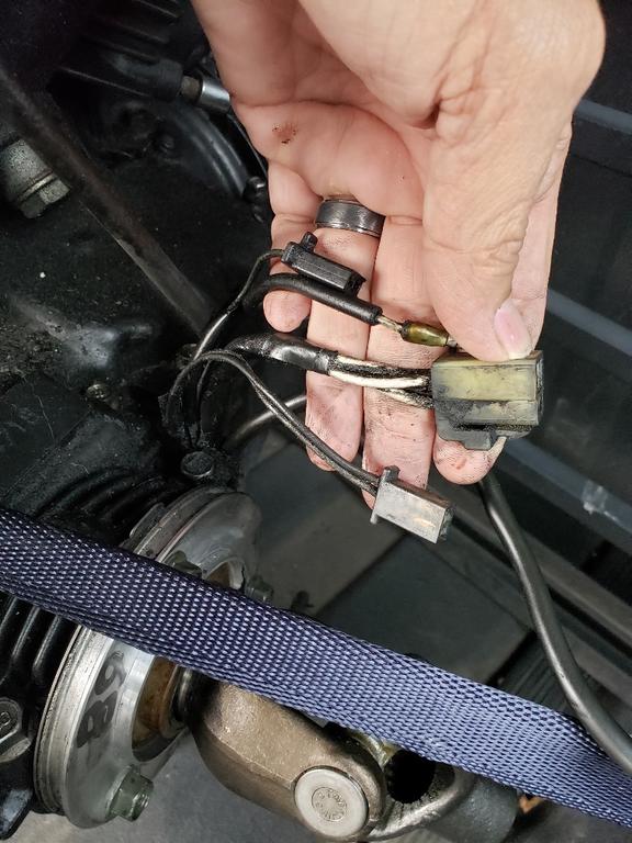

Phrog Posted January 13, 2020 #33 Posted January 13, 2020 Soooo, Did they change wire connectors on some of the RSV's? There's 4 wire bundles that come out near the drive shaft (pictured). The wires run under the engine somewhere but I haven't tracked where yet. Question is the wire connectors pictured, did they change for different years/models? I tried for about a 1/2 hour to connect these to the connections under the battery box before I figured out that 2 of connectors are not the same as what was on the original engine. Grrrrrrr!!!

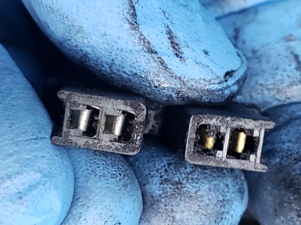

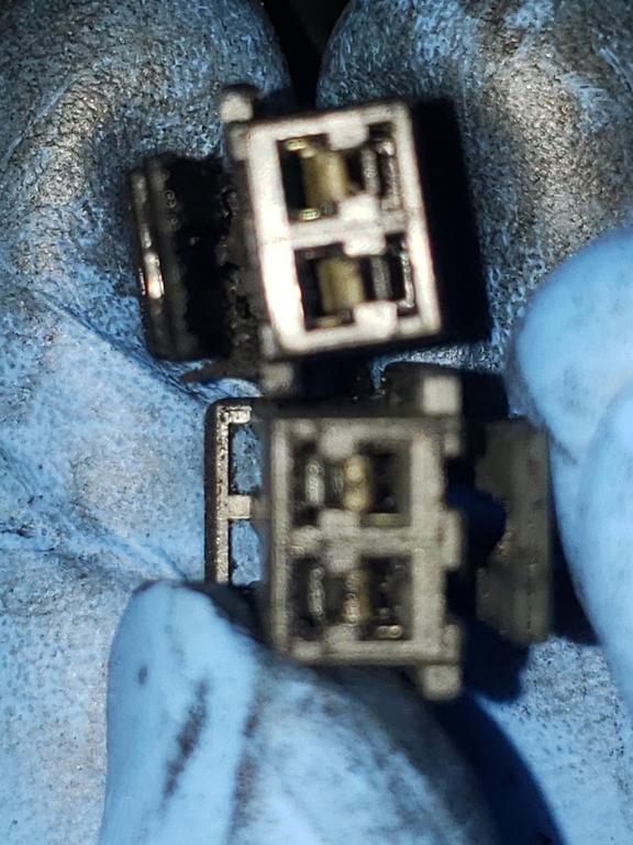

Phrog Posted January 14, 2020 #35 Posted January 14, 2020 Freebird said: As far as I know, they never changed. I didn't think so either, Total of 4 clips, 2 connected without issue, but the other 2 were different. Supposedly both engines from 2005 RSVs. Original Engine: Replacement engine: I guess I either need to splice in the correct clips, or try to track them back under the engine. I'm really not sure where they go or what they're for.
Phrog Posted January 15, 2020 #37 Posted January 15, 2020 (edited) Marcarl said: What is the color on the wires? Black... all black. Wait, that's just the dirty greasy grime. Black clip has 1 black and 1 white wire White clip has 2 that are different shades of green... maybe 1 mint and 1 kinda seafoam green? I was hoping to just remove the clips and just swap them, but I think I'm gonna have to cut and splice. Good thing is that both engines have the same color wires coming off, only the clips are different Edited January 15, 2020 by Phrog
Marcarl Posted January 15, 2020 #38 Posted January 15, 2020 By my chart for 99-09 Venture. The white serves, Speed sensor, Cruise, Master Control, Flasher relay. Now for the other wire,, the greenish ones there is a choice of: Black,Brown,Chocolate, Dark Green, Green, Gray, Blue, Light Green, Orange, Pink, Red, Sky Blue, White, Yellow. Those are all the solid colors listed. Check to make sure that there are no tracer colors on those wires.
