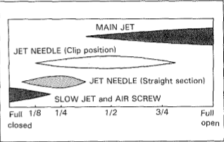

Marcarl Posted November 15, 2018 #5 Posted November 15, 2018 Maybe some to help understand what is happening as you go along. During idle, the primary circuit has all the control over fuel mixture, well nearly all, but as you open up the throttle plates the secondary or running circuit has it's input. The higher the rpm, the less percentage the primary, or idle circuit has an impact. It never cuts out, just has less of an effect. Sooo, when in idle mode, the primary circuit and it's adjustments has a profound effect on the running, but once over 1500 rpm, not so much, it's all on a percentage basis. Air mixture settings have very little to do with running down the highway, but a lot to do with sitting still and moving on from standstill. It also come into effect when the throttle is released and the throttle plates close, because then the primary circuit is the only one working. Keep in mind, that the circuits are more governed by the throttle plate position than the engine rpms. Hope I'm right and this helps.

Treb Posted November 15, 2018 Author #7 Posted November 15, 2018 (edited) Marcarl Yes I understand how the jets overlap in duty as the throttle is opened. Here is a little graphic that that popped up on another MC forum that shows it quite nicely. As far as a pic of the pilot jet adjustment screw location...Its not easy to take a pic of it while the carbs are on the bike, Heck it's even a challenge just to get a screwdriver on them. You have to look thru underneath the carbs to the back of the opposite side and it's a cross tip brass screw so you can use a flat tip from vertical or horizontal. P.S. If they haven't been adjusted they might have some brass caps on them that you have to remove. Edited November 16, 2018 by Treb
