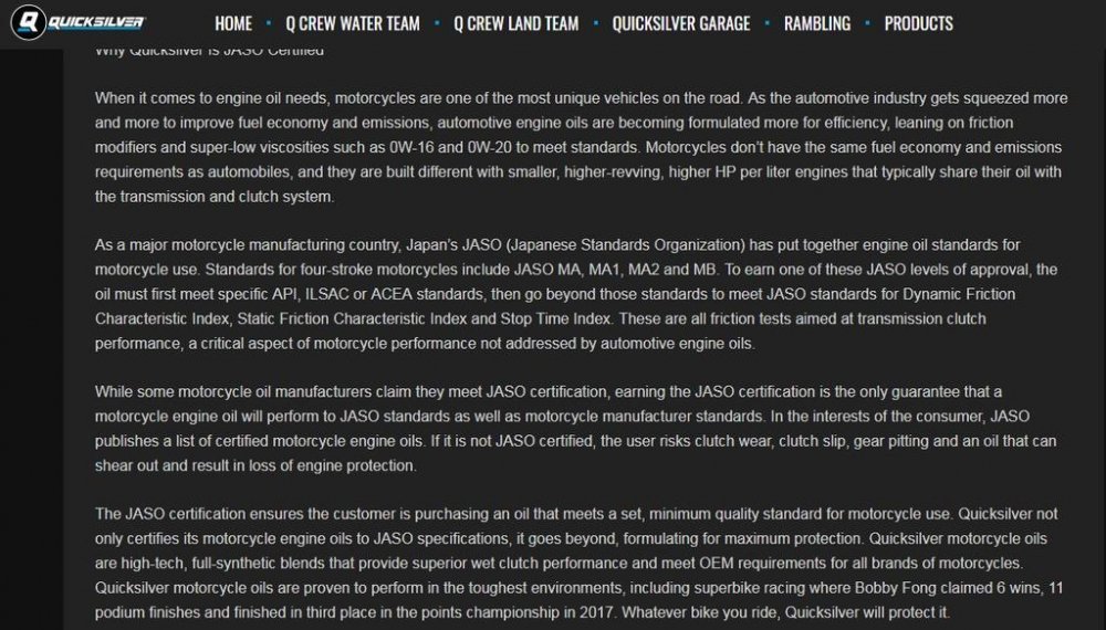

Du-Rron Posted November 9, 2018 Author #5 Posted November 9, 2018 (edited) Yea, it's a strange list. Mobil 1 isn't listed except in Mexico. Amsoil and Royal Purple are neither mentioned. Doesn't seem to be very applicable to North America. At least not north of Mexico. The JASO organization http://www.jalos.or.jp/ only published those that had: Paid the fees, and return the confirmation letters. (Starting about 4.6 in the JASO application process). This is at least the 4th month we have not seen ROTELLA on the list because that is how long I have been looking at it. Amsoil and Royal Purple I dunno.... (see below in the 1st pic where it says that, ".. they are publishing only those that have returned their confirmation letter.") Quicksilver and Yamalube are on the list. Quicksilver mentions in their advertising about companies that advertise JASO compliance but they are not really and I shot a copy of that in the thread where I was going to Quicksilver from Rotella. https://www.venturerider.org/forum/showthread.php?138309-Quicksilver-Oil-10W-40-amp-20W-50-JASO-rated (see the quicksilver advertisement that mentions companies not really being jaso rated even though they say they are) Edited November 9, 2018 by Du-Rron
