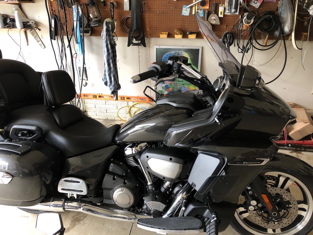

Would you mind posting a pic of your risers AND a pic from the side showing how much gas tank cover clearance you have?

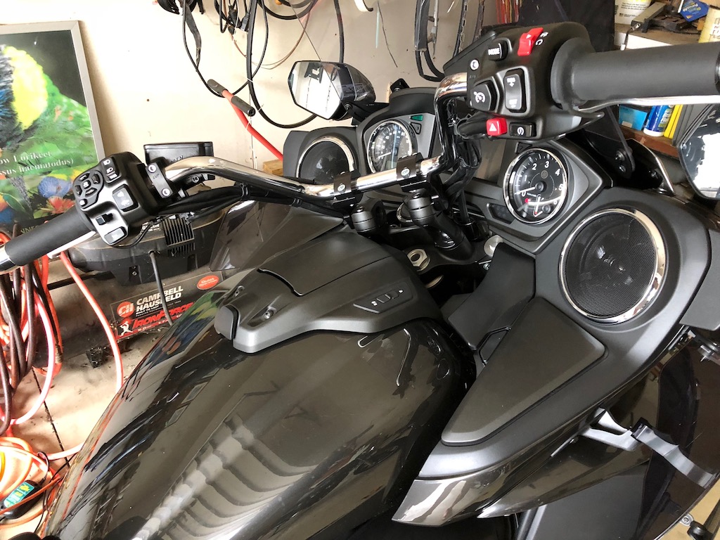

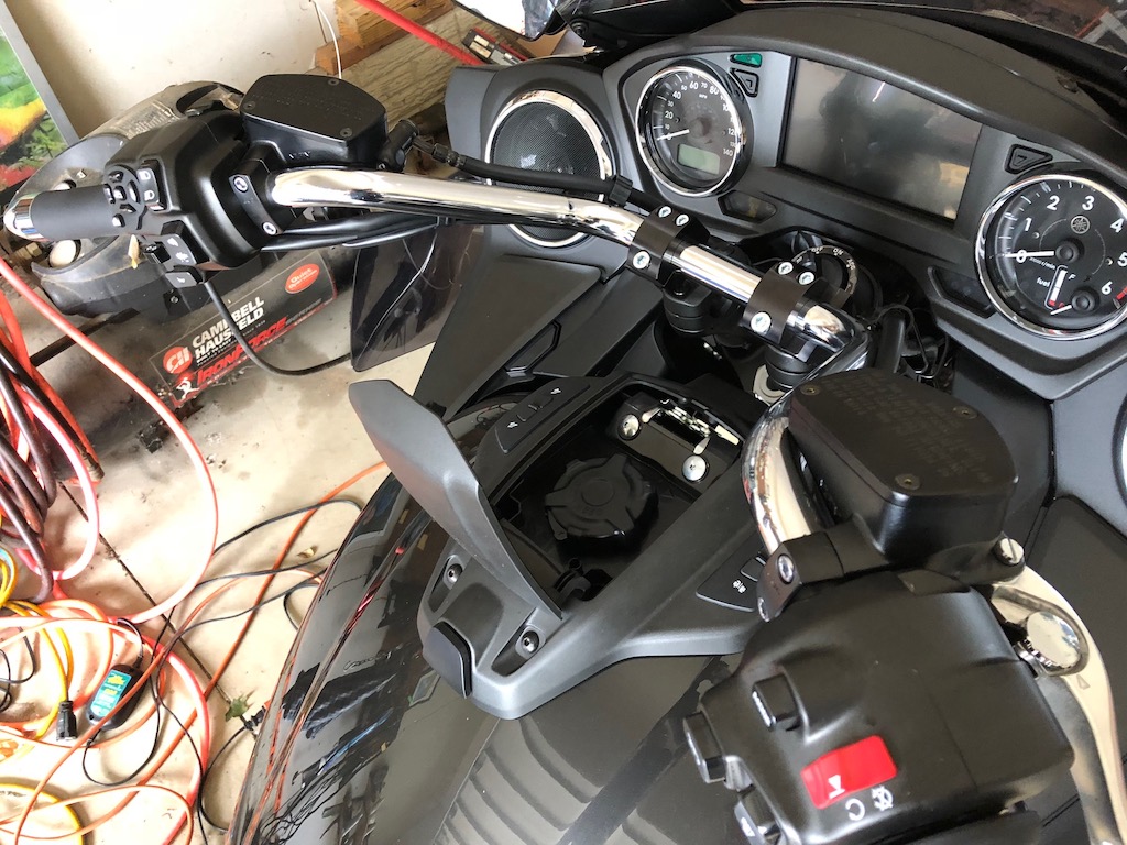

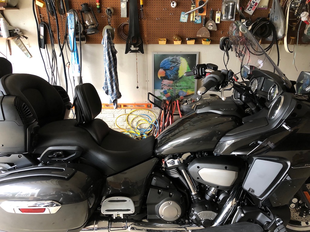

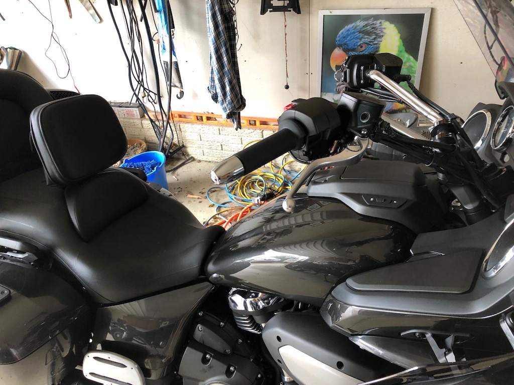

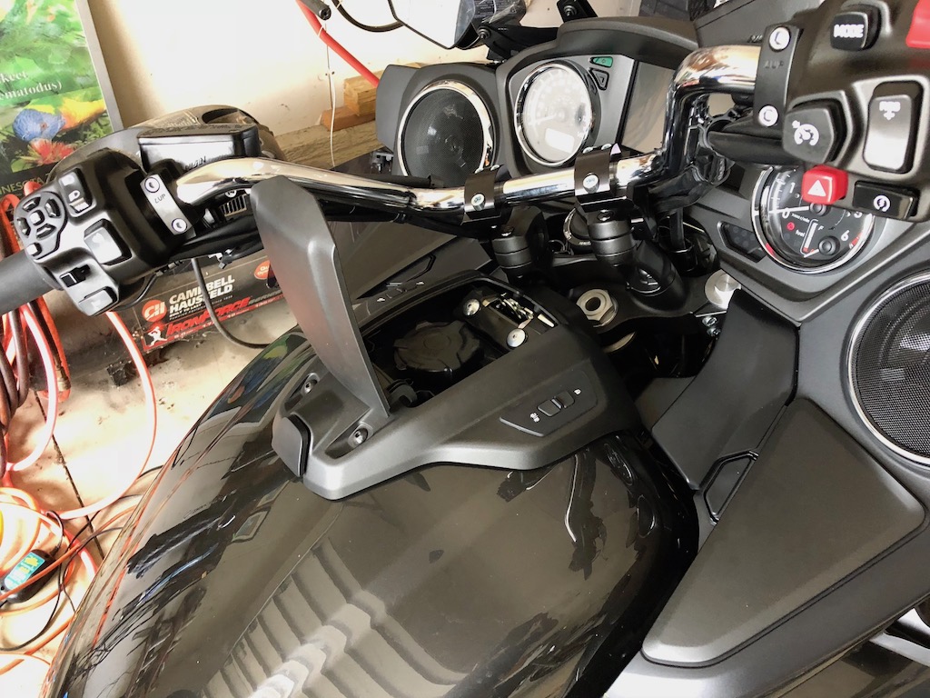

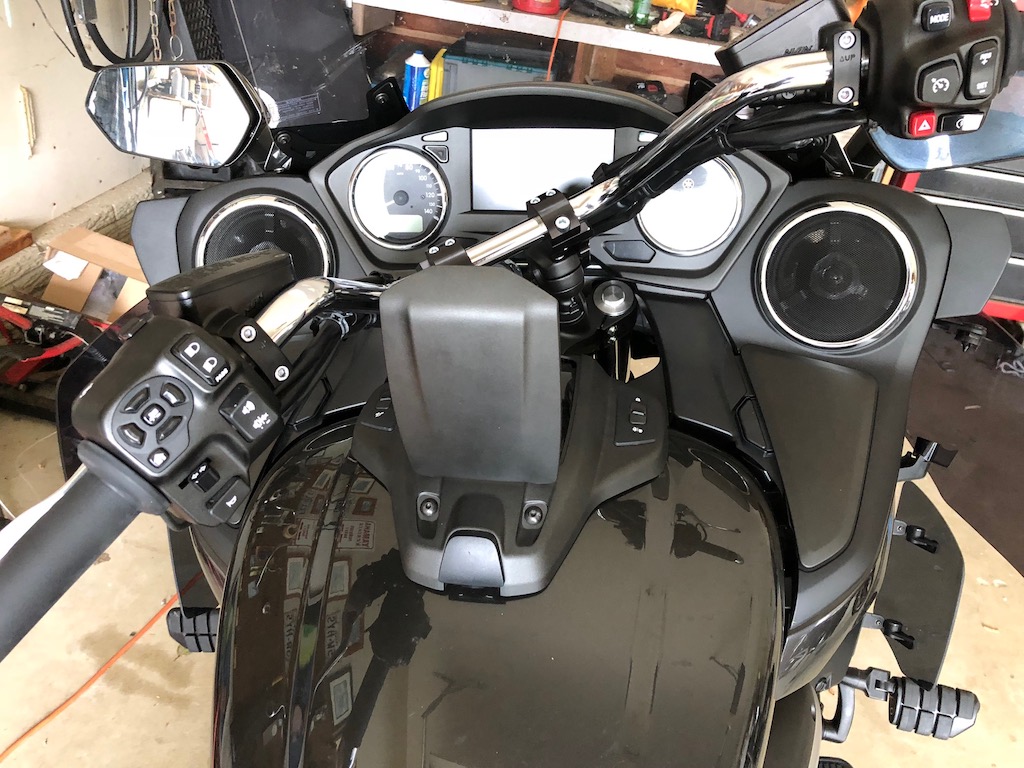

Here are some pictures. Hopefully, they will help a bit. It took me literally 10 to 15 minutes to install them and get them adjusted as I wanted them. They actually provide more pullback than the Flanders bars that I had on the '99 RSV or the RSTD bars that I had on the '05 RSV and certainly more than the bars that I installed on the Ultra Classic. These risers are about as perfect as they can be for me.
A couple of the pictures who the gas compartment fully opened with the handlebars at full lock. I suppose if you rotated them down further, it could cause an issue but I set these where I liked them before even reading about the issues with the gas compartment door interfering. Then I went to check and found that mine doesn't hit at all. I have gassed up a couple of times since installing them and there is no problem at all.

Thanks Don. It doesn’t look like you have them back very far at all.

I will try to get a good measurement later. I'm guessing about an inch. I can tell you that it makes a HUGE difference whatever it is. I have room to move them more should I need to but really don't think I need to.
I should add that they are probably an 1 1/2" higher also. That along with the pullback makes a big difference. I no longer feel that I am reaching at all.

I understand the “reaching” feeling. Currently if I want to lean back to relax, I have to hold the ends of the bars. Can’t say I like that. I’d ask how it feels in steering handling compared to stock but I don’t think you really put a lot of miles on in twisty’s to get a solid feel. I’m sure there’s some difference because it changes the pivot point.
Maybe you could share your thoughts on this?
Yea, you are right, I really haven't had much of a chance to try it in the twisties. Only a few miles. I can tell you that it handles fantastic though. I see no downside to it at all.
