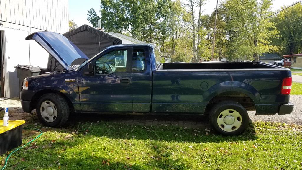

luvmy40 Posted October 7, 2018 Share #1 Posted October 7, 2018 I had about $300.00 in petty cash set aside for some upgrades and repairs on The Beast this down season. I used it today for a down payment on a 2007 Ford F150 long box. I really needed a "new" truck. My POS '96 Ford Ranger was on it's last legs. Hell, it'd been life support for the last few years. Besides, getting the Venture in the bed was darn near impossible and it looked really funny when it was. Any Ford folks? I have a couple questions. This is the XL package with the 4.2 L V6, manual 5 speed transmission and no frills. The steering wheel has the cruise control buttons but they do not work. Does the manual version actually have CC or is this a replacement steering wheel? The E Brake does nothing. I think I have found out why in a cursory web search but if anyone here has any insight or words of wisdom, I'd love to hear from you. Not the best pic, but here she is. There's some rust over the rear fenders, but not rotted through. There are a few spots on the front corners of the hood that don't have any rust, but the paint is flaking off an the clear coat on the doors, over the windows is peeling. Not bad at all for a 12 year old truck in Ohio. The frame is solid, suspension is good, steering is tight and the engine runs quiet and strong. Looks like a brand new alternator and passenger side lower control arm. Link to comment Share on other sites More sharing options...

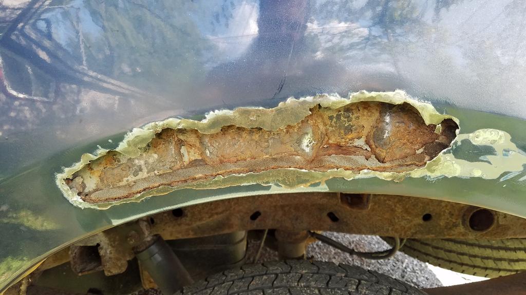

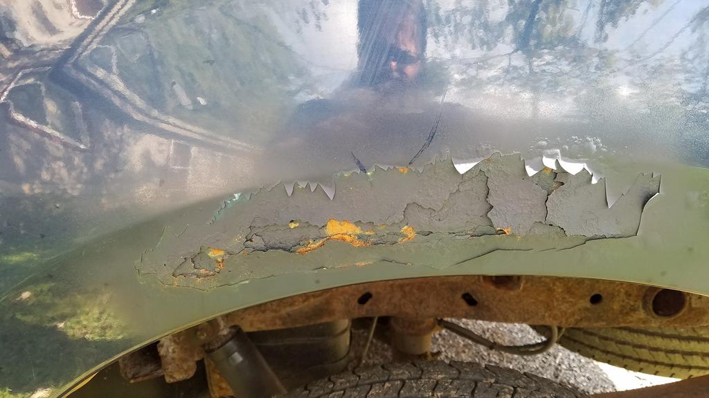

luvmy40 Posted October 7, 2018 Author Share #13 Posted October 7, 2018 Well, the rust on the fenders is worse than I'd hoped at first glance. After flaking of the loosest paint, And after hitting it with the wire wheel, This is going to take more than a bit of bondo to smooth out! Ah well, what's that old line about plans, mice and men? Link to comment Share on other sites More sharing options...
Kybigmac Posted October 7, 2018 Share #14 Posted October 7, 2018 I work part time at an auto auction and we get a lot of vehicles from up north,and the ones from Ohio seem to be the worst! I’ve often wondered if they spread salt 24/7 365 days a year.😎 Link to comment Share on other sites More sharing options...
slowrollwv Posted October 8, 2018 Share #15 Posted October 8, 2018 Looks like it has had some work in that area before. Best way to fix it is with replacement panels. If you were closer to me I would do it for you. Link to comment Share on other sites More sharing options...
Freebird Posted October 8, 2018 Share #16 Posted October 8, 2018 I agree that Ohio vehicles seem to fare worse than a lot of other states. That's why I typically won't take the bike out after the first salting of the season and until after the first few rains in the spring. It is also hard to avoid rust if you are buying a used vehicle here. I'm not surprised that the rust was worse than it appeared. That seems to be the case most of the time. If you can actually see it, what you can't see behind it is typically worse. It looks like you did OK with the purchase though. I've looked at used trucks over the past few months and am always shocked at what people think they are worse. I see trucks with close to and over 200,000 miles on them and "very little rust" advertised and they some folks want $15,000 and UP for them. If I can see rust, it's NOT worth that kind of money regardless of the miles. Link to comment Share on other sites More sharing options...
djh3 Posted October 8, 2018 Share #17 Posted October 8, 2018 My experience with the rust, all be it limited here in Fla is if you can see it popping out its probably 2 to 3 times worse under where you cant. Figure the water/salt/mud cakes on inside of fenders and lays there. When I lived in Oklahoma the mid 80's Chevy trucks where bad about the rears loading up and rusting thru. Link to comment Share on other sites More sharing options...

EtRider Posted October 9, 2018 Share #20 Posted October 9, 2018 Sorry, wasnt me with the lift a ma jig. I have seen lifts like that advertised many places. One is [h=1]Rampage power Lift Motorcycle loader.[/h] As far as your rust, where the inner and outer fender skins meet in the wheel well, Ford never sealed the gap with anything so salt , dirt and anything else could accumulate there. That is why they rust out so bad in that area. My old 2008 F150 did same thing before I traded it. (not that bad thou). Ed Link to comment Share on other sites More sharing options...
