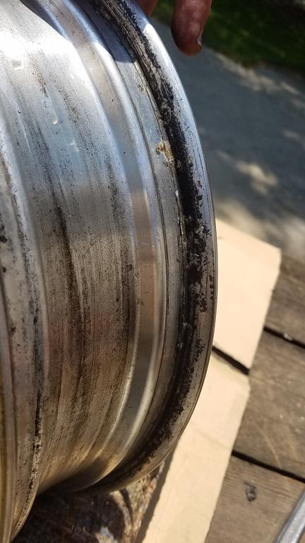

MiCarl Posted September 30, 2018 #7 Posted September 30, 2018 The dot doesn't need to be lined up with the valve stem. That is done on the presumption that the valve is the heavy spot on the wheel. I check alloy wheels before I mount tires. On ribbed cast wheels like the 1st gen ventures have the heavy spot isn't anyway near the valve at least half the time. You should have it re-balanced once you solve your leak issue. Check to see if it's leaking at the bead. It's not unusual for 30 year old alloy wheels to have some crud build up that keeps the bead from sealing.
videoarizona Posted September 30, 2018 #8 Posted September 30, 2018 Check to see if it's leaking at the bead. It's not unusual for 30 year old alloy wheels to have some crud build up that keeps the bead from sealing. Yep. This is what @cowpuc and I found when we replaced my rear tire that collected a nail. I did get on the case of the manager of the store that did the tire install about their guy NOT cleaning the wheel! My temper was not held in check....not with my life on the line... What bothers me is that the Shinko 777HD went over 3K miles like this with all the crud on the inside bead area of the rim. I was lucky...

dna9656 Posted October 1, 2018 #11 Posted October 1, 2018 (edited) I JUST WENT through the thought process of just how clean the bead area of the wheel has to be TODAY! I am moving one tire from one wheel to another... What to use to clean it with, etc. I noticed the wheel has a Phonograph finish so that told me Yamaha wanted that finish to promote the sealing of the bead(?) So in the end I wire brushed (by hand) the bead area and the in tire (arg, arg, arg) wheel area that's inside the tire absolutely clean. I tried some WD-40 in an effort to dissolve some of the rubber, then THOROUGHLY cleaned the area between the bead walls with Brake (leaves no oil residue) Clean 4 times to be sure no lube was left. Conclusion: A wire brush and elbow grease is prolly the best tools/method to use for this job. The WD-40 helped but not that much. I thought about a wire brush on my drill but that would tend to polish the metal (at least that's what they (I'm a marine painter) teach at work so I stuck with what works... I had to relearn how to change a tire; back in the day I hung out at gas stations that did repair work, sold a few tires, a LOT of $0.35 a gallon gas when gas went to $0.60 (OMG!) a gallon....etc...I had a Coats 20/20 tire changing machine and good ole tire lube. I got some lube (Bull Snot) on the M/C tire and it came off AHELLOVALOT easier! Tomorrow I"ll re-install the good tire using Bull Snot (tire lube) it's slicker than snake snot on a door knob! I was taught not to use anything but approved tire lube... Some guys on the You Tube use dish soap, some kind of soap... Too scary for me!..... Edited October 2, 2018 by dna9656
