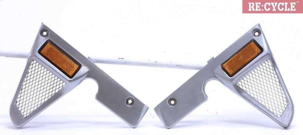

Just had this last month on my 86. Remove the aluminum colored trim piece trim piece from the right side of the radiator, and it is right there up high. A little contact cleaner and slid it back together and was good to go. About 10 minutes.

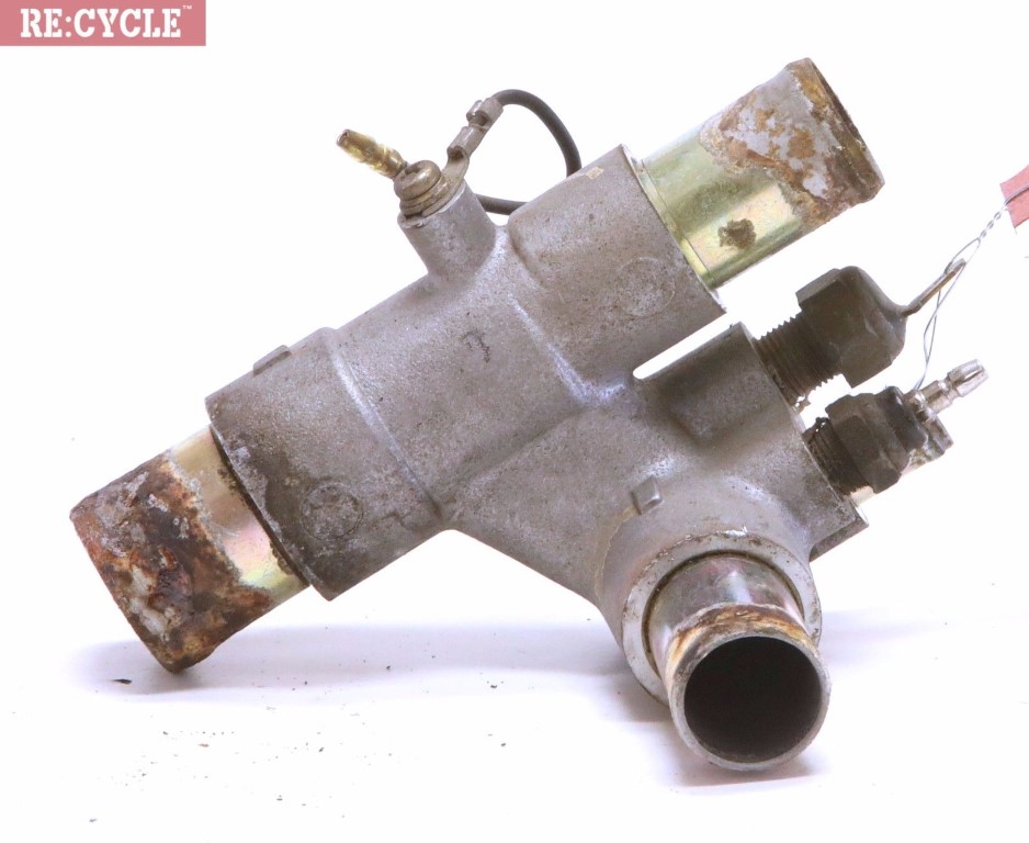

This is the coolant joint coolant joint (Medium).jpgand it is located under the right side of the bike right behind the radiator side cover trim radiator side cover trim (Medium).jpg
If you notice the single round pin on the lower part of the coolant joint, that is where the temp gauge connects. Make sure it is clean and the connector makes a tight connection and see if that fixes your issue.

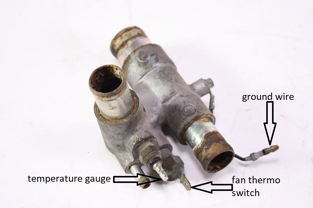

So is it the wire that is attached to the solid ‘probe’ on the bottom of this part? I know folks said it’s a blue wire, but mine seems to be green. I popped the wire off and shot some cleaner up in there and put it back on. I’ll fire it back up in the morning and see if the gauge reads once warm.

The thermometer wire is green with a red stripe on the 1988 (and others). In addition to cleaning the bullet connector, crimp the female part of the connector slightly to tighten the connection. Clean the male part of the connection as well. Trace the wire to the instrument cluster and insure that the connection at that end is good. Check for continuity from the thermo-unit end of the wire to the instrument cluster end. Check for 12 volts at the thermometer/temperature gauge, the brown wire. Ground the green/red wire with key on. The gauge should go full scale. Check the black ground wire for tightness on the cooling system "joint" where the temperature sending unit is mounted. Clean and tighten the ground lug/screw.
