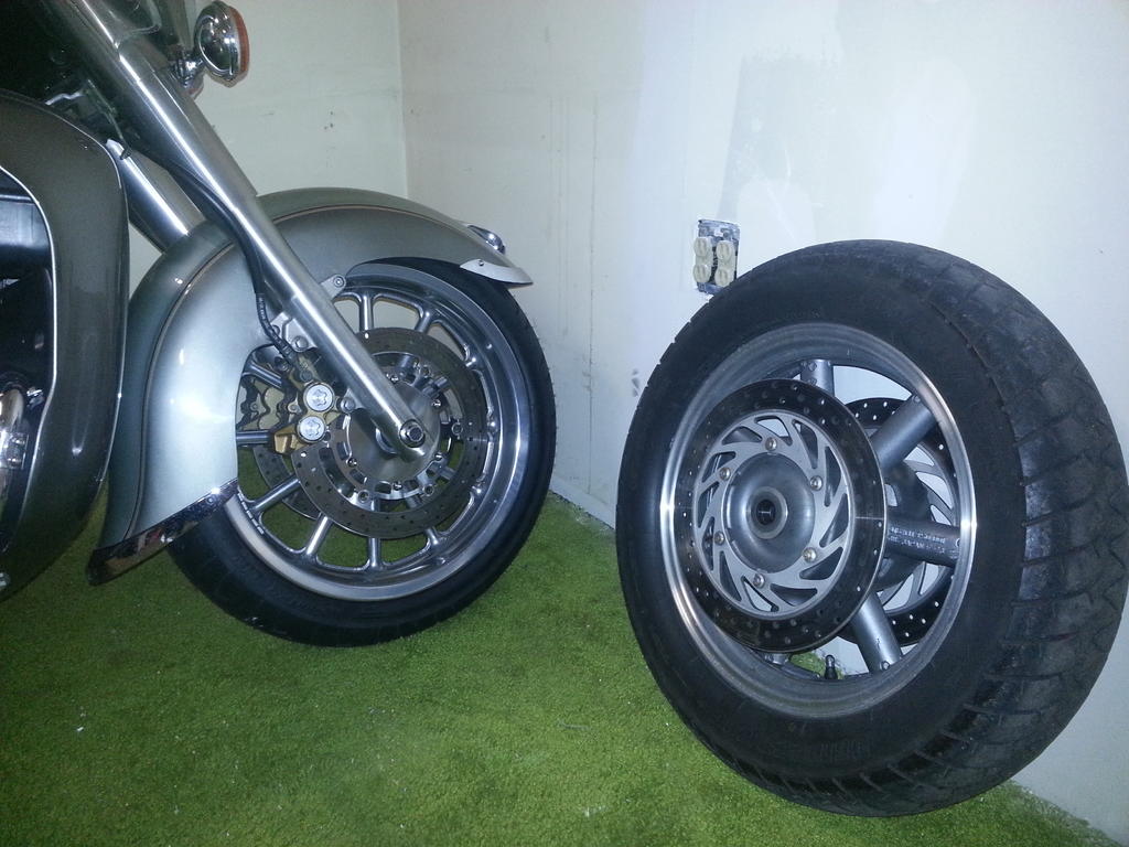

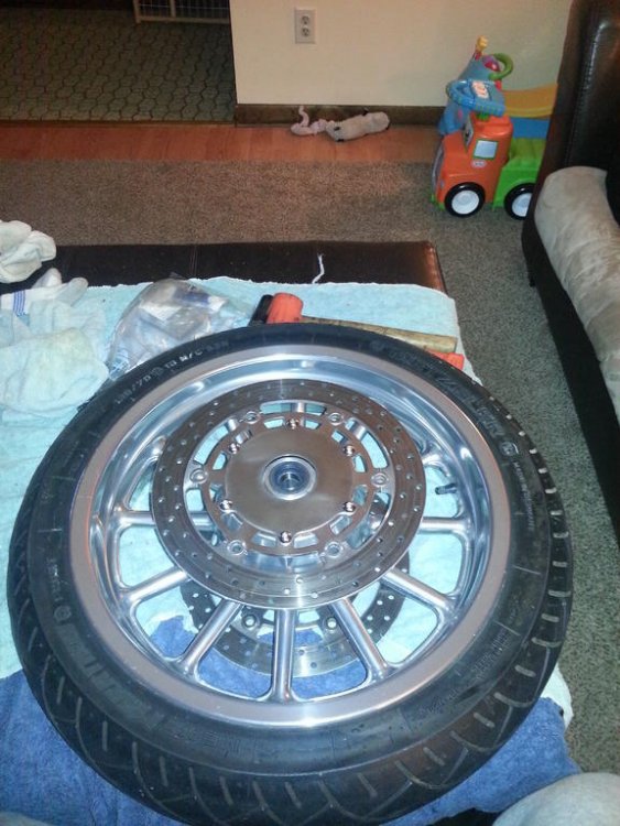

BratmanXj Posted September 26, 2018 #3 Posted September 26, 2018 The 18" 1900cc Stratoliner wheel is a direct swap with a 130/70-18 tire that helps lighten up the steering on these big bikes. The Stratoliner has a cast wheel while the S model has chrome. The floating rotors and 4 piston calipers are a direct swap as well. Rear is a tough one because of the shaft drive.
