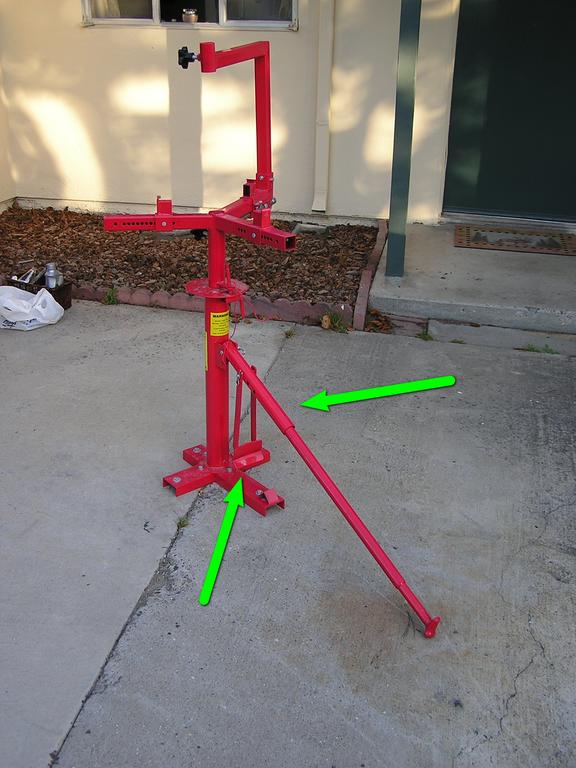

Bob K. Posted September 23, 2018 Share #5 Posted September 23, 2018 (edited) HF used to have a tool for this but it's no longer available... What manual tire changer do you have? My Harbor Freight tire changer has a built in bead breaker. I put a couple 2x4s underneath the wheel to raise it up a bit and to protect the rotor. It works great. $80 gets you the tire changer and the motorcycle wheel adapter: https://www.harborfreight.com/catalogsearch/result/index/?dir=asc&order=EAScore%2Cf%2CEAFeatured+Weight%2Cf%2CSale+Rank%2Cf&q=changer Or, you can buy a separate bead breaker for $50: https://www.harborfreight.com/bead-breaker-92961.html Edited September 23, 2018 by Bob K. Link to comment Share on other sites More sharing options...
dna9656 Posted September 23, 2018 Author Share #6 Posted September 23, 2018 (edited) What manual tire changer do you have? My Harbor Freight tire changer has a built in bead breaker. I put a couple 2x4s underneath the wheel to raise it up a bit and to protect the rotor. It works great. $80 gets you the tire changer and the motorcycle wheel adapter: https://www.harborfreight.com/catalogsearch/result/index/?dir=asc&order=EAScore%2Cf%2CEAFeatured+Weight%2Cf%2CSale+Rank%2Cf&q=changer Or, you can buy a separate bead breaker for $50: https://www.harborfreight.com/bead-breaker-92961.html https://www.venturerider.org/forum/attachment.php?attachmentid=114539 I do not have a changer, I used but it got lost somehow. Now, that I have ordered this one (https://www.amazon.com/gp/product/B004MS9264/ref=od_aui_detailpages00?ie=UTF8&psc=1) my old changer will show up. I never used it....It was a cheapie... Note that unlike the cheaper version of this that the "legs between the circles bolted in place these are welded and it has welded tabs to bolt the thing down to a pallet or other foundation...It costs a few $ more than the one that has the steel "legs" that bolt in place (it looks like it might collapse) and it has no tabs to secure it in place. PLUS it's smaller that HF's set up. I can easily store it in garden shed and not in my shop! The local HF has an open box special on the M/C attachment ($15.00) that's missing the bar that goes through the center of the wheel, just as well because that bar is too big (could buy a iron pipe I suppose) for my bike anyway Edited September 25, 2018 by dna9656 Link to comment Share on other sites More sharing options...

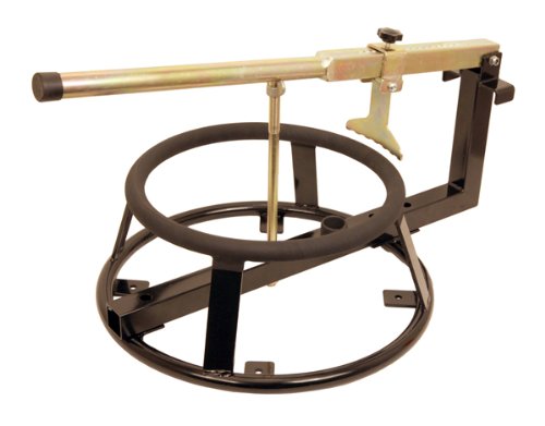

greg_in_london Posted October 1, 2018 Share #8 Posted October 1, 2018 Just do a search on Ebay for one you like the look of. I bought mine a few years - mainly for emergencies because the place I go to for tyres has reasonable prices and tools for you to remove them yourself. They charge for balancing, but not fitting. Anyway, the one I bought looks a bit like this and was just as cheap: https://pulsar.ebay.co.uk/plsr/clk/0/SADS/9?pld=%7B%22mecs%22%3A%222024166249796d2a181e3e894f63be56b8409604dfd0%22%2C%22enc%22%3A%22AQADAAACsBkojIFHYtWT%2BANpG6F7t2F09Z9Cbsu1X59rcQ4wVNT6A2C4dotaid1BlSqpY2v6yePzhOYc7cgk4BD5PFWI2SIa4CTkRla8x7l4lNmgi9HQgwzYslxWcGPRbQ2wQaEgSLYHzFwTCXM8sFctn9DhcQOug5w7DX8QWkAtkT%2FRbE%2Fpu4bLyDg27eMQSLwlO2PtSKDjbyhWYO4TE6gi4XGAWenRYkULG5LqwjQckEUf6rTN9t%2FT5FuA5tGW57klb6eZj0icNV0XCeim3bmt4goPx%2Bq8a46wBhNXkyRJvJeeM9pRFrSgHGpnq4qDo6wqDjB7P3gHNHMtpiN8Q%2BDiZvlex8KbJ3xQz1On46lIuOF2z%2F3ULmxa%2BSnBxEu5mceSXa1zpe%2B9sW8IRw8PlXRHUYI%2BBe2J2wqZN3TeHVwT23Bmor0ATww1ZHevLpJIGp25EcSuJ%2FZTcn7Et4%2BDXqN3w9DWOhlU6T%2B0OBhQdMwc5bf4BNKkpZtXnItH44ReN8DV6hspajsxDn0SL2vy5Eat5yegKE6g6poIuLKiR8CTNvNIcAgQqTw2WsQhg%2FEMUlHM5UiLesZysfvkHziU2%2F%2F9u2N0Zw40azDruEEgU8WOWVlAyVfd%2ByiB3NgNQnlPtA23QlGpzoBZIukKviDXNQ2AlZfA8IBsv6vwftd33zC3gGmr4LKhq0V%2F%2BfN6C3kwl%2BHQDhOcunye6WQaykaorzxjevDnh95EpcL7a1ZDGgksRrPk3bFXY1IyjVRqOb3DZXVsxRfnY14QB1vNjFbx4cuEAeymLgpb70hF2abO3Op6TuroeRlUm9Fttdkcuwo73eeek8Akat05Bk1Gu5E2y0hbg0YY6q9Bg4ZWb6ugzKN%2BNlp9uS%2FU8bsHzHMbstyRHpUJCNXc4c0%2Fn0SUThuadtjzKvuSZkE%3D%22%7D Link to comment Share on other sites More sharing options...
dna9656 Posted October 1, 2018 Author Share #9 Posted October 1, 2018 Just do a search on Ebay for one you like the look of. I bought mine a few years - mainly for emergencies because the place I go to for tyres has reasonable prices and tools for you to remove them yourself. They charge for balancing, but not fitting. Anyway, the one I bought looks a bit like this and was just as cheap: https://pulsar.ebay.co.uk/plsr/clk/0/SADS/9?pld=%7B%22mecs%22%3A%222024166249796d2a181e3e894f63be56b8409604dfd0%22%2C%22enc%22%3A%22AQADAAACsBkojIFHYtWT%2BANpG6F7t2F09Z9Cbsu1X59rcQ4wVNT6A2C4dotaid1BlSqpY2v6yePzhOYc7cgk4BD5PFWI2SIa4CTkRla8x7l4lNmgi9HQgwzYslxWcGPRbQ2wQaEgSLYHzFwTCXM8sFctn9DhcQOug5w7DX8QWkAtkT%2FRbE%2Fpu4bLyDg27eMQSLwlO2PtSKDjbyhWYO4TE6gi4XGAWenRYkULG5LqwjQckEUf6rTN9t%2FT5FuA5tGW57klb6eZj0icNV0XCeim3bmt4goPx%2Bq8a46wBhNXkyRJvJeeM9pRFrSgHGpnq4qDo6wqDjB7P3gHNHMtpiN8Q%2BDiZvlex8KbJ3xQz1On46lIuOF2z%2F3ULmxa%2BSnBxEu5mceSXa1zpe%2B9sW8IRw8PlXRHUYI%2BBe2J2wqZN3TeHVwT23Bmor0ATww1ZHevLpJIGp25EcSuJ%2FZTcn7Et4%2BDXqN3w9DWOhlU6T%2B0OBhQdMwc5bf4BNKkpZtXnItH44ReN8DV6hspajsxDn0SL2vy5Eat5yegKE6g6poIuLKiR8CTNvNIcAgQqTw2WsQhg%2FEMUlHM5UiLesZysfvkHziU2%2F%2F9u2N0Zw40azDruEEgU8WOWVlAyVfd%2ByiB3NgNQnlPtA23QlGpzoBZIukKviDXNQ2AlZfA8IBsv6vwftd33zC3gGmr4LKhq0V%2F%2BfN6C3kwl%2BHQDhOcunye6WQaykaorzxjevDnh95EpcL7a1ZDGgksRrPk3bFXY1IyjVRqOb3DZXVsxRfnY14QB1vNjFbx4cuEAeymLgpb70hF2abO3Op6TuroeRlUm9Fttdkcuwo73eeek8Akat05Bk1Gu5E2y0hbg0YY6q9Bg4ZWb6ugzKN%2BNlp9uS%2FU8bsHzHMbstyRHpUJCNXc4c0%2Fn0SUThuadtjzKvuSZkE%3D%22%7D I bought the one in my previous post (above) and rec'd it this past Friday, It works! I may get the smaller rim mounted tool for road trips; I will not go on a road trip with tires that might need changing during the trip but if I should need tires I'll have that smaller tool and a couple of tire irons and save a night's lodging fee by changing my own tires! Link to comment Share on other sites More sharing options...

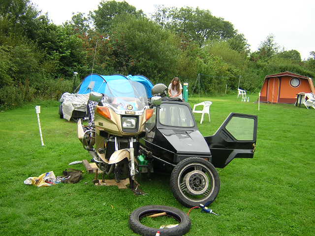

greg_in_london Posted November 19, 2018 Share #12 Posted November 19, 2018 I would not argue with anybody that says getting the wheel out while on the road is a PITA with these bikes. I once had completely unexpected levels of tyre wear, even though I began with a brand new back tyre. I actually changed the front tyre on a camp site in Scotland and the back tyre outside the in-laws house in Ireland. I'm sure most people know this, but in case anyone is looking at this on the phone while stuck at the side of the road, the key is to put planks down and put the centre on top of those (or over the edge of a kerb). The bike is much too heavy to do that unless you FIRST roll the back wheel onto something - with the tyre pumped up (even if it goes down again in two minutes - that should be long enough to get it up on the stand. Better to spend a half hour looking for planks, branches, bricks etc than weeks off work after hurting your back. Link to comment Share on other sites More sharing options...
