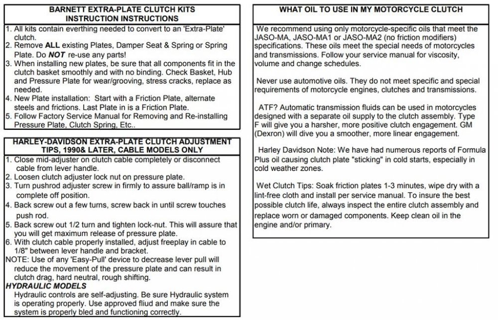

saddlebum Posted January 21, 2019 #28 Posted January 21, 2019 just food for thought but when I installed the carbon fiber clutch in my there was a warning not to be used with Harley Davidson type oils.
Du-Rron Posted January 21, 2019 Author #29 Posted January 21, 2019 (edited) just food for thought but when I installed the carbon fiber clutch in my there was a warning not to be used with Harley Davidson type oils. Installed the clutch in your what?...Harley? This is a different conversation. However, they were telling you to use a JASO oil, like Quicksilver. DO NOT use the formula plus Harley oil. Anyways, this a different topic altogether and vague statements only serve to muddy the water. Edited January 21, 2019 by Du-Rron
