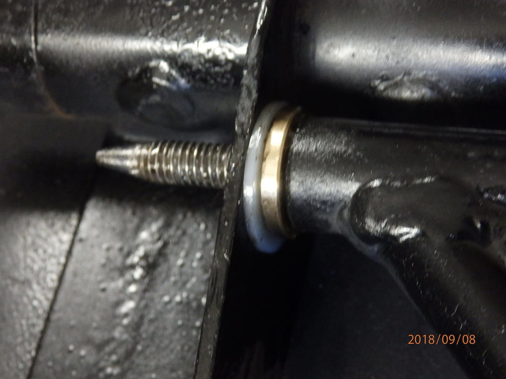

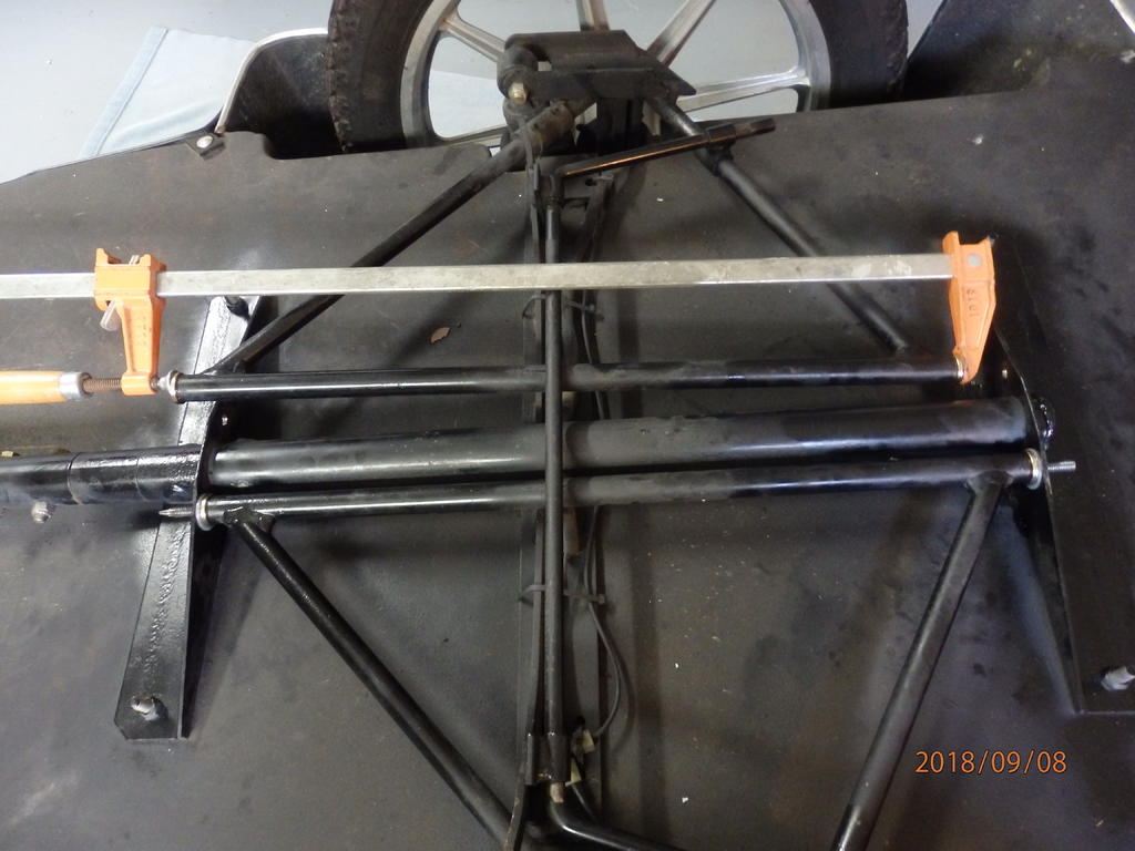

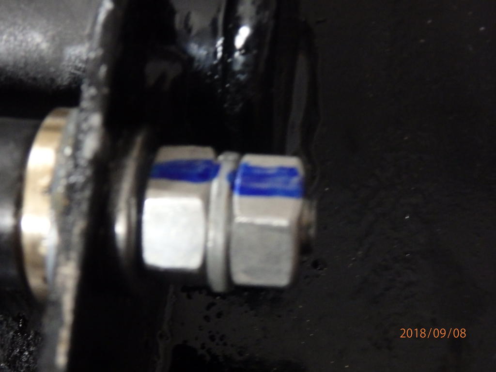

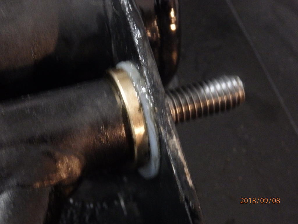

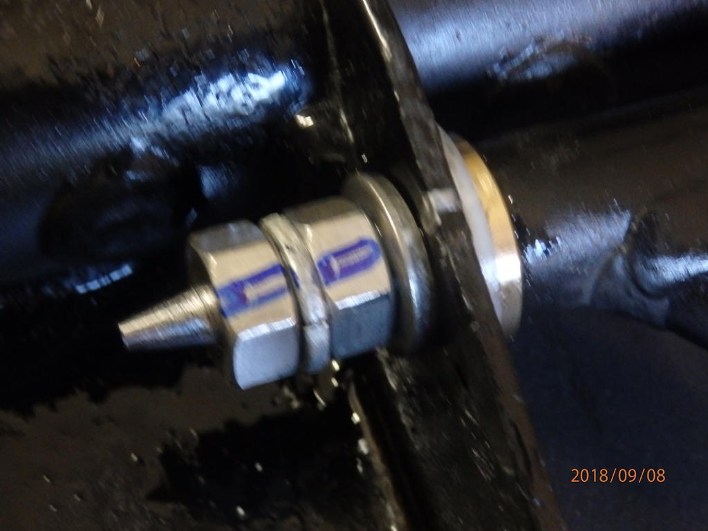

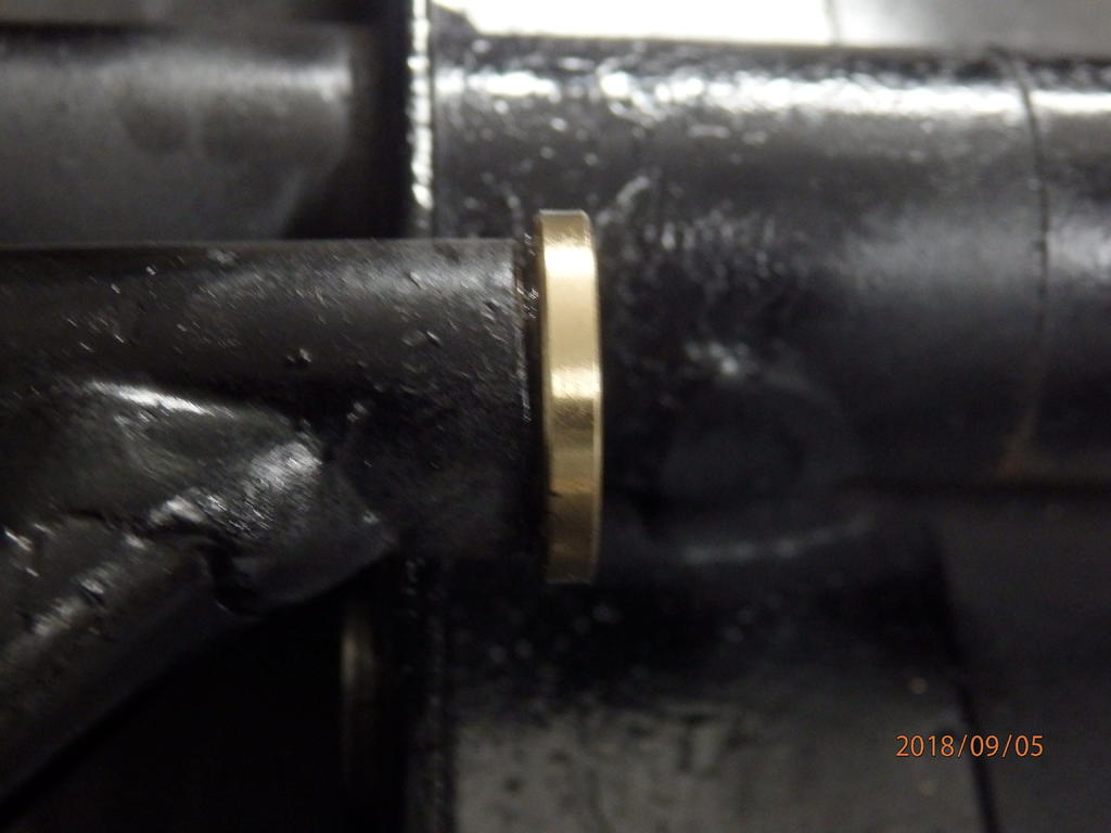

M61A1MECH Posted September 9, 2018 Author #26 Posted September 9, 2018 Well the repair/re-build is complete, took it out for about 60 mile ride, over rough roads and high speed interstate, so far no issues and the jam nuts are staying put, will monitor those on upcoming trips and keep a set of spares with me just in case. Pics of completed assembly are below, once I have enough miles on this set up to be confident, I will publish a short on how I did it. If I had to do it again, I would order or make the chassis rods at least 1/2" longer (1.5" over stock length) just to get a few more threads. Nuts are Loktited to the chassis rod and there is a heavy split lock washer between the two nuts, just enough room between the frame member and A-Arm bushings to allow the nylon spacer room to rotate but not move fore and aft ,also not so tight that it is jammed up, still allows allow the A-Arm bushing to rotate on the chassis rod.
djh3 Posted September 11, 2018 #27 Posted September 11, 2018 Steve you can get "half height" nuts and double nut to nut lock it and skip the washer. http://www.pro-werks.com/partlist/998
M61A1MECH Posted September 11, 2018 Author #28 Posted September 11, 2018 Steve you can get "half height" nuts and double nut to nut lock it and skip the washer. http://www.pro-werks.com/partlist/998 Yes I know, I looked at that style when selecting hardware, but wanted the extra strength afforded by the heavy SS nuts and added thread engagement for the Loktite, Nylocks are fine, but by they are intended for one time use, lock washers can be used over and over if needed. Yes I have reused nylocks, but I have also seen them not hold on repeat use, and I am expecting that chassis rod to see a good bit of vibration from the road surface, and thought the heavy nuts, Loktite and lock washers afforded be the best opportunity for long term success, time will tell, I will be carrying an extra set of nuts , including some nylocks, with me when pulling the trailer, just incase I need to make a repair on the road. I did try drilling one of the spare nuts I had hoping I could lockwire them for added security, but I do not have anything that will drill 316SS, I may see if I can find some predrilled 5/16-18 nuts, maybe Aircraft Spruce has some.
djh3 Posted September 11, 2018 #29 Posted September 11, 2018 I doubt you will have to make anymore repairs. Looks to me that it is now built like it should have to start.
