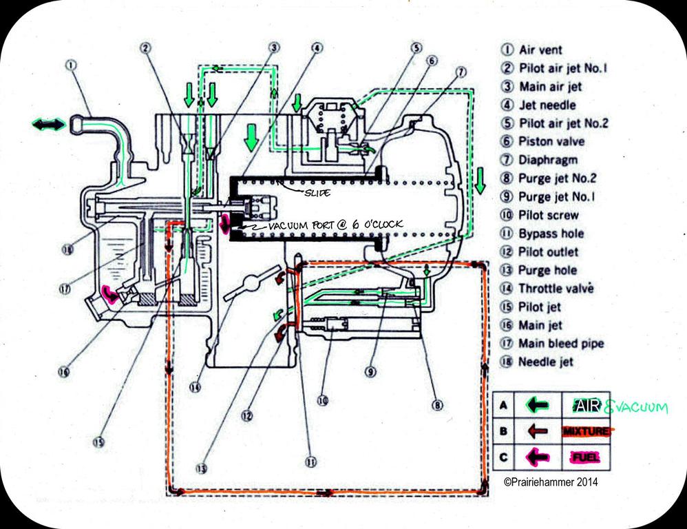

I was wondering if in on these screws makes the mix richer.
I gather that they control air? And if I do then in would restrict the air more making the mix more rich?
Do I have that correct or am I way off?
Thanks
Not exactly the same as a fuel screw but behaves the same. Out = richer.

I've seen a nice carb "flow" diagram here before, but I guess I'm not good at searching as I can't find it again!!
Thanks MiCarl.
Perhaps this the one? Yes, the pilot screws are turned out to richen.
