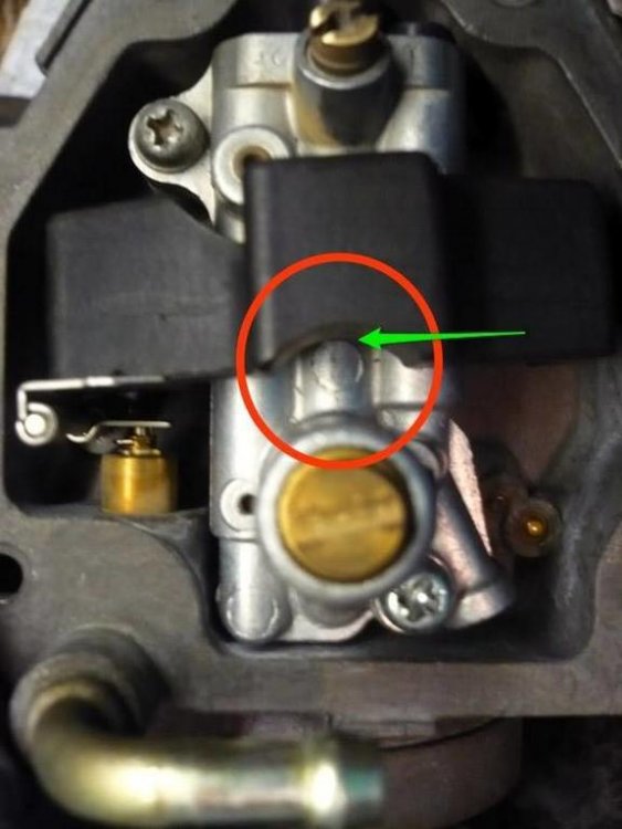

Prairiehammer Posted August 22, 2018 #4 Posted August 22, 2018 I really don't think it would make a whole hill of beans difference, the fuel pump only puts out 3-4 lbs pressure, so about as much as a gravity system. The way I did my floats, was to hold the carb upside down with the floats installed. As you do that you will notice a casting mark on the jet body and that should line up with the contour of the float, worked every time, never an issue that I noticed, but then maybe I'm not as fussy as some others. Marcarl's method is valid; consider how the factory (either Mikuni or Yamaha) would do the float adjustment. (The factory is certainly not going to do a wet adjustment for every carb.) This pic shows the casting mark (a circle) on the jet block and the correct location of the float in relation to that casting mark.

Venturous Randy Posted August 24, 2018 #7 Posted August 24, 2018 Are you sure that circle has anything to do with setting the float level? I ask this because to me that is just the indication from an ejector pin the pushes the casting out of the die after casting. I would be really surprised that the casting die maker considered the location of the pin for anything other than ejecting the casting without it binding in the die. But, that doesn't mean that it could not be a good reference point if it has historically worked. Randy
Marcarl Posted August 24, 2018 #8 Posted August 24, 2018 Are you sure that circle has anything to do with setting the float level? I ask this because to me that is just the indication from an ejector pin the pushes the casting out of the die after casting. I would be really surprised that the casting die maker considered the location of the pin for anything other than ejecting the casting without it binding in the die. But, that doesn't mean that it could not be a good reference point if it has historically worked. Randy Nope, not sure at all, fact is I think it would be rather strange, but it works, seeing as all the castings are made from the same mold, and hey''''' if it works why not use it.
Bob K. Posted August 24, 2018 Author #9 Posted August 24, 2018 @Venturous Randy--I think it's completely coincidental. The round circle--a mold mark--just happens to be in the same neighborhood of the dry float level measurement that happens to yield a pretty close wet measurement fuel level for a lot of folks.
