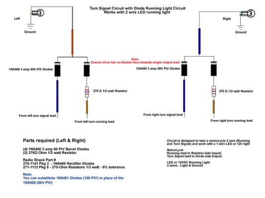

Harddrv1 Posted August 18, 2018 Posted August 18, 2018 (edited) Not sure if this is helpful but I found this diagram for my build it converts a 2 wire led to run in a 3 wire system hope this helps. Do please note that I have not yet tried this just had gathered the information while waiting for my parts, also you note this is a 2 to 1 diagram for 3 to 2 the third wire connects to ground wire of led if that makes sense Edited August 18, 2018 by Harddrv1
Flyinfool Posted August 19, 2018 Posted August 19, 2018 I have run into some cheap LED turn signal bulbs that will not work on all bikes. On the 1st gen when the turn signal in in the off part of the cycle the flasher is providing a ground to the signal wire. this causes all kinds of mayhem and in short (pun intended) makes it just not work. I do not know if the 2nd gen also grounds the signal wire during the off cycle of the flasher. Where this causes an issue is on the front bulbs that are both turn signal and running light. Some cheap bulbs have the 2 separate circuits internally connected, Some bulbs do not. Just something to look for.
