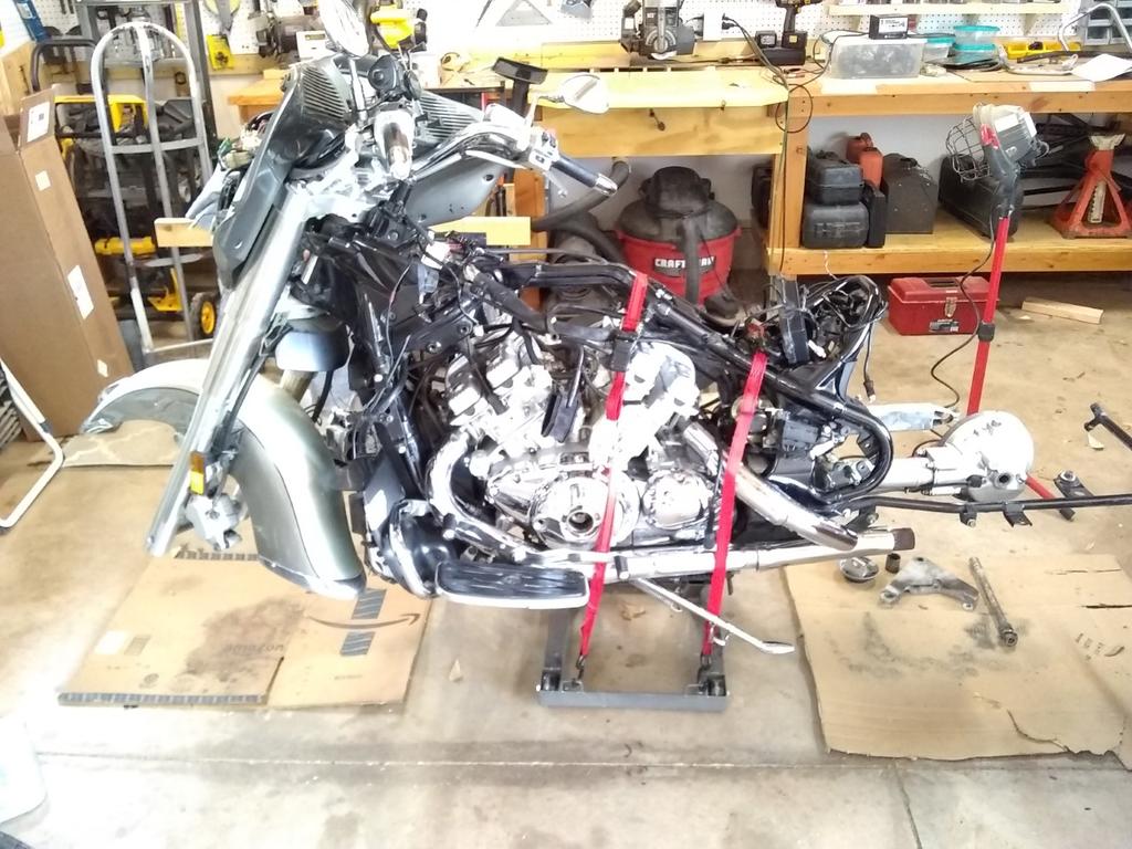

wrscomncents Posted August 9, 2018 Author #75 Posted August 9, 2018 Alright guys I've picked a lot of brains here and gotten a lot of great input. Now its time for me to put it to use. I'm going to pull the bike apart this weekend and see what I can find. Thanks to everyone for all the advise. I'll let you all know what happens when I figure it out. Thanks again.
