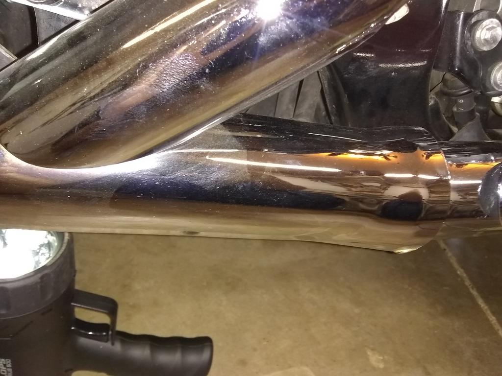

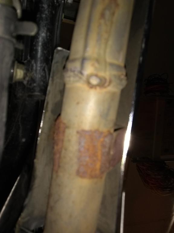

snyper316 Posted August 8, 2018 #30 Posted August 8, 2018 snyper I have changed the exhaust gaskets on both pipes and when I hold a lighter by them I show no signs of a leak. There is a spot where the chrome shield is welded to the pipe that actually blows out the lighter. I have felt that area while the bike is cold and I cannot feel a hole or a crack so not sure how big it is. Its also very hard to see that area. Don't know if that would be enough to cause this backfire.What I had thought exactly. Worth a try to get that area fixed. Can you get a picture of this crome cover your talking about? My gaskets didn't seem that bad either when I replaced them but there is no more back fire. Sent from my LG-M255 using Tapatalk
wrscomncents Posted August 8, 2018 Author #31 Posted August 8, 2018 What I had thought exactly. Worth a try to get that area fixed. Can you get a picture of this crome cover your talking about? My gaskets didn't seem that bad either when I replaced them but there is no more back fire. Sent from my LG-M255 using Tapatalk Yeah I can try to.
wrscomncents Posted August 8, 2018 Author #32 Posted August 8, 2018 Yeah I can try to.T The leak is right in the area where the metal bracket connects from the shield to the pipe but I cannot see it.
Patch Posted August 8, 2018 #33 Posted August 8, 2018 snyper I have changed the exhaust gaskets on both pipes and when I hold a lighter by them I show no signs of a leak. There is a spot where the chrome shield is welded to the pipe that actually blows out the lighter. I have felt that area while the bike is cold and I cannot feel a hole or a crack so not sure how big it is. Its also very hard to see that area. Don't know if that would be enough to cause this backfire. If you take this root and the backfiring stops, has the problem been addressed? Certainly fix the exhaust leak but the source of fuel leak should be dealt with as well. Is there any chance you can measure the pipe temperature at the exhaust port at the rpm when it usually goes off? You mentioned earlier that you could almost time it I think?
