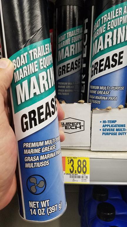

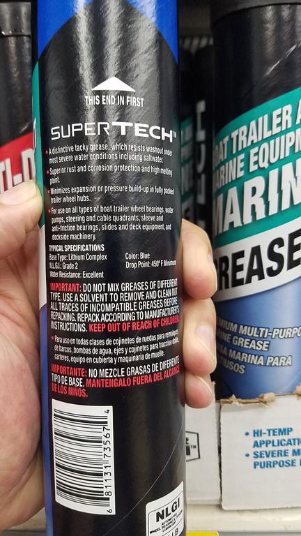

videoarizona Posted July 27, 2018 Posted July 27, 2018 I gather that all oils made today are very good...but my issue with Penzoil was in the late 80's. I thought it was a good oil and I used it exclusively in my Van from mile #1 . Well..the 318 heads showed it was crap. Ah well....it doesn't surprise me. I still like Yamalube 20-50 dino oil. Seems to make both of my Ventures run well. The VStar 950T ran it too, and it was a peppy, fuel efficient little motor! 11K miles and still ran like it was brand new. Just wish it wasn't so expensive. The RSV ran very well despite the wind on Rotella T6 on this last cross country trip. Shifted well despite the heat. But a bit more noise from the engine/transmission on the T6 than on Dino. Next, I'll try Mobile 1 and then WalMarts house brand of synthetic in 20-50. Speaking of oils and grease...small hijack here: During another WallyWalk....found my favorite trailer bearing grease. Decided to read the label. Whoa. No wonder it's been great for all the times I've drowned the wheels and it just works! A grade 2 lithium complex grease! It really does stick despite the heat we have here...I've trailered my boat across the desert to San Diego and Marina Del Ray in LA, in 110 degree heat and bearings stayed at ambient temp. I've been really happy with this stuff. I'm going to get some additional tubes for use in the rear end and wheel bearings of both scoots. I bet it will be good stuff there too!
