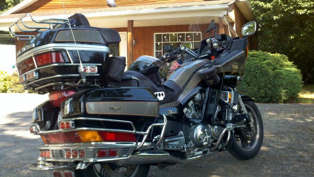

rstacy Posted July 26, 2018 Posted July 26, 2018 So the time has come to sell my 86. She has been and still is a great bike. I just don't need 2. I have two problems that I need to repair first. At the beginning of the season I found that my rear brakes were gone. The pedal goes to the stop with no resistance. I bled the brakes and have found that if I pump the pedal I can get some stopping action. Do I need to bleed again or has the master cylinder failed? I did the clutch mod on this bike where you add the additional plate. I have not liked the feel of the clutch since doing the mod. I will probably restore that factory condition.
