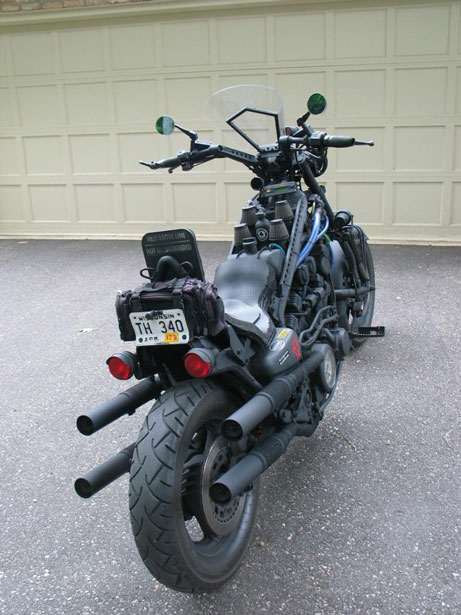

Loy Posted July 30, 2018 Author #12 Posted July 30, 2018 (edited) https://www.venturerider.org/forum/attachment.php?attachmentid=113822 EDIT: For some reason I can't quote your Pic. oh well. Waaait a sec... Zag, I recognize that bike from the web. The Chain on the headlight and black bars are a dead giveaway, lol. In fact, I may be taking a little bit of inspiration here and there from your build... Quick Question For you. This one Is WAY down the line in the build (further than the Speedo), but.. Are your Rear exhaust head pipes a custom fabrication, Or a find from another bike that fit? I've been looking at '96 Royal Star Heads, thinking there may be a way to fit them how I want with a little extra "encouraging" or something. But as the guy who has proof of quad exhaust being viable is here for me to ask... Edited July 30, 2018 by Loy
zagger Posted July 31, 2018 #13 Posted July 31, 2018 EDIT: For some reason I can't quote your Pic. oh well. Waaait a sec... Zag, I recognize that bike from the web. The Chain on the headlight and black bars are a dead giveaway, lol. In fact, I may be taking a little bit of inspiration here and there from your build... Quick Question For you. This one Is WAY down the line in the build (further than the Speedo), but.. Are your Rear exhaust head pipes a custom fabrication, Or a find from another bike that fit? I've been looking at '96 Royal Star Heads, thinking there may be a way to fit them how I want with a little extra "encouraging" or something. But as the guy who has proof of quad exhaust being viable is here for me to ask... Hey Loy, The first section of pipes from the engine were stock (mostly to keep the curve around the engine), but they were then cut and new pipes added. Everything downstream was custom built. But I had to find baffles that fit, so I made my final pipes to match. The baffles cut down on the sound somewhat, but I added a couple of big washers clamped onto a crossbar inside the baffles. They help with the sound but are really there to set the backpressure which is vital for the carb operation. zag
zagger Posted July 31, 2018 #14 Posted July 31, 2018 (edited) Chain on the headlight Just so ya know, I was at some bike thing and someone noticed that I didn't have any Harley parts included. So I ripped off the headlight bracket that I had made, and welded up a new headlight thing using a panhead Harley primary chain. Just for the esthetics. Nothing beats the idiocy of a primary chain. zag Edited July 31, 2018 by zagger
