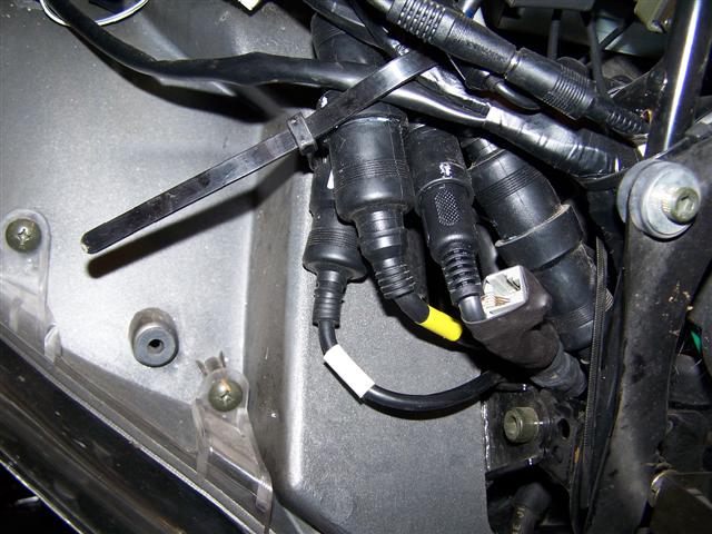

sanderjack Posted July 23, 2018 Posted July 23, 2018 I have a friend whose 2nd Gen stereo is stuck on CASS. CB will not come on and mode button does not change anything. Volume works great but she is getting tired of listening to the same cassette (or having to change cassettes). Tried to reset it to the point of disconnecting the battery. When the key is on, the display has CASS and you cannot change it. Both seats are off and cannot find any broken wires. Have not pulled the front fairing...YET. Any suggestions?
Freebird Posted July 23, 2018 Posted July 23, 2018 Unfortunately, you are going to need to pull the front fairing to further check it. There are five black cables inside the fairing. There have been many know instances where they need to be unplugged, possibly cleaned, and reconnected to remedy various stereo issues. Here is a picture of what you are looking for inside the fairing.
