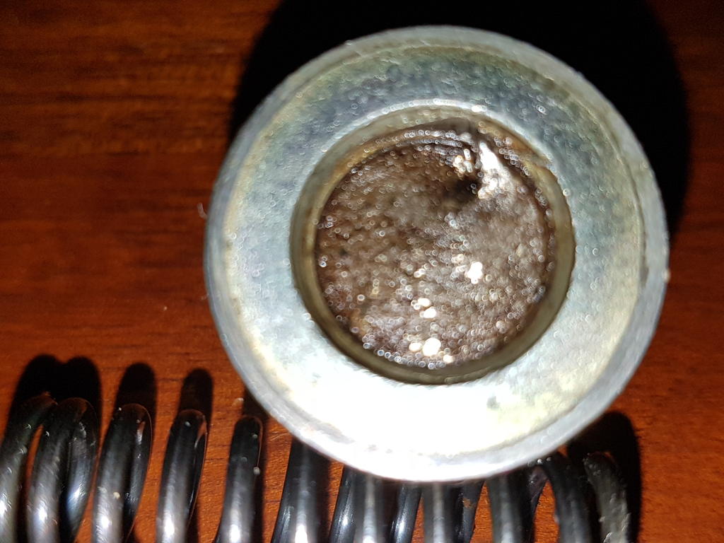

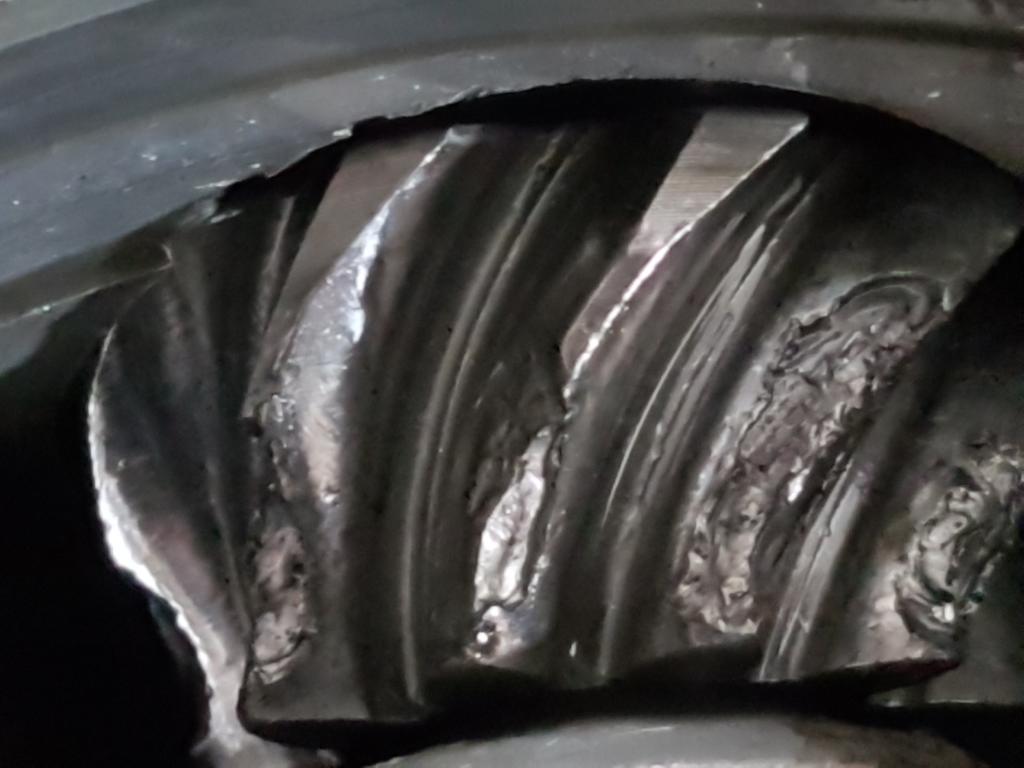

Patch Posted August 5, 2018 #6 Posted August 5, 2018 .45Cole said: Update- I pulled the air module off the console and pulled it apart following the tech write up to get to the board. Didn't really look like I had a problem with any, but two looked a little suspicious. Soldered them (horrible job, figured I burned the board and for sure messed it it) plugged everything back together and IT WORKED PERFECTLY! +1 on being a venturerider member! I'll get used to the neutral switch start (can't start in gear) and the jiffy stand engine cut (in gear drop jiffy stand and bike engine cuts out). This one seems confusing. Stand in up position, in gear, clutch in switches on, bike should start! Stand down in gear the bike should not start, this would be correct!i Is this the case? I'm about 80% sure the gear whining in from a broken nut on the pinion. I don't think it's a problem if I'm careful until the new rear end shows up. This is very dangerous, I would not recommend driving the bike. The final drive can and eventually will lock up and you will be thrown. My pinion gear, I was very lucky to make it back from my trip.
