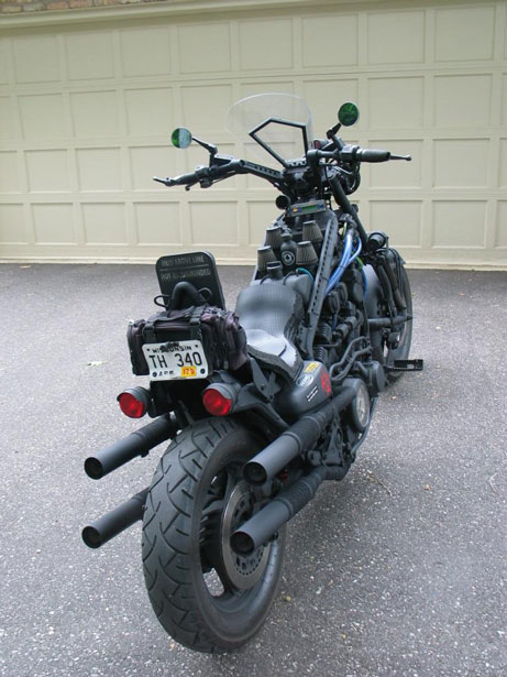

zagger Posted July 12, 2018 #5 Posted July 12, 2018 Ok, got an idea. That could be trouble. We all know that cold air intakes make more HP that a stock intake, so with that in mind, I have a thought about using the air vent in fairing, with some ducting, to create a forced cold air intake back to air filter box. I know, I know, it's a big azz full dresser, but what the hell. More ponies are always good, especially on the cheap. Any thoughts???? Hey Jimbo, I put individual pod filters on each intake and removed the stock filter box. The pod filters had a low pressure drop and I was forced to put machined restrictors under each one (basically a big washer with a machined hole) to get the airflow correct. The bike totally rips and is running right at the correct fuel/air mix. I did temporarily install a fuel/air sensor in one pipe to see what was going on. Once everything was sorted out, I took off the sensor and gauge. zag
JimboSlice Posted July 13, 2018 Author #6 Posted July 13, 2018 Hey Zagger. That bike is radical. I can't believe that's a Venture. I'm not looking to go anywhere close to that. Actually after reading all the feedback here, I've decided to leave well enuff alone. This bike is plenty powerful for touring, even with a full load. I prob should have carbs tuned though. Just not sure how to. Yeah I'm one of those. I do all my own mechanic work, if I can. Why pay someone else to screw it up when I can screw it up for free. . To be honest there just isn't any real good bike mechanics around here, except for the Orange county chopper guys. I basically want to keep the bike stock anyway. I'll do some electronic mods, but this bike is in good shape. What's that ole saying. "If it ain't broke don't fix it." I wanted to change the fork oil last weekend but that allen nut is huge. I have to find the key some place. Thanx again Dawson. Appreciate the concern. I am def heeding the warning. I did want to know, what is the average fuel mileage on these bikes? I'm getting around 36 mpg
