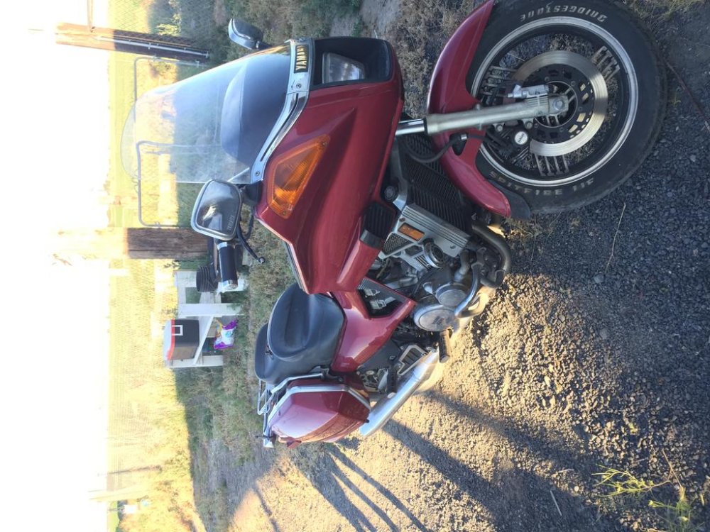

poorwhiteboy Posted July 1, 2018 #1  Posted July 1, 2018 My father in law just GAVE me his old venture😄 I was pretty leery of taking it at first because it had been sitting for 7 years till now... After I got it home and cleaned up a bit(mostly the carbs) it pretty cool and really fun! But let me tell you what, those carbs are something else!! It had sat the whole time with fuel in it so it took some heavy cleaning to get it to run decent. It's not runnin perfect yet but it's loads better than it was. Hopefully some gum out will clean them up the rest of the way and prevent me from pulling the whole set of carbs out! Any tips on carburetor cleaning/removal will be appreciated.. Any ways, here she is.
