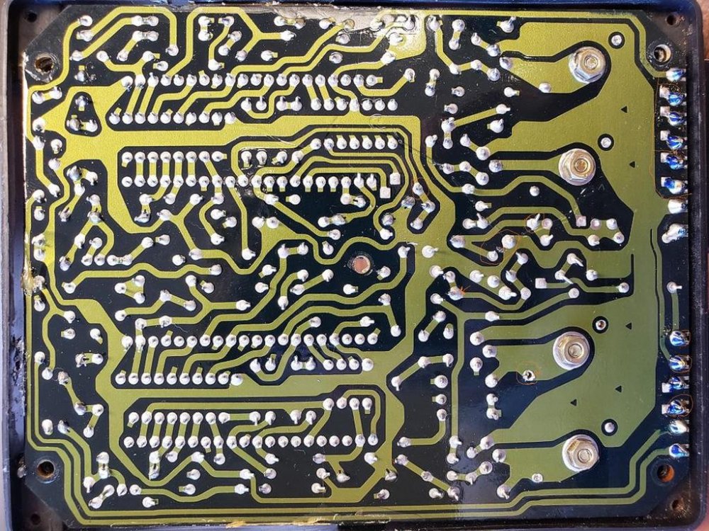

oldfaithful Posted June 29, 2018 Author #21 Posted June 29, 2018 Well today I pulled the kickstand switch and checked it. Is anyone still buying the Ignitech units for these bikes. I found several old threads about group buys, but nothing recent. If I've got to get a replacement, that sounds like a good option to me. I sent Ignitech an email and we'll see what they say tomorrow. So has anyone purchased the Ignitech units lately? I'm going to buy one today because I haven't found a replacement TCI. dingy do you have an ignition program that is any better than the program that will be provided by Ignitech? Thanks!

bongobobny Posted June 29, 2018 #24 Posted June 29, 2018 So has anyone purchased the Ignitech units lately? I'm going to buy one today because I haven't found a replacement TCI. dingy do you have an ignition program that is any better than the program that will be provided by Ignitech? Thanks!Dingy doesn't live here anymore. You could try the VMax forums and see if he is still active there... Have you checked your timing coils yet? There is a connector about halfway up the rear of the frame that has been known to cause problems. Also, the coils have been known to cause issues, especially when they warm up. When you had your TCI out did you bake it in the oven at 200 to 250 degrees to bake out any moisture?? Also, you need to relocate your TCI to the top of the airbox, there is enough play in the wiring harness to do this. This has two advantages, first it is drier up there, and second, in case of failure, it is right where you can get to it easily. I seem to remember a while back somebody found a manufacturer that made replacement TCI boxes that even had the same shape...
